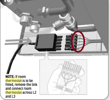

I'm wiring a hive system against the above boiler and misunderstood the instructions for the boiler:
Instead of the plug on the left, I wired my thermostat into L2 and L3 on the right (circled in red). This didn't work as I had no power in the Hive Receiver. I appreciate that this is not what the diagram above is suggesting but should it have worked?

ok. If I've interpreted that correctly, I will need a 5 core flex where I will connect to L2, L3, L, N and Earth on the boiler (black plug above) and then connect the following in the receiver: 2, 3, L, N and Earth.
My confusion was caused by the a I've pic that only talks about L2 and L3.
