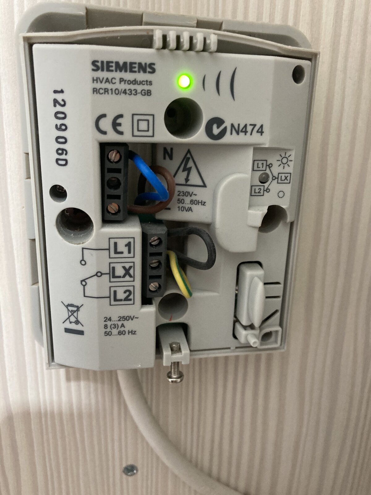

Hi all,
Looking for help to install my Hive active heating for use with my Ideal Combi boiler. Can you guys help me determine which wires should go where for the Hive? Picture attached of the current wiring.
Brown to L
Blue to N
Black to 1
Green/Yellow to 3
You should, strictly speaking, sleeve the G/Y and Black with brown or otherwise indicate it is being used as a live conductor.
Although it is pretty obvious from looking at them.
Thanks very much for your quick reply and advice! Much appreciated
I know with Nest if you use the power from the heat link to power the thermostat it needs an earth wire, not a clue why it says you need one, I see Hive has an earth terminal, regulations say "A circuit protective conductor shall be run to and terminated at each point in wiring and at each accessory except a
lamp holder having no exposed-conductive-parts and suspended from such a point." so even if not used there should be an earth. So very likely it is simply to comply with regulations and not required, however if an EICR is done they could fault it with not earth, only really a problem with a rented house.
However you do need at least to over sleeve the yellow/green, seem to remember volt free wires should be white, so would cover with white tape.
