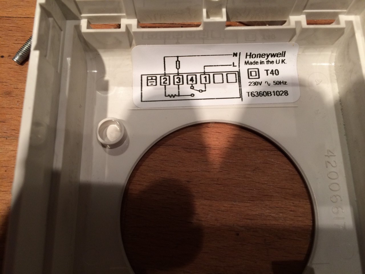

So I'm replacing my Honeywell T40 thermostat with a wireless Salus (RT310RF) version, but I just want to make sure I'm getting the wiring right.

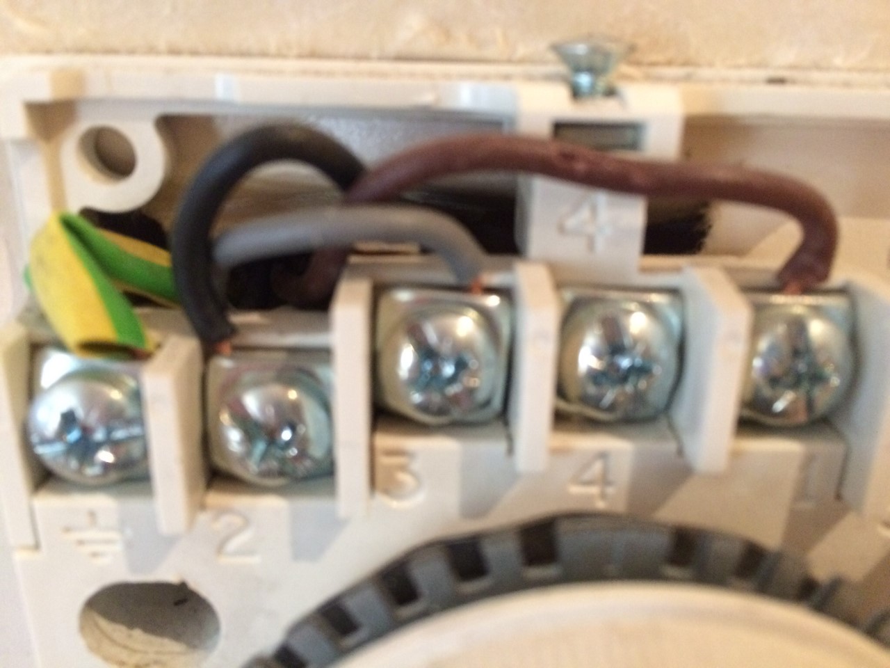

The existing wiring for the Honeywell is;
with the current wiring as below;

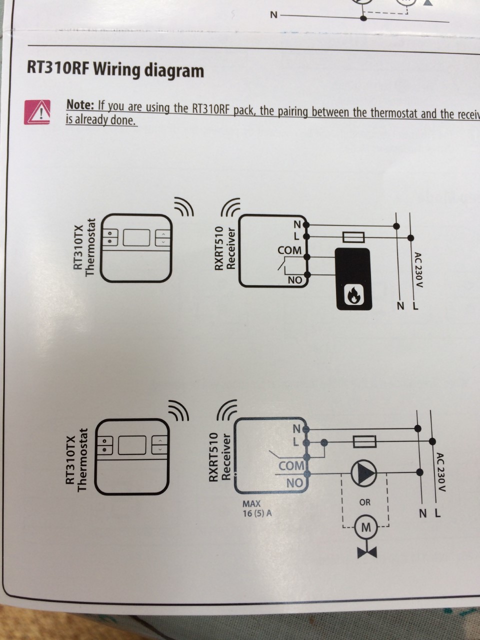

The wiring diagram for the Salus is as below;
So I'm just wondering how I would wire the Salus up, with the wires I have?
I have it in my head that on the Salus;
Black = N
Brown = L
Grey = NO
+ link from COM to L
Does this sound correct?
Many thanks
Sounds good to me.
