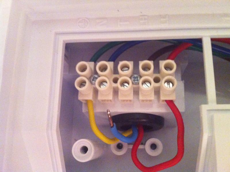

I recently purchased a bathroom extractor fan, an Expelair DX200 and have some queries about wiring it correctly. I have mounted it to the ceiling but as I have old wiring c.1980 I'm unsure which wires I should use.
Currently when wired the unit is on continuously and should switch off when I turn the light off.

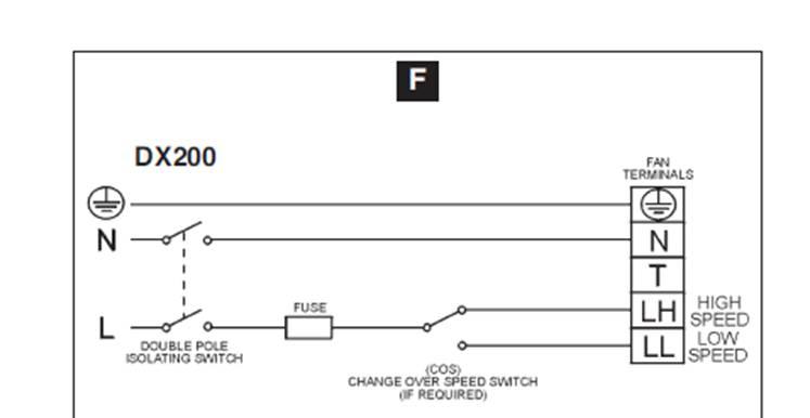

Below is the wiring diagram from the unit instruction manual and a photograph of my wiring (red blue and yellow wires are from the home circuit) so it would be great if someone was able to advise on this.
Some more detail on the unit, you can view this online here http://www.tlc-direct.co.uk/Technical/DataSheets/Xpelair/XPPDX200_PDX200T.PDF

You need to find which cable is serving which function.
So confirmation of
*permanent live
*switched live
*neutral
* and earth/CPC :!:
are required.

You may have made a very dangerous connection which will make the fan dangerous even lethal to touch.
The YELLOW wire is most probably the switched LIVE and is live when the lights are ON .... this should go to the terminal where you have put the red wire which is PERMANENTLY LIVE.
This fan requires an Earth, that will be a bare copper wire ( possibly with loose green/yellow sleeving ) in the gray sheath surrounding the red blue and yellow wires.
If there is no earth you cannot use this fan.

This is a replacement installation (the old unit was a less powerful version) and the blue red and yellow wires are the only three wires that come of of the ceiling. As the wiring is old, if the yellow should go where the red wire currently is, where should the red and blue wires go?
Or should I just give up and fork out for an electrician?
ASSUMING it was previously wired correctly then
The yellow ( switched live ) goes to LH or LL depending on the speed you require the fan to run at.
The blue ( neutral ) goes to N
The red ( permanent live ) is not used and must be terminated in a terminal block with no other connection to it.
I repeat that this fan must NOT be used without an effective earth connection as is stated in the manufacturer's installation instructions.
You need to get to the end of the cable to find out if there is a effective earth ( CPC ) in the cable.

There will be a CPC (earth) in the cable but an idiot may have cut it off.
If this is the case it would be acceptable to sleeve with green&yellow and rewire the yellow but as you have said don't know what you are doing perhaps an electrician would be wiser.
