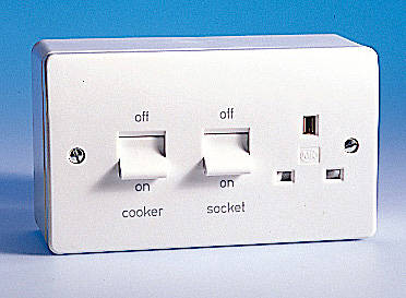

:roll: Hi all.. iam installing a sep electric oven and gas hob.now my cooker switch has a spur out to a 4 way socket extention.
Do you mean that you have something similar to this:
and then from there someone has run a spur supplying another 4 sockets?

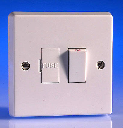

the hob is wired to a sep 13amp rated switch
Do you mean an FCU, similar to this?
If so, where does the supply for that come from? If not, what do you mean?

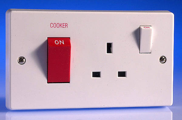

:roll: My oven is rated at 2.18Kw and they say min able is to be 2.5mm.my cooker control unit a 45AMP rated switched with a socket (switched) the first pic in the reply from ban-all-sheds...this goes to the 4 way block ..theres a 45AMP single switched this i think comes direct from fuse box,it then feeds the cooker switch and comming out of this cooker swith is the spur to 4 way..also comming out of cooker switch is a spur to the hob...cables all are thick type..so what i want to do is..cut of the 4 way gang and wire a second cooker control unit for the oven and the socket on it will power my microwave oven rated at 800w..(the main fuse at the borad is a 30A)..
