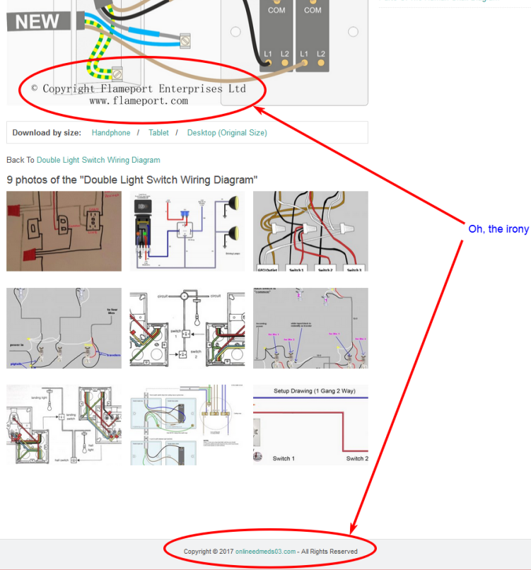

From the switch Wire 1 Colour is Brown goes to COM on the switch to the Permanent Live of the circuit.
Wire 2 is Grey and goes to from L1 on the switch to Line in the Junction Box from here it joins the Mirror Line
Wire 3 Black from L1 of second switch to Line in the Junction Box from here it joins the light Line
Small brown wire goes from COM to COM on the switch.
Like this image.
https://onlineedmeds03.com/double-l...iring-diagram-how-to-wire-a-incredible-ansis/
It all works, as I said you did actually answer my question originally so I am happy, I just wasn't sure if the wire from Com to Com was acceptable in the same way as that image as I have never seen it done that way.
If it's still confusing as my explanation isn't clear I can take an image later.
