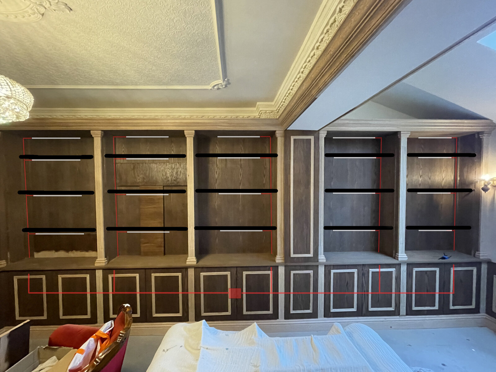

Hi all,
Wiring question for what will form part of a media room for me. Thinking of lighting the alcoves under the shelves with LED strip lights plus diffusers. I want them all from the same source so a single switch/button press will affect them altogether.
I'm certainly no spark and never done this before, so wanted to ask; wiring-wise does this look sensible? i'd end up having to use a hella lot of splitters. with this method.. so wondering if there's a better approach here? am i being stupid basically
Red lines - cabling (will be hidden with oak coloured trunking)
White lines - led strip lights (50cm width or so, so would be 10M total, ish)
Red box - driver plugged into mains.
thanks all.
Ged
I'm not familiar with led strip connectors but it might be sensible to have a junction box under each alcove and running the 4 cables to each strip from that. Each box could be linked with 1mm twin and earth to reduce the volt drop from the driver and the strips fed with the usual led power cable.

Yeah perhaps you’re right. I was hoping to have one source so they can all be controlled together. Ie led strips come with a remote control usually. So when I dim them down I’d want all the lights to dim rather than 4 remotes if that makes sense!

That's fine, I wasn't suggesting you have more than one driver just multiple junction boxes. Driver feeds box 1 which feeds box 2 etc etc.

I see, sorry total noob at electrics here. So essentially run a bunch of boxes in the cabinets instead of splitting.
But the splitting up where the shelves are does that look sensible ? Rather than wiring them all in series, like an S type pattern. Up, right, up, left, up, right etc.
That would be tidier, I suspect you might get volt drop through the strips though meaning that when you get to the top light it may not be as bright as the bottom. Taking 4 individual cables from each junction box reduces that risk. Someone might come along and say that's totally fine though, I've never actually used them.
