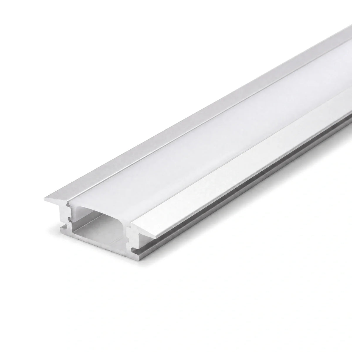

Thanks. I looked it up extensively and like the example you posted the diffusers that I found are curved so slightly proud of the self surface. I'm looking for a flat diffuser and a chanel that is flush with the shelf.
Lots of led mounting profiles available to house led strip. Google is your friend.
Just one example
even toolstation sell some, so you could just route out a channel and fit the profile in it
where will you hide the driver though is the harder part..
The Sensio Aluminium Profile looks the part. Thanks
