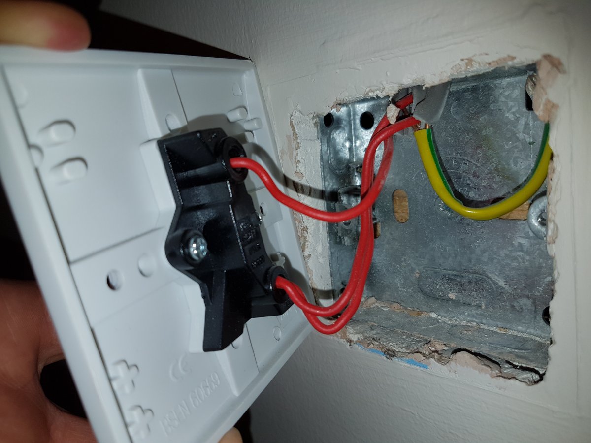

Hi,
I am new to this forum. I know the basics of electricity but am not an electrician. I ordered a chrome dimmer switch from amazon ("Eurosonic 250W 1-Gang 1-Way Dimmer Switch Stainless Steel") to replace a standard one way switch (not dimmer). However the terminals in the dimmer switch that arrived are not what I expected so I want to make sure I wire it correctly (or don't wire it at all!). I have tried to include as much info and pics as I can.
The existing switch (thumbnail photo below) has two cables going into the L1 terminal at the bottom and one cable going in the COM terminal at the top. Then the earth is attached the metal casing.

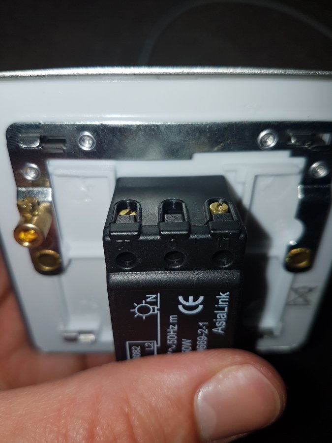

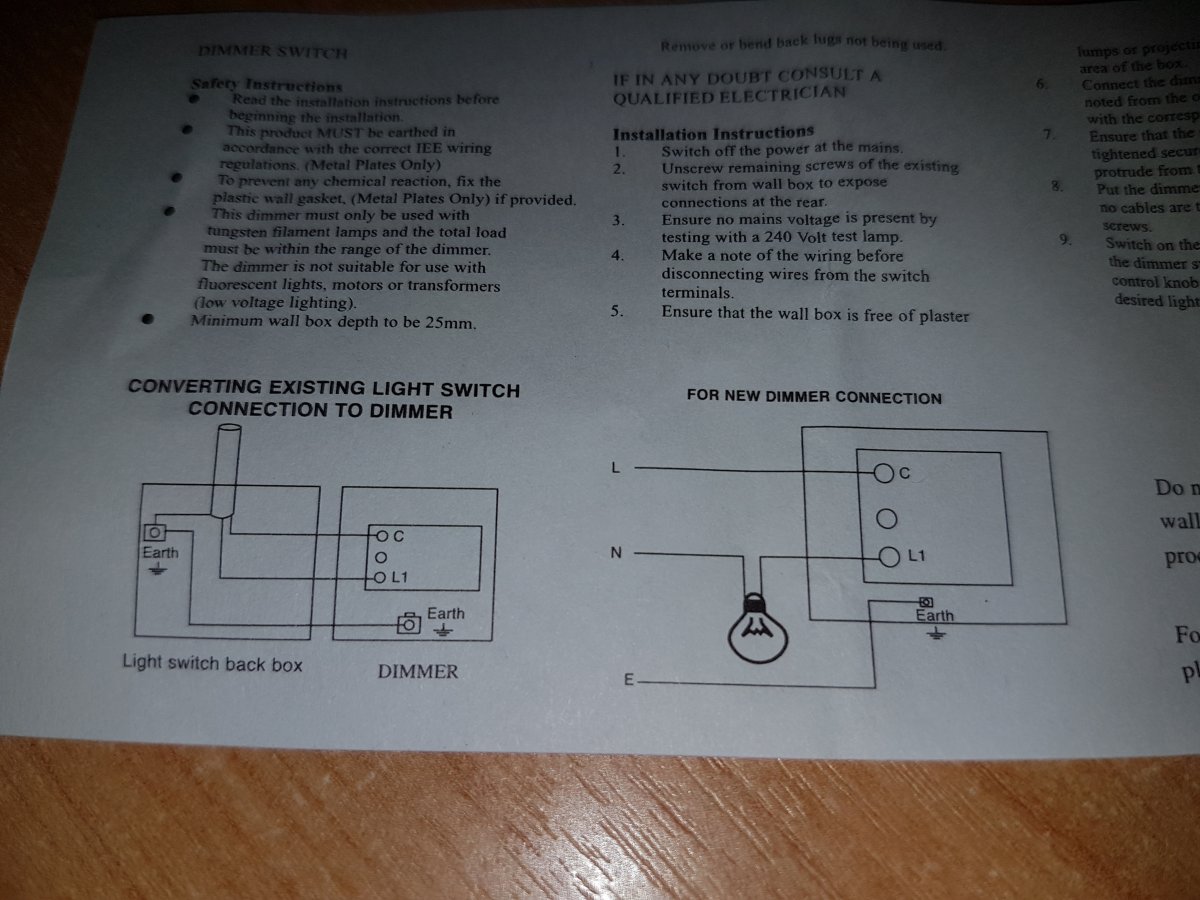

The new dimmer however (full picture below), does not have a COM terminal - the space is there but there is no connector. Instead there is an L1 terminal and an L2 terminal. In addition, the wiring diagram printed on this casing is different to the wiring diagrams in the supplied instructions (also pictured - last photo). The plastic casing on the new dimmer comes off fairly easily to reveal the circuit board beneath so I'm wondering if the wrong back has been put on maybe - I could provide a photo of the circuitry too if needed
So I'd like to know 3 things: 1) should I use the new dimmer at all or not trust it? 2) If so into which terminals do the COM and L1 wires from the old switch go? 3)As it's metal plated I should detach the earth from the casing and attach it to the earth terminal on the new switch. Is that sufficient or do I need an additional bit of earth wire to go from the casing? I'm guessing the metal screws form a connection with the metal switch and back casing anyway?

Run the cables to L1 and L2. Run a green/yellow cable from the back box to the earth terminal.
Thanks - can I just double check: run L1 (old) to L1 (new), and COM (Old) to L2 (new)?
If I don't have earth cable can I get away with what I suggested? If so I can wire it tonight, if not I go to the shop tomorrow!
The diagram on the back of the dimmer makes it clear. The dimmer is shown by the box with the type number 8082 in it.
The pair of red wires should go into L1 and the single red wire into L2
The earth terminal on the switch must be connected to the Earth wiring.
The advert describes it as being a Eurosonic product yet the product is made by Asialink and has a bogus CE mark.
The online Eurosonic catalogue does not appear to include a 250 watt metal fronted dimmer.

You need to test that the earth cable in your switch box is actually an earth, and connect the switch plate to the earth. Do not rely on securing screws to provide the earth. It is a safety requirement.
