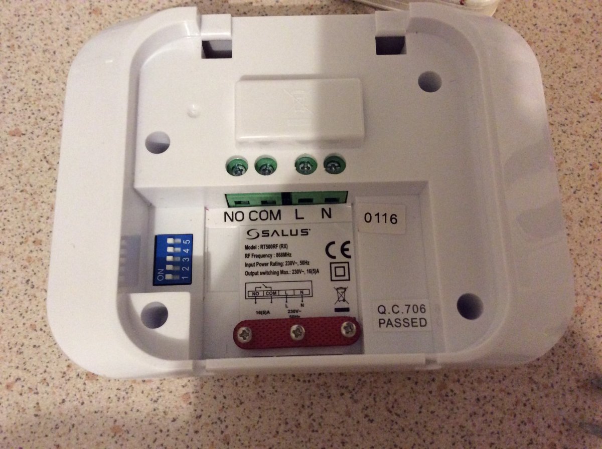

hi everyone, so I have just bought this thermostat and receiver to replace my current one and was wandering about the wiring how it should be done. I have taken a picture of inside the current receiver which I have attached. I have also attached a picture of inside the new receiver. I have also noticed the new receiver has a circuit board where the old doesn't would this make a difference?

1. The black and blue wires presently in 'N' should be connected to the Salus 'N' terminal
2. The brown and red wires that are presently in the two 'L' terminals need to go to the single Salus 'L' terminal
3. The Grey wire presently in the terminal marked 'A' should go to the Salus 'Com' terminal
4. The Black wire presently in the terminal marked 'B' should go the the Salus 'N.O' terminal
Take care where you have to put two wires into the same terminal so that you don't cause a short circuit by having 'whiskers' poking out that could touch each other. You may find it easier to put the two wires into a separate connector / terminal and then run just one wire from that to the Salus terminal.
Also these units are popular now, I recommend you change the operating frequency from the factory setting, I have come across two instances of heating being switched by the thermostat in the house next door because they were both operating on the same frequency.

So iv wired it how u said but the boiler hasn't come on and the salus just has the red light on?
Make sure that all of your connections are good and tight and that none of the wires have fallen out [The Salus doesn't have the easiest connections, especially if you are trying to get two wires in] and the terminals are clamped on the wires and not just on the insulation.
The Salus has powered up OK, and if the green light has come on, so that shows the the two units are communicating with each other.
Bingo iv got it working i guess a wire wasn't in proper or something it's working fine now. thanks for your help so now my only problem is that I'm unable to attach to the wall as the wires are to short so I have no idea what il do about that lol
