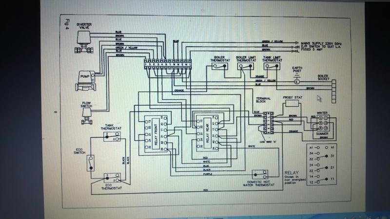

Need a hand with where to get NO feed off boiler and are there any links need making unmaking? Boiler manual says remove link for thermostat.
Live and neutral feed and linking live and COM in receiver i understand,
NO (normally open) has me baffled. I dont see how it would work if just connected between 2 thermostat terminals currently linked(link A in pic)
Any help guidance much appreciated
The link is marked as LINK WIRE 'A' on the diagram.
NO, normally open, is the terminal which is not connected when the thermostat is at rest and not calling for heat.
