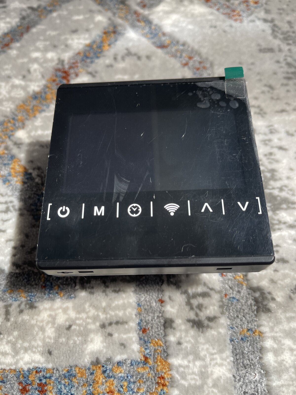

wiring? to replace old room stat with smart switch
4 Jul 2022
3
Can anyone help me for wiring my old Honeywell thermostat to new MH-1823/L Smart switch

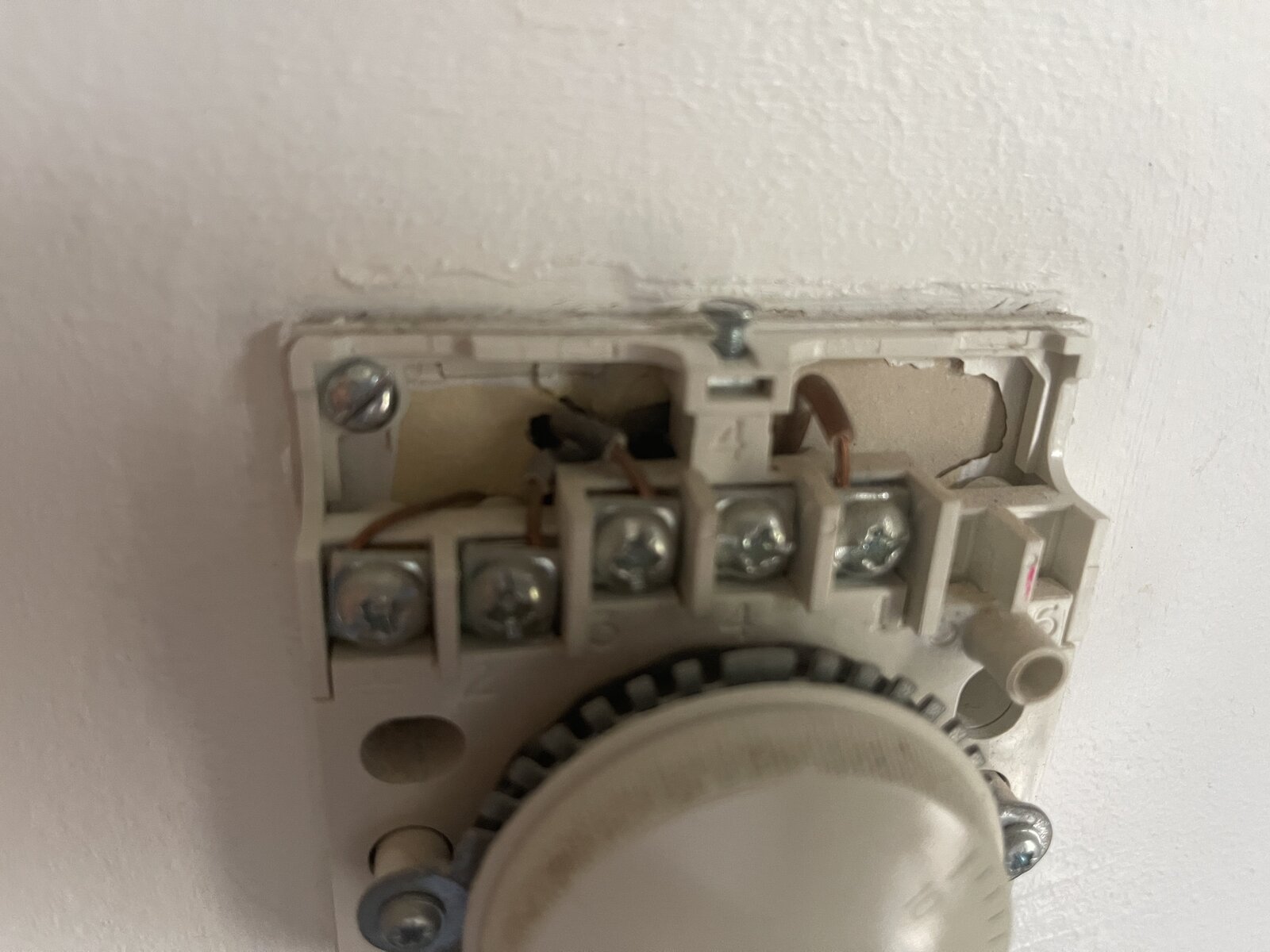

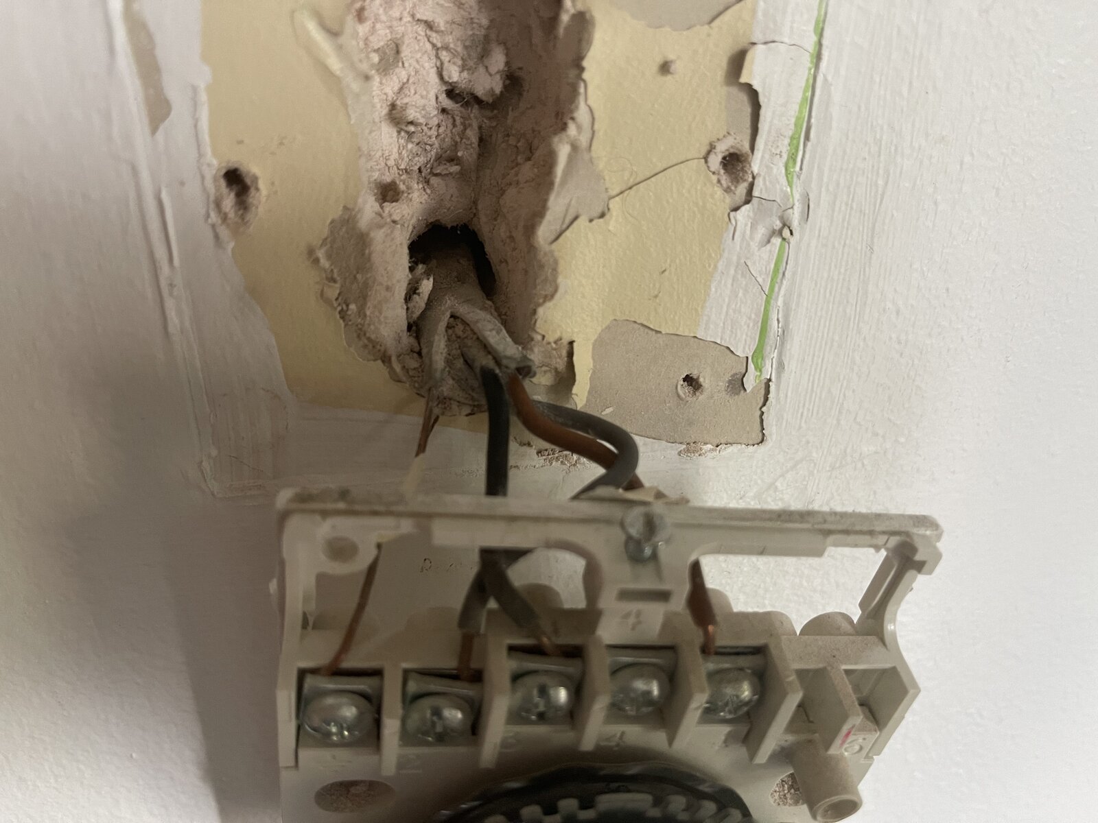

have you got the instructions for your new switch? you old room stat appears to have a red and a black wire, in terminals 1 and 3
you can use a toothbrush or small paintbrush to clean the dirt off to make the colours clearer. the bare earthwire should be sheathed green and yellow.
no doubt you have a live and a switched live to start the central heating pump
it looks as if Switched Live would be in 3, if I understand the diagram correctly

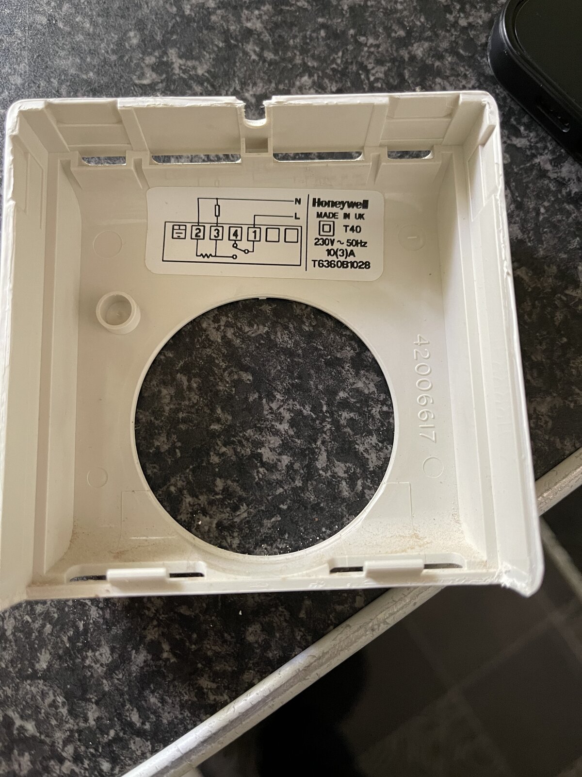

the diagram on the old casing says that L should be in 1 and N should be in 2
the quality of the pic is very poor. there is also an unsheathed earth conductor in a terminal to the left of the pic. You need to work out what they are. Can you afford £8 for a multimeter?
Some old thermostats were wired without a Neutral. If it does not have a neutral wire, then your new switch will not work if it needs one, until you run a new cable.
You will need a neutral for a smart switch, won’t you? Your old stat may just be a switched live.

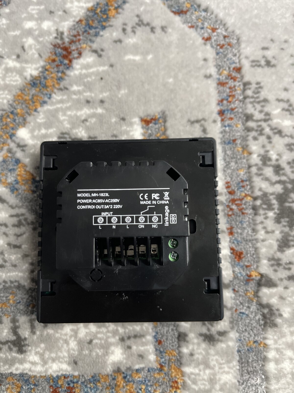

I would wire it the following way, taking these as Honeywell to new smart switch:
1 to L (input)
2 to N
Link a wire from L to L if it’s needed
3 to On
1 to L (input)
2 to N
3 to On

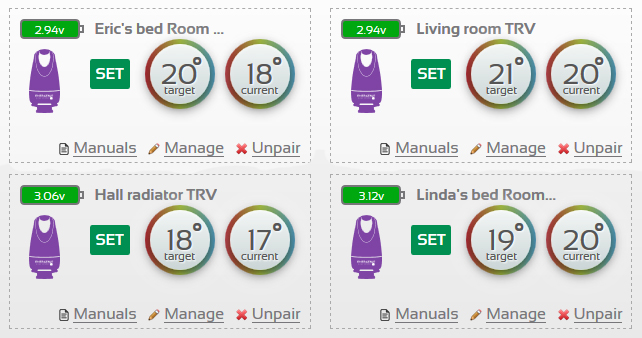

However my PC can read this TRV-report3.jpgand it seems so easy, if the current is below target I want boiler and pump to run, so why do I need a wall thermostat? Although I have 14 TRV heads and only 4 are wifi, and 5 are bluetooth, if it just worked with the 4 that would be good enough.
But my PC knows I need the boiler to run, but I see no way to translate that info to a simple switch to turn on the boiler, I would think that there is a if this than that (IFTTT) way to get the TRV heads to turn boiler on/off, this would also ensure the pump does not run when all TRV heads are closed, a speech request "Hey Google what is the living room temperature" gets a reply "TV side TRV set to 20°C and temperature at moment 19°C" so why can't a Google Nest switch also turn heating on/off, without any need for a wall thermostat?
I can see hall wall thermostat set to 17°C and at moment at 22°C, and hall TRV at 19°C and set to 20°C, which seems odd when both in the hall, but heat raises.
