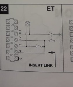

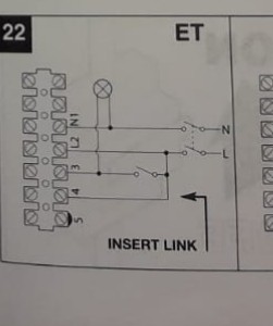

Yes I get that but where exactly do I put the link wire?
Am I right in saying I just put a link in between 4 and L2?
Thanks for the reply

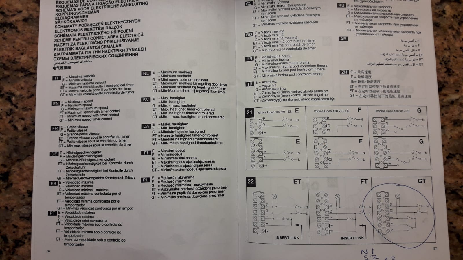

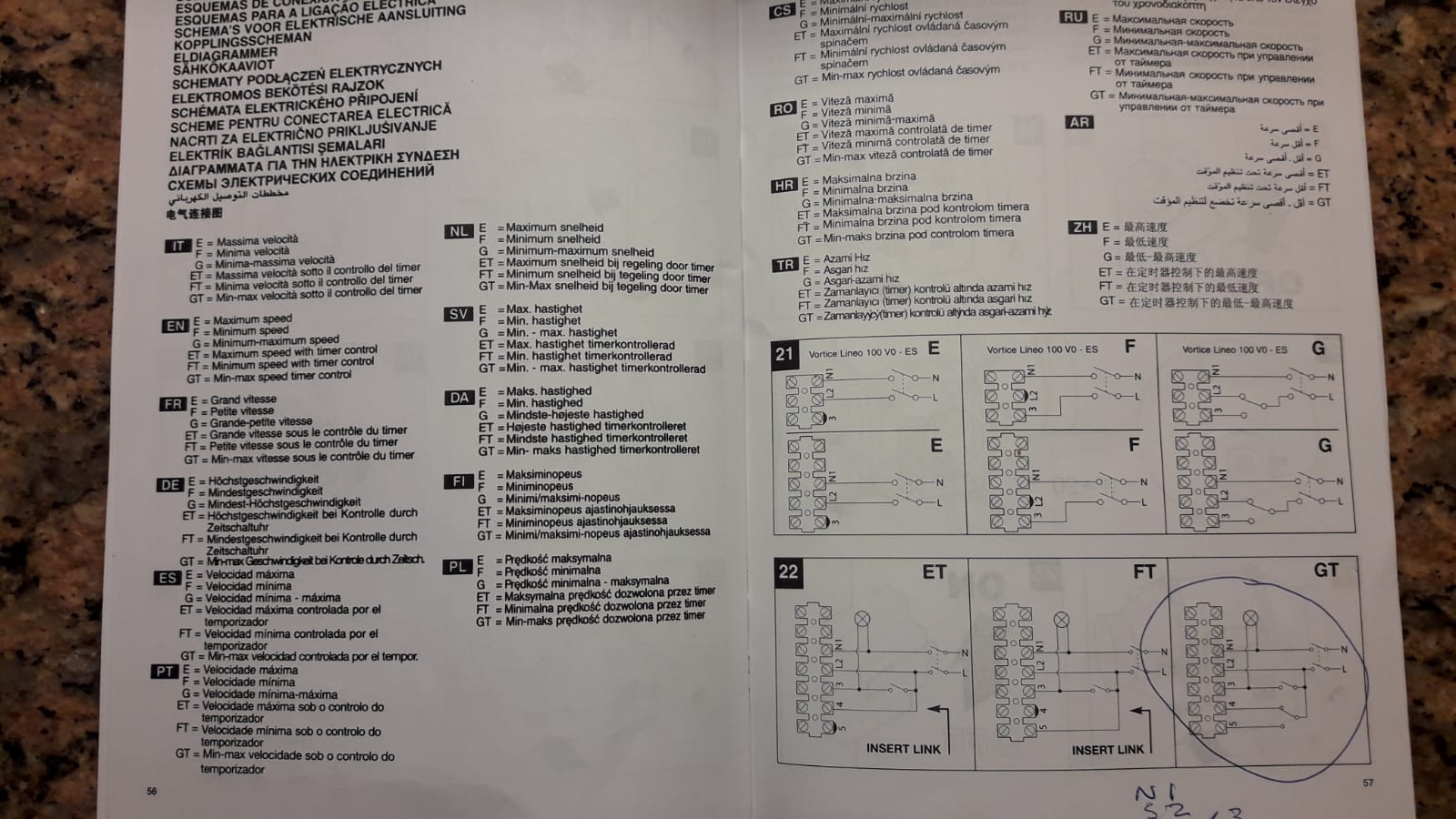

There are several diagrams with several configurations.
This diagram is for a set up with a timer and high speed.
What do you have at the moment?
Do you have a three-pole isolator for the fan?
Does the light switch control the fan (plus run-on with timer) or do you have a separate switch?
It is very unlikely you have an arrangement like the diagram with a double-pole isolator covering the light and the fan.

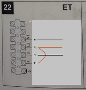

This is what you need -
PL = Permanent live
SL = Switched live
N = Neutral
Plus unused Earth.
You will need some three-core and earth cable.
You could connect the wires at the ceiling rose (if the supply is looped there) or switch (if looped there - not as likely)

Thanks EFL I think this will do the trick, I'm replacing an in-line fan in the attic which has a PL, SL, N.
The instructions weren't just as clear as yours.
