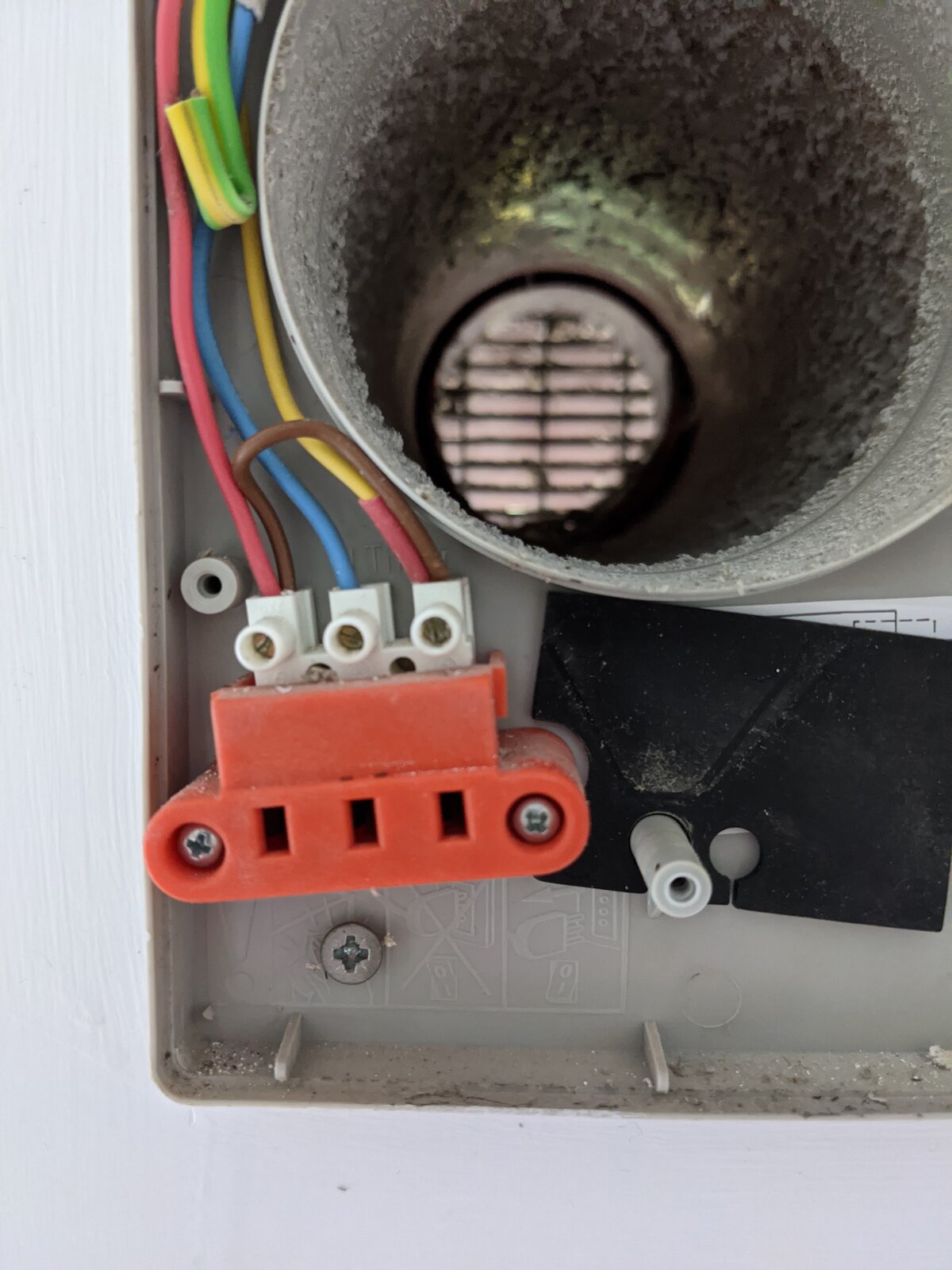

Hi,
Apologies for opening up a very old thread, but it is 100% relevant.
I have the same bathroom extractor fan as the OP, which comes on with the light and stays on for a timed period after the light is switched off. There is an isolator switch outside the bathroom.
I want to disable the timer so that the fan turns off immediately with the light switch, and found this thread.
I followed the advice above and linked the permanent live to the switched live (I added the brown wire in the attached photo) but this had the effect of both the light and the fan being permanently on regardless of the light switch (this was with the isolator turned on).
Did I do this correctly?
thanks!
Pete
No it isn’t. The OP didn’t have a perm live wire, but you do.
No.
Disconnect the permanent live wire.
  • Thanks
Reactions: PxC
Thanks for both of your replies.
So once the red is disconnected is it best to connect it to a single terminal block, or snip off the exposed wire, or wrap it in electrical tape?
I disconnected the red but the fan doesn't work at all now when the light is switched on. I did also try disconnecting just the yellow (just in case!) but this was the same.
I've put it back to how it was originally and it's all working. Thanks for your help anyway, much appreciated.
