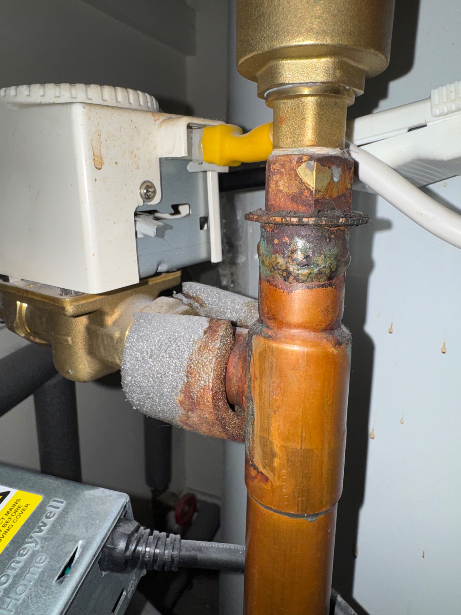

  • The motorised valve lever has virtually no resistance and slides freely, suggesting the valve is already open.

The suspect Zone 2 valve is an ESi ZV-222/W 2-port motorised valve, connected to the wiring centre by its 5-pin plug/loom.
I haven’t yet removed the actuator to check whether the brass valve spindle moves freely.

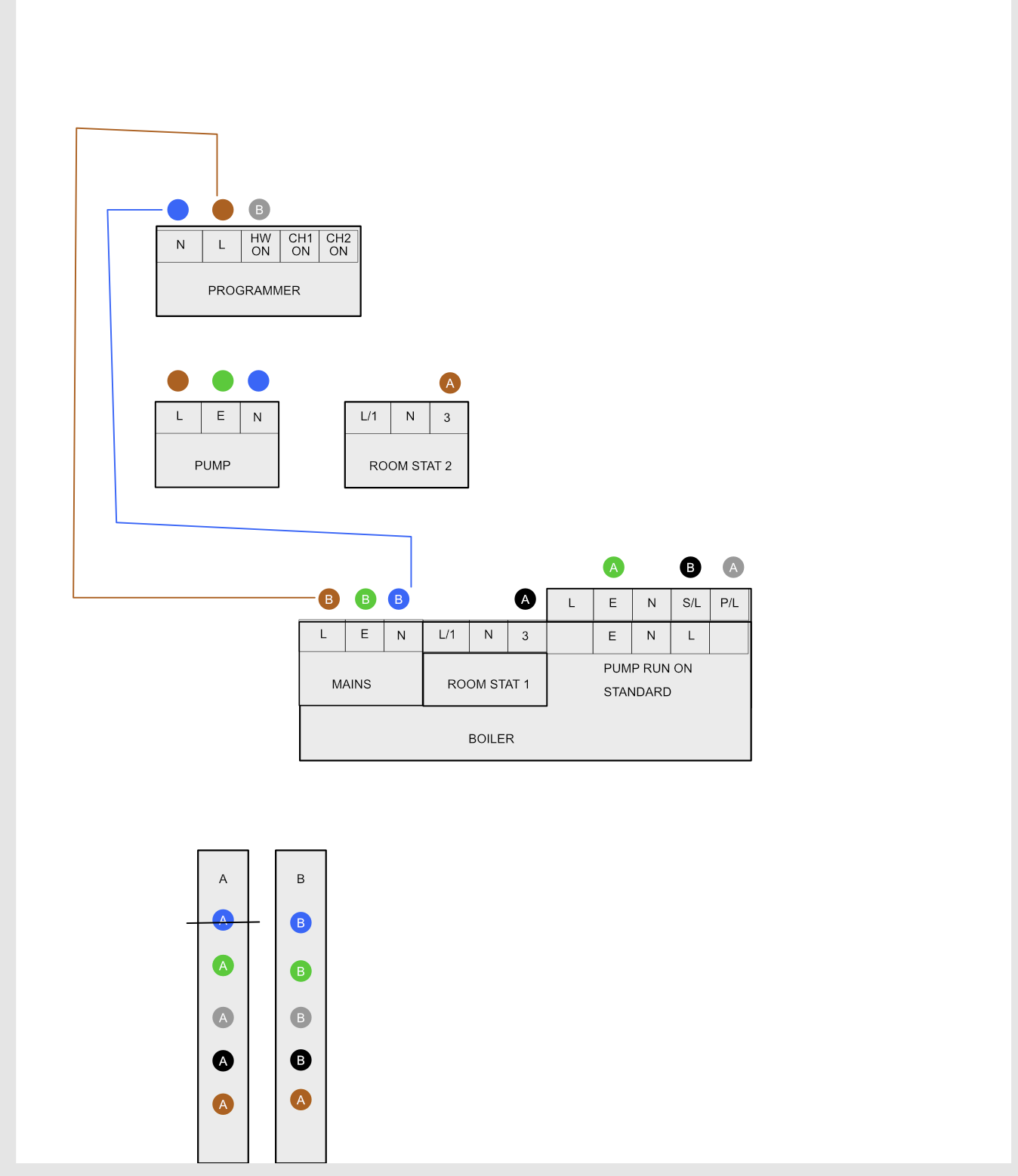

I’ve attached the original wiring-board diagram. The Zone 2 valve itself connects via the 5-pin plug and isn’t explicitly shown on the drawing.
Can anyone advise where on this wiring board I should test for the Zone 2 motor/opening supply, and what readings I should expect with Zone 2 OFF, Zone 2 ON and HW-only?

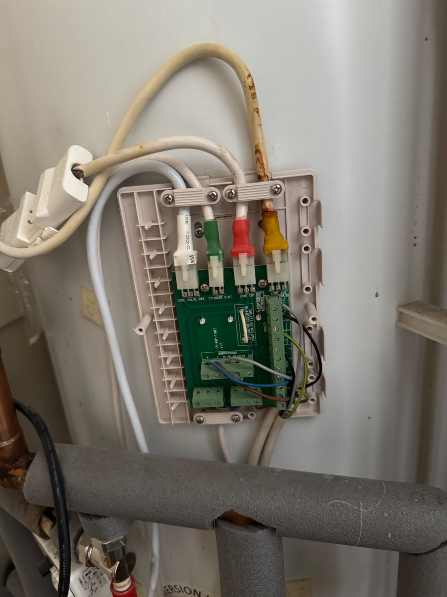

The ESi ZV-222/W actuator uses a 5-pin plug connector rather than exposed flying leads. Is there another way to test?
Probably best in the wiring center then, same wires.

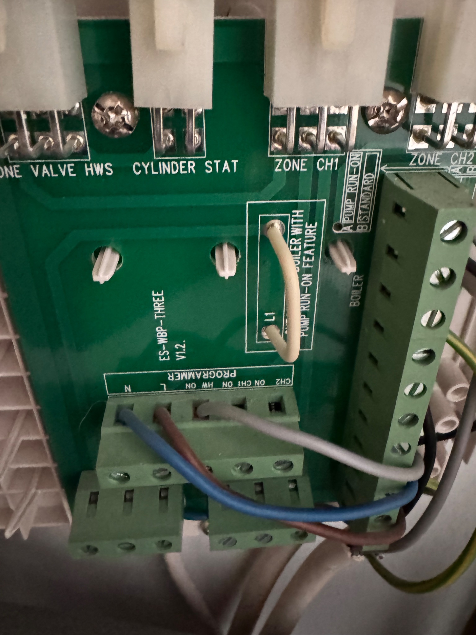

Sorry to be dumb here - but the 5pin is also the connector circuit board. I attached picture of circuit board above but can’t figure which brown is being sent to the motorized valve

Download all the manuals for the bits you have and draw the wiring diagram as it should be, then redo it.
I'd disconnect EVERYTHING and doing continuity tests to make sure your wires are going where they should be.
You should have a zone valve on the HW which goes to S/L on the boiler. (common with the other zone valves)
Using the boiler room stat for a wiser system is a little unusual.
You've got the right idea in drawing it out as shown, just do it for the full system.
As it stands, yours looks odd. (at least to me)
There should be a place to test. Any photos?
Difficult to say really, but I would say it’ll be one of those 3 as the other end/2 wires is just a switch.

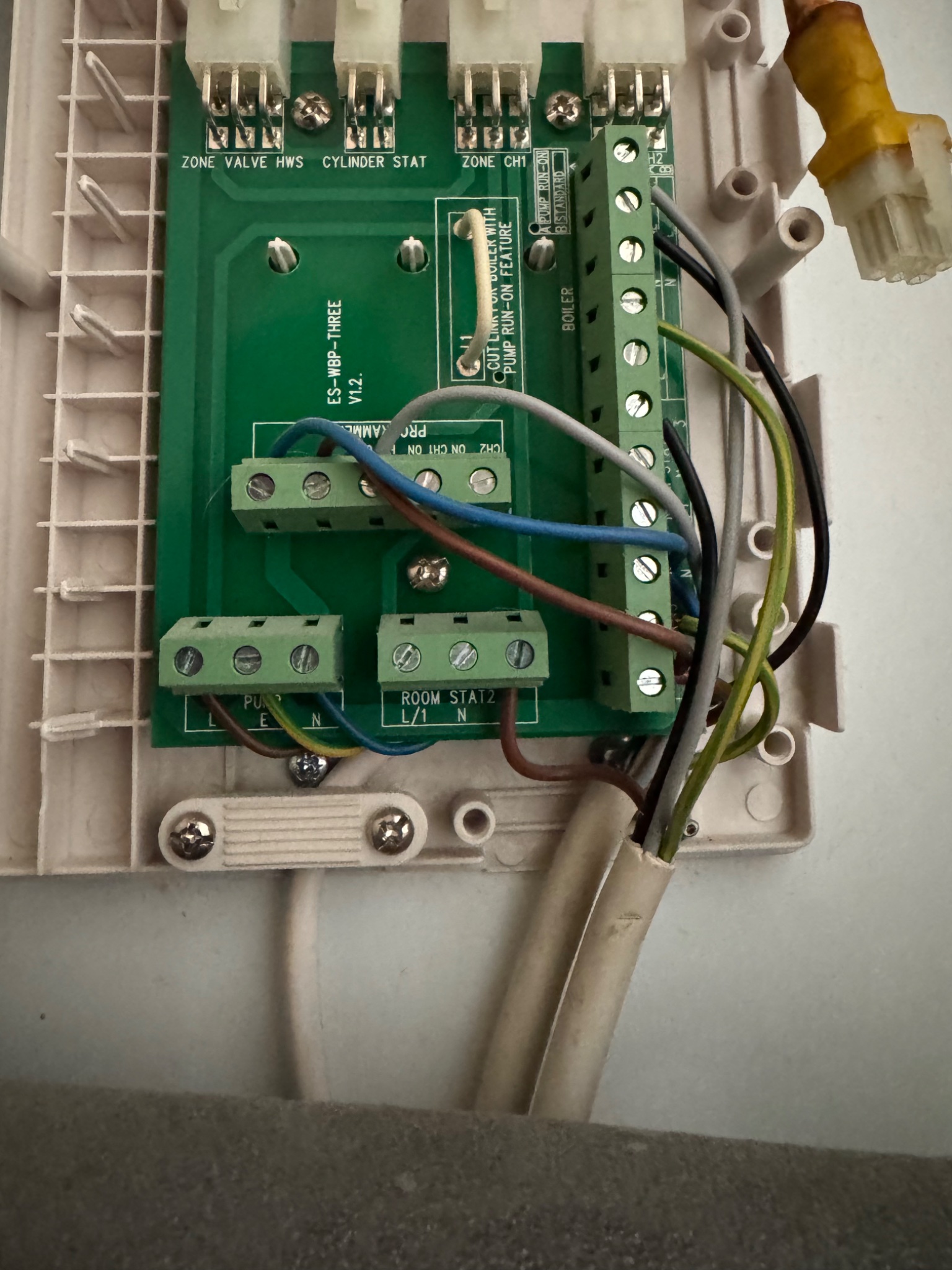

Thanks for all the replies so far. This is the update after continuity testing:
Update: I’ve traced the wiring further and found that the problem/upstairs stat is not actually fed from the Wiser programmer at all — and, as far as I can tell, wasn’t fed from the old ESi programmer either. Instead it has a permanent live from a separate junction behind the programmer.
The working downstairs stat is different: it is fed directly from Wiser CH1, and its switched live goes to STAT 2 (3) on the PCB.
The upstairs stat’s switched live goes to STAT 1 (3), so with the old stat bypassed its permanent live is effectively keeping that input permanently called, which would explain the upstairs valve staying open.
Even stranger, continuity testing shows the wire on Wiser CH3 — previously the old ESi CH2 heating output — actually goes to P/L (pump live/run-on) on the PCB.
So:
  • why would old ESi CH2 have been connected to P/L?
  • can I repurpose the existing upstairs live-feed cable so it is fed from Wiser CH3 instead, making it behave like the working downstairs zone?
