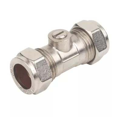

Sometimes restrictive isolating valves are fitted near taps, and throttle the flow. Look out for them.
Ah yes. Peppered with those. I saw specific non-restricting ones at screwfix. I'll look along the two circuits (bathroom and outside taps) to see if they part culprit.
I very much favour the Pegler full-bore valves. Rather expensive, but ten times good as the cheap ones (which also leak at whim). Notice that they look fat in the middle, to accomodate the large orifice.
The T handle ones are quite neat, but lever handles if you have room and your fingers are not strong.
