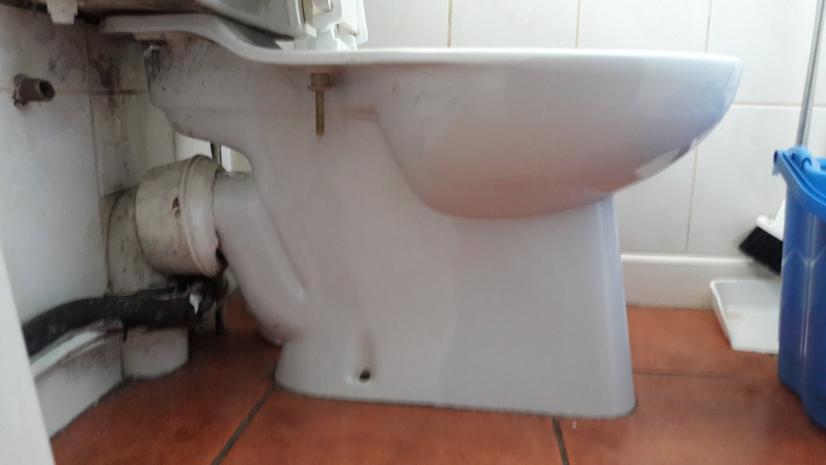

One of the extensions has a loo, on first floor . The toilet here, fills and drains slowly taking nothing with it. Sink is fine.

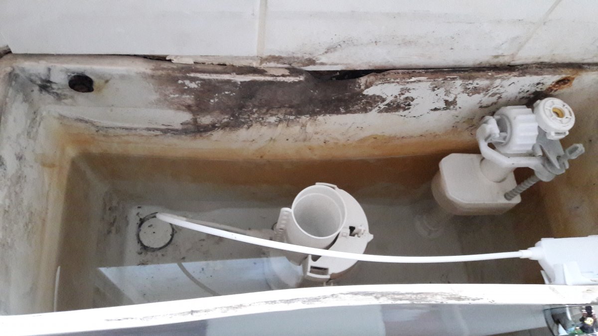

HI there how old would you say the toilet is, and you say you have the cistern off when you took the cistern off did you find there was a plunger type fitting with a rubber on the end of it that dropped out of the toilet syphon its about 4/5 inch long and has a dish shaped rubber on the end.
If this is what you have its called a syphoic toilet and they do have symtoms with the bowl filling up and not flushing properly.
Here is a shot of the toilet cistern - does this make it syphonic toilet ?
I didn't see anything between the cistern and the pan - when I had the cistern off.
How can I identify one of these ?
It's a shires toilet pan. No idea of fitment age. We believe the extension to be mid-70's - so maybe that old. The insides do look recent AND the cistern was held by two shiny wing nuts - in my experience these go rusty pretty quick.

Hi again John from the picture it dosen,t like a syphonic that looks quite a new design syphon a syphonic toilet pan is different to a standard one
does water flush from the pan if you pour a bucket of water down it, have a look at the picture the curves in the pan itself.

picture of pan attached.
This looks kinda like the siphonic toilet .. but you reckon the mechanism isn't ?
Is there a sure fire way of determining it ?
A bucket tipped in steadily, raises the level by an inch or so and I can keep on tipping without a problem...
That's a syphonic pan - the video showed the classic symptoms. As you're on a septic tankl I would remove the whole toilet ( 2+ gallon flush) and replace with a new " bog in a box" from Wickes @ under £100. The mech. in the cistern has been replaced and that's probably why the setup won't work. Remeguy is on the right track too(y)

Now i,ve had a look at the picture of the pan it looks like a syphonic pan looks loke the syphon in the cistern is for a normal toilet.

Keep the cistern, if matching, as well. The valve in the "throat" may be missing, but replacements are available.
Now i,ve had a look at the picture of the pan it looks like a syphonic pan looks like the syphon in the cistern is for a normal toilet.
Indeed, the part in the cistern is a "flush valve" not a syphon so whoever put that in didn't understand syphonic pans.
Some good advice here. Get a decent plumber in and remove the silly push button valve and fit a siphon with a torpedo, as we used to call them and all will be fine.
