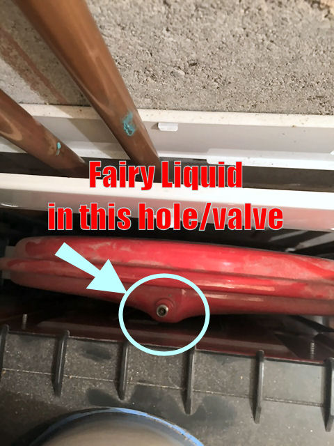

Put som leak detection fluid or fairy liquid and water on the Schroeder valve on the expansion vessel(the part the engineer pumped it up with) turn on heating and look for bubbles.

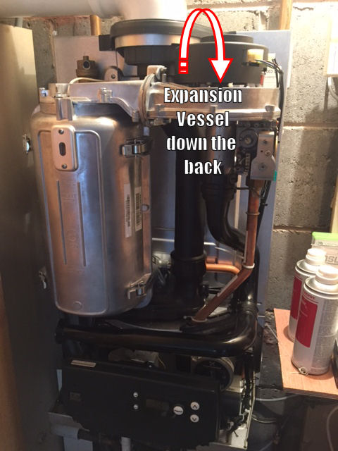

I'm not sure I can get to it as its situated behind all the other gubbins but I'll have a look and try the fairy liquid idea.
Are you sure that you don't mean a Schrader valve ?

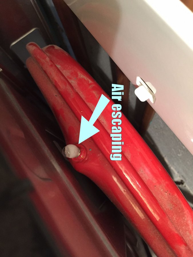

I checked the bike tyre valve on the expansion vessel. It's quite a difficult to get to as it's behind the boiler. But when I looked closely at it I could hear air slowly crackling out through it.
See the pics...
So my next questions are....
Is the valve 'fixable'? i.e. will a bit of WD40 and a few on/offs reseat it correctly again?
Is it easy to change the expansion vessel (i.e. do I need a 'gas safe' guy there or is a DIY job - I'm a competent DIY'er and an electrical engineer by trade)?
Do you have any places you would recommend to get a new expansion vessel for a Buderus boiler?
I put the pics up just to show you the setup but also to potentially help someone else who may stumble on this thread in the future.
