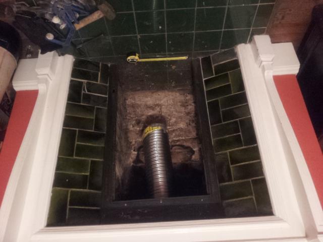

Can any of you please help me with some advice. I am a pensioner with little money and need a cheap solution if possible.
I have a Victorian house with a smallish 18" wide fireplace.
It has a tiled and wood fireplacensurround.
I have bought a small stove which says 450mm to combustible surfaces from the side of the stove.
The wooden fire surround is more like 250mm from the side of the stove.
three questions:
1. one HETAS installer said as long as it was more than 200mm I was ok? Is this true? The plate on the stove says 450mm
2. can I have a concrete strip mounted onto the tiles - between the stove and the wood fire surround, so that I do not need 450mm? (It would be a vertical strip about 980mm high and 100mm front to back and 13mm thick). This would 'shield' the stove from the wood.
3. the distance from top of stove to wood fire surround is 450 mm is that ok?
Note: For the last 30 years I have had a morso squirrel in this fireplace but it needed replacing after so much use. Yes the chimney is lined and regularly swept.
Many thanks for any help

I don't think your wooden surround will catch fire. *If* your engineer is happy that it is safe and complies with regulations, and will sign it off, then I would just do it.
I regularly have piles of logs stacked closer to my stove than that, and they haven't caught fire yet.

From my experience with my previous stove I know that my wooden fire surround did not catch fire but............. I am trying to get an answer about complying with building regulations.
What I want to know is: if I put in a vertical metal fin between my stove and my wooden fire surround will it comply with building regs. The stove is too close to the wood according to the manufacturers data. Hence some shielding is needed.
Can anyone please answer my question as to the suitability for building regulations of my intention to put in a metal shield? But only answer my question about building regs please.
Many thanks
Many thanks
Wouldn't it be quicker to ask the HETAS engineer who will be doing the work? He's the one who will have to decide what complies with building regulations, before he certifies it on behalf of building control.
