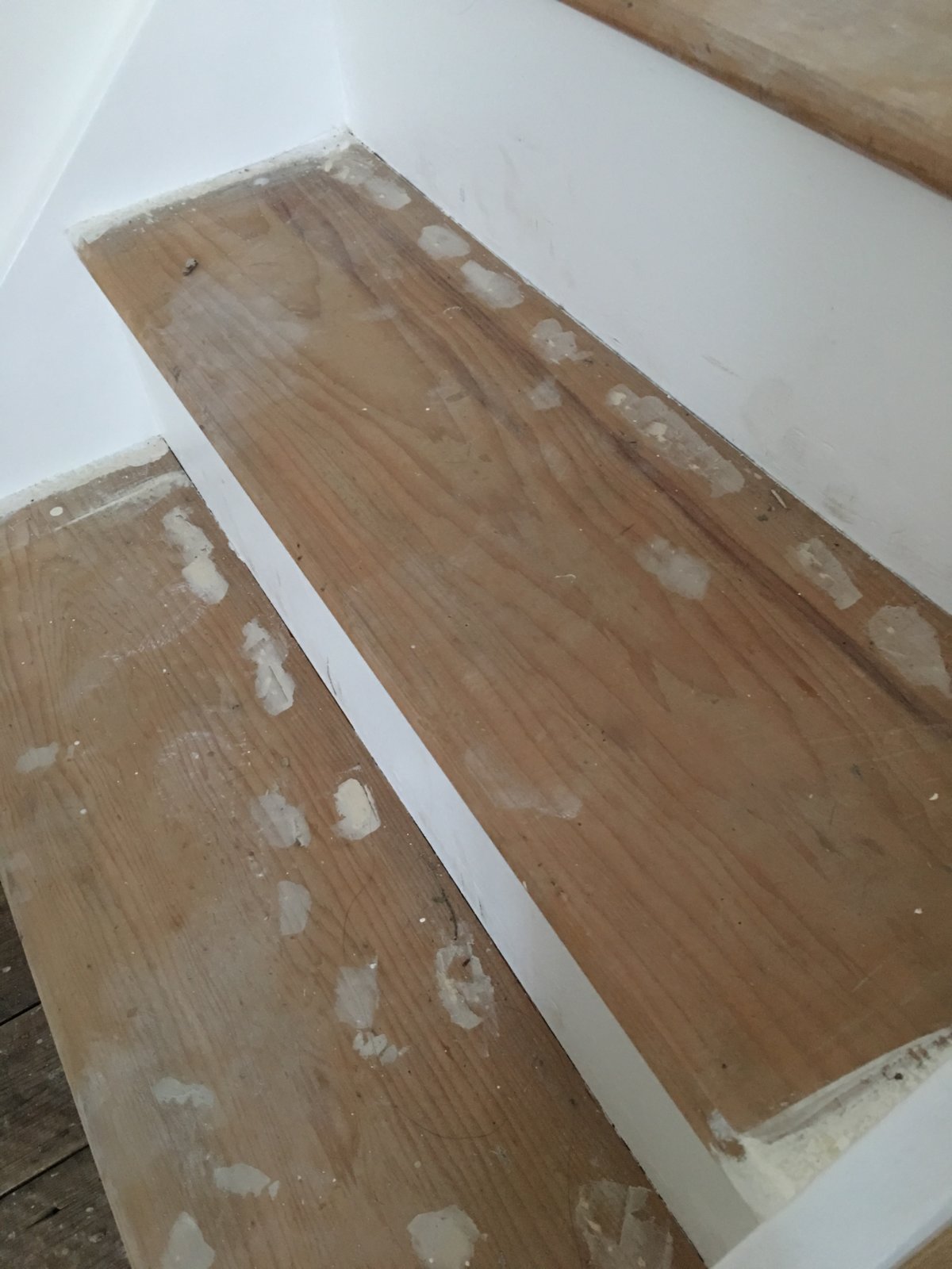

hi all

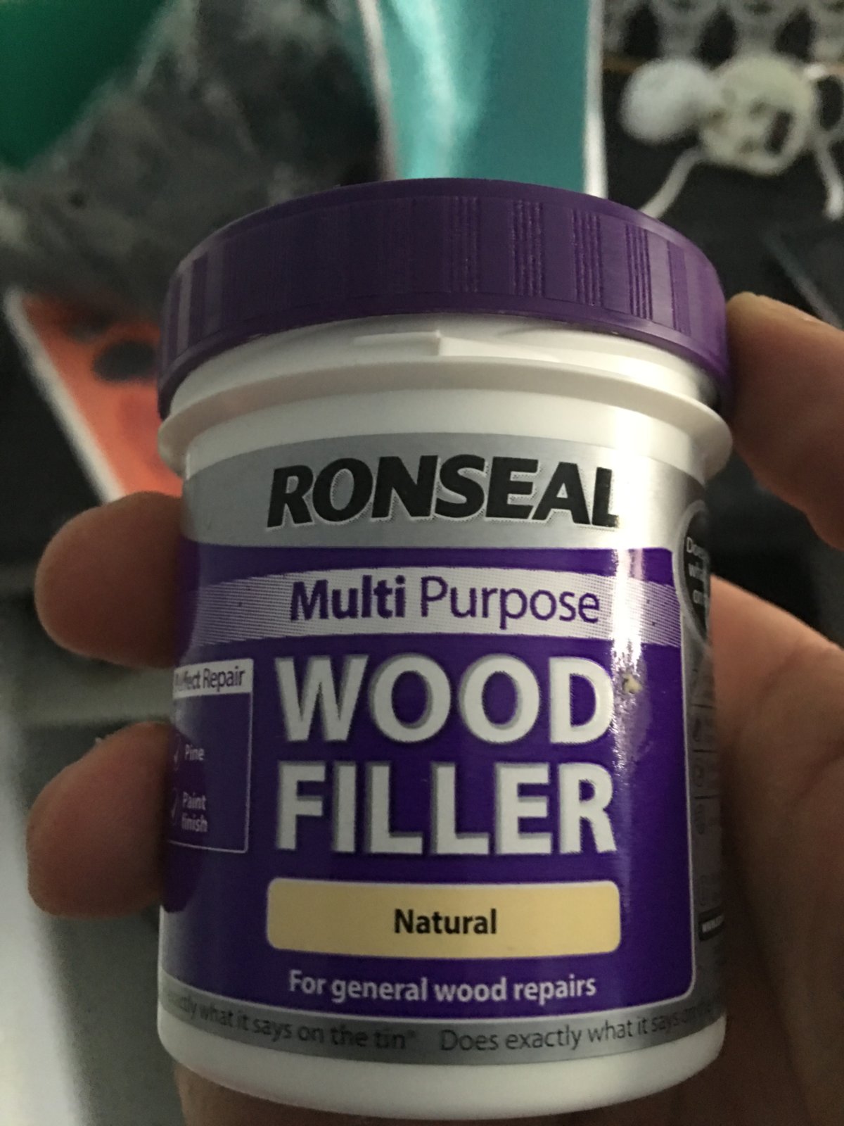

I recently took off the carpet on our stairs and was going to redo them with white risers and dark varnished treads. I bought slightly the wrong colour ronseal wood filler and now I'm realising that this will show up when I paint any varnish on. Is there anything I can do to still be able to varnish the treads or will I have to paint them now?

You didn't buy the wrong colour what you bought is just crap. I am not being facetious when I say if you ever find a filler that matches various shades of properly let us all know because I haven't found one yet. I suppose the correct way to go about filling wood is cut the affected part out and glue an insert in made from the same wood.
Probably won't be as noticeable once sanded down (the filler.)
If it's still a problem, perhaps you could get a small pot of wood dye, and dab it on the nail heads before you varnish.
You might get away with sanding the unfilled part of the stairs with a medium grade and collecting the dust.
Either totally remove the filler , or enough to recess it, then mix the dust with pva and use that as the filler.
Then sand for finish
thanks that's a good idea and one i've seen mentioned elsewhere. i was thinking as a plan b to paint the treads in floor paint. anyone had any experience with painting treads?

Personally I wouldn't paint wooden treads, it will soon looks scabby... stick to filling and sanding.
Ok will try the sanding method first and see how I get on. Will provide update pictures of the final varnish or painted treads.

If your filler is water-based, get some acrylic tube colors which are rich, deep pigmented colour sources and their carrier will be compatible with your filler product. Learn to colour the filler before application.
