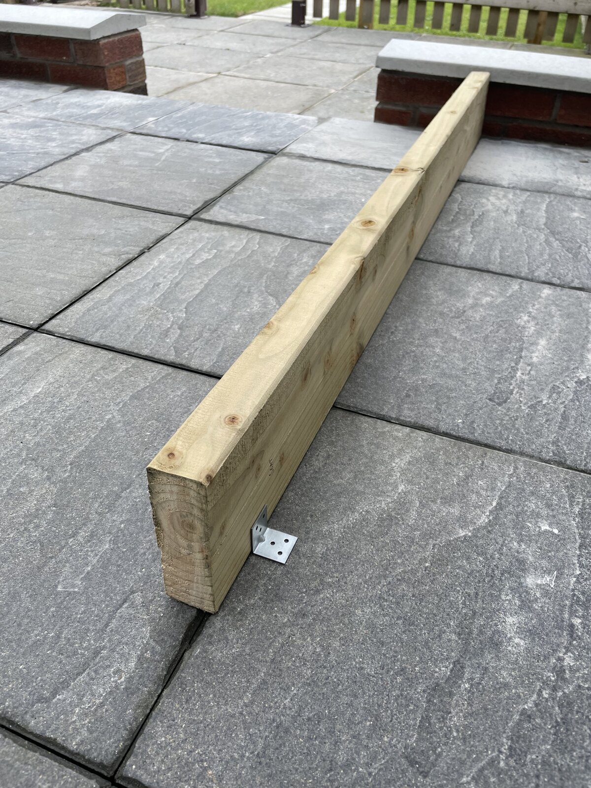

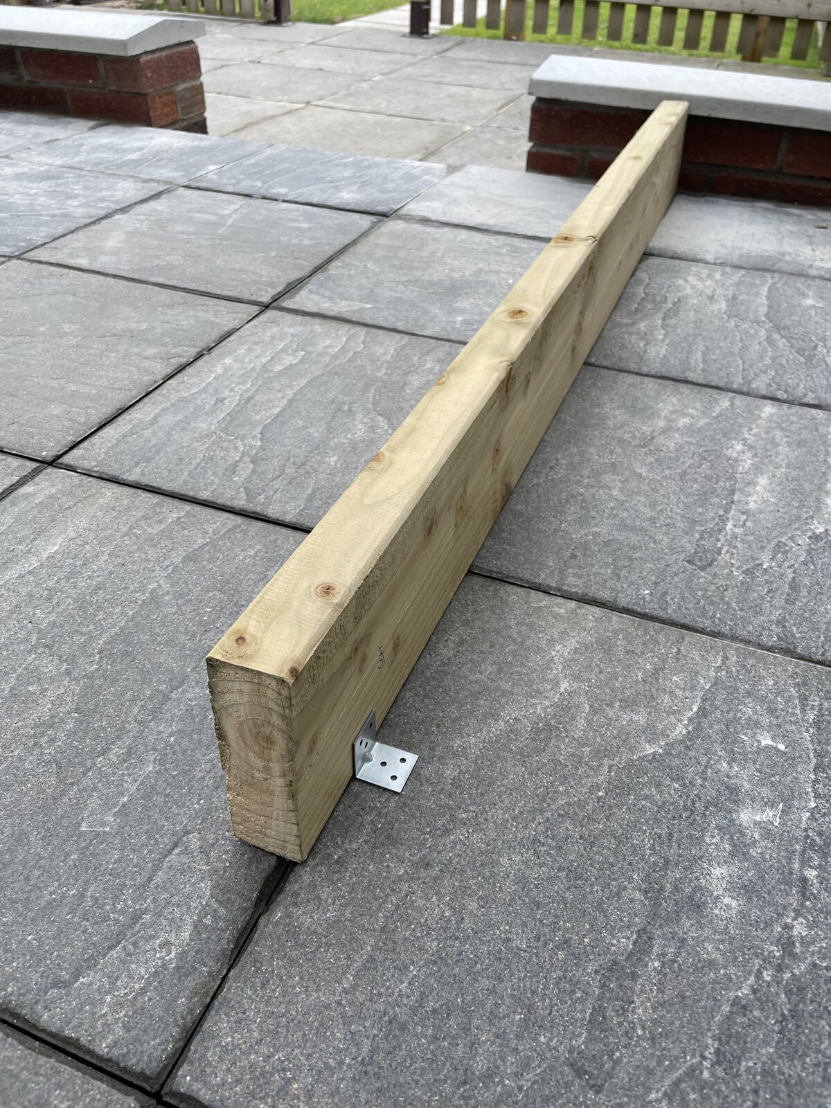

Hello. I am planning to lay a bit of timber as shown and use it as a flower bed. I was just wondering the best way to attach to the concrete? There won’t be much weight and was thinking about these clips as shown in the picture. Any advise would be great thanks

Think I'd go for bigger angle plates than those (they aren't clips), maybe 1/2 to 2/3 the height of the timber.
thanks mate any idea what they’re called so i can get some on amazon?
Search for "Angle bracket"
For these I would use tool station over Amazon.
However, why does the wood need attaching to the concrete floor? I did not bother. With the weight of the wood and the soil the flower beds should not move.
Ps on my wood flower beds i lined it with DPM to reduce contact of soil to wood to slow rot, and to keep water in bed.

I gained the impression that the OP wanted to use the timber as the wall of the flower bed, in which case the weight of the soil might well push the timber out a bit. I agree that the DPM is a good way of slowing the inevitable rot and retain water, maybe with a bed of broken brick at the bottom?

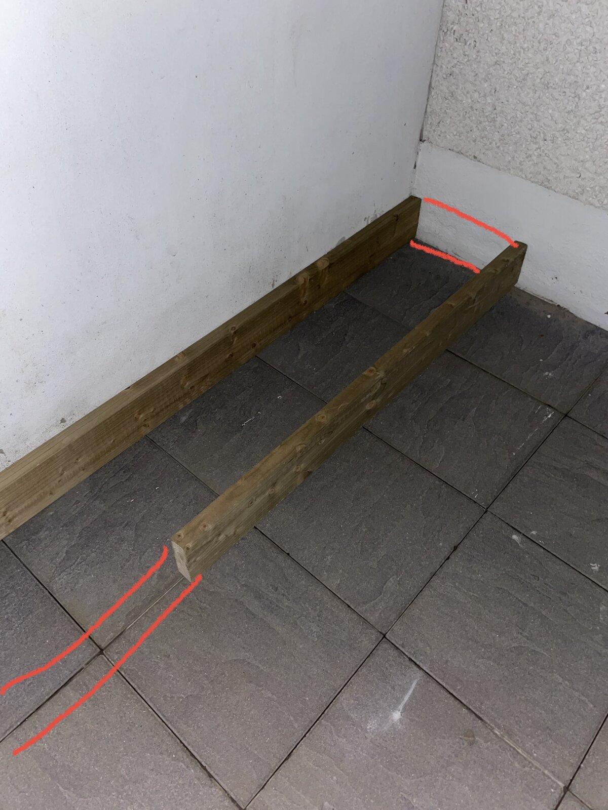

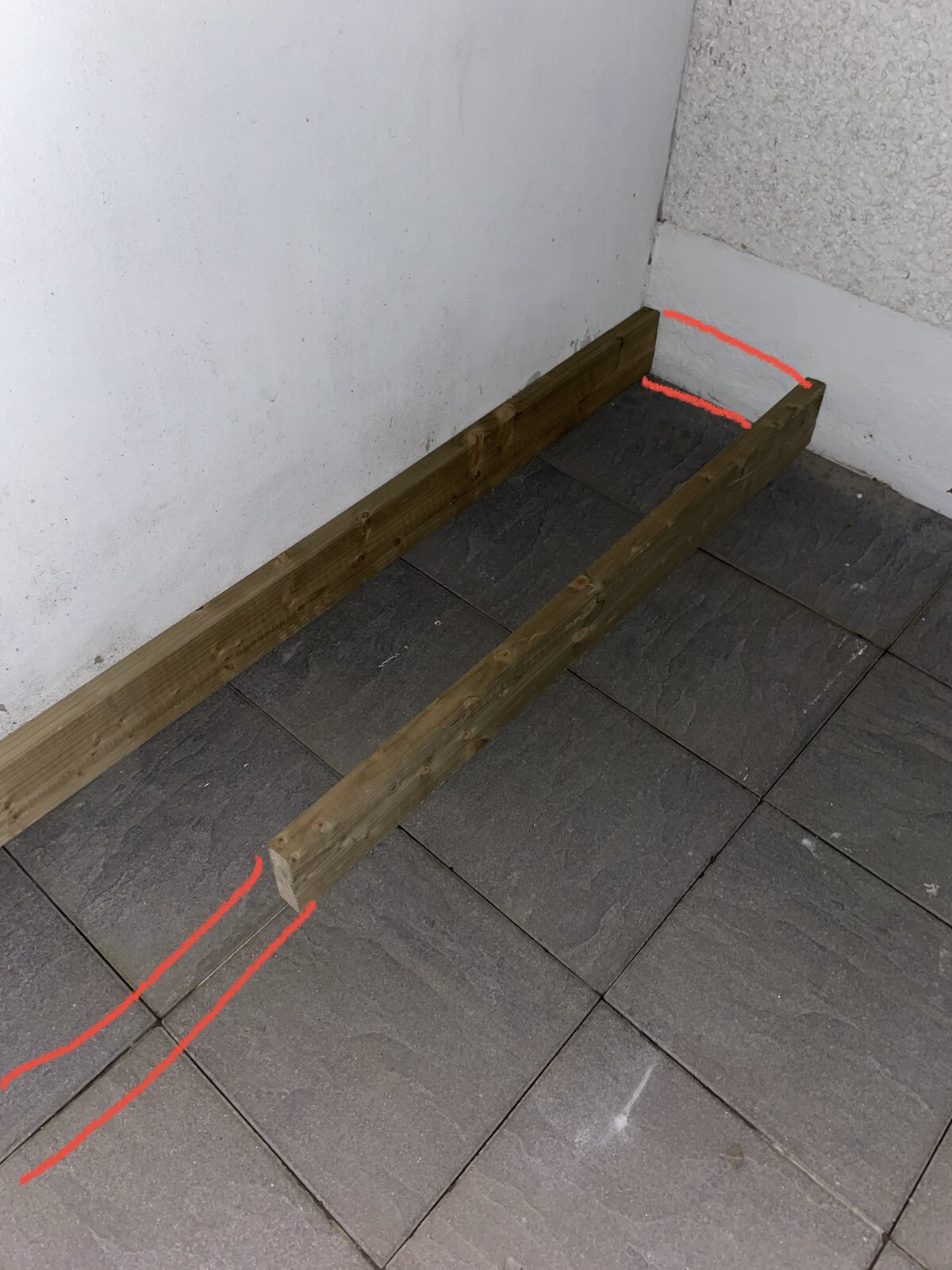

Are you planning to make a wall or a rectangular bed?
Like this. Just using some off cuts to demonstrate the red would be wood also

Single height or more levels to make taller?
From my experience... Front panel will bulge out (over time) due to weight of soil.
To stop it I would not screw into slabs/ tiles though (as slabs / tiles might break).
Quick cheap fix is to cut a bit of wood same as your side panel and put it 'flat' on base/ floor in middle of bed and screw into it (from outside or use above angle brackets on inside). If a long bed do this at two or three points evenly spaced.
Strongest (and most expensive) version is to fill base with wood.
I typically use three or four (or however many offcuts I have that will fit).
Def use DPM.
