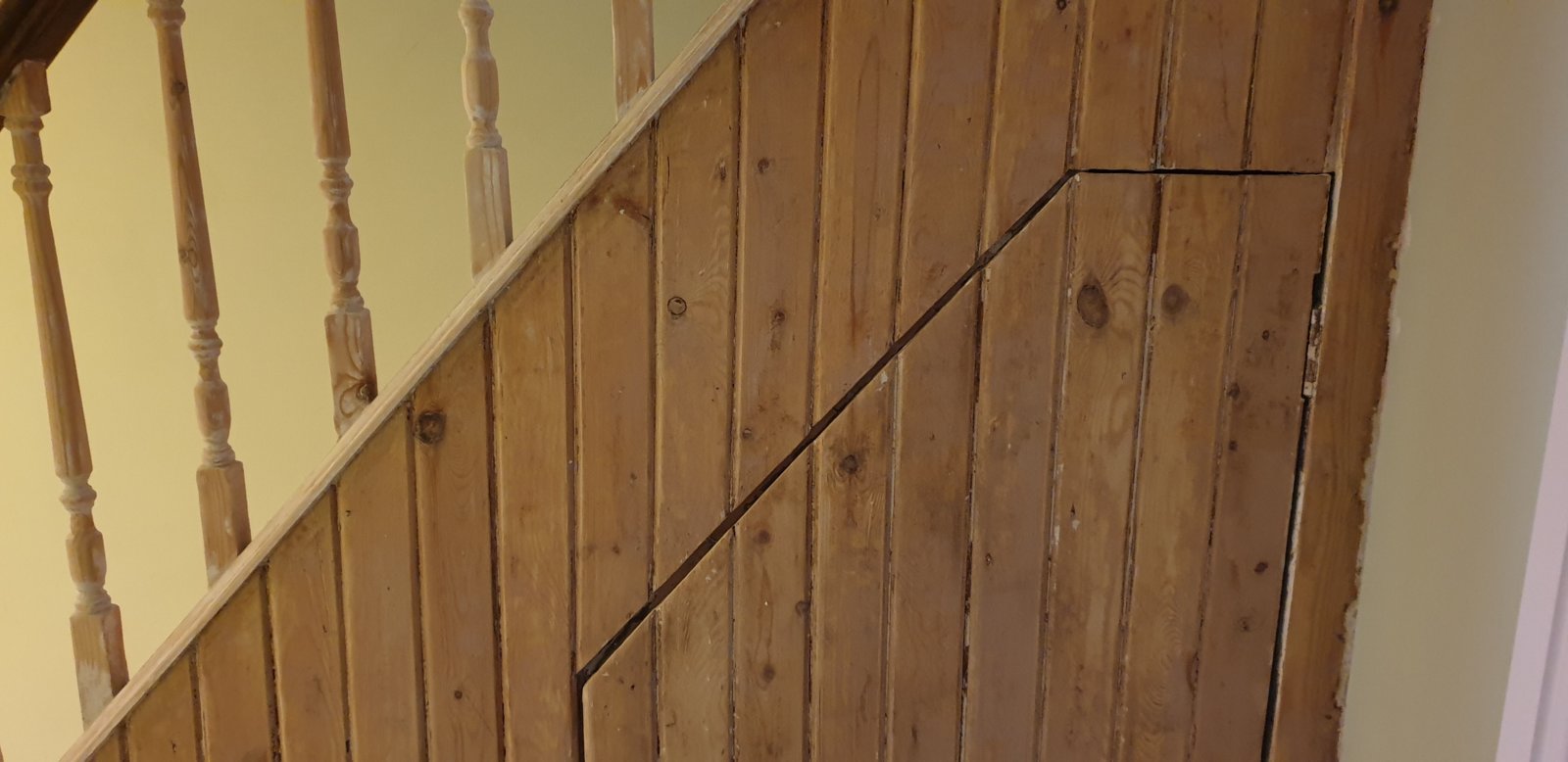

    Hello,
    I spent some time (highly understated) recently stripping old paint from staircases and now it's time to paint it.
    Since I know now how consuming is paint stripping I would rather not repeat the process so my question is simple:
    Would you recommend water based undercoat + water based paint (don't care too much about shine but given it's an old wood the are is not completely flat? Attaching a photo to give a better idea.
    Thanks for advice

    If you were going to use water based undercoat and topcoat, you would have to put an adhesion primer or knotting solution on all the knotts or they will just burn through the water based paint.
