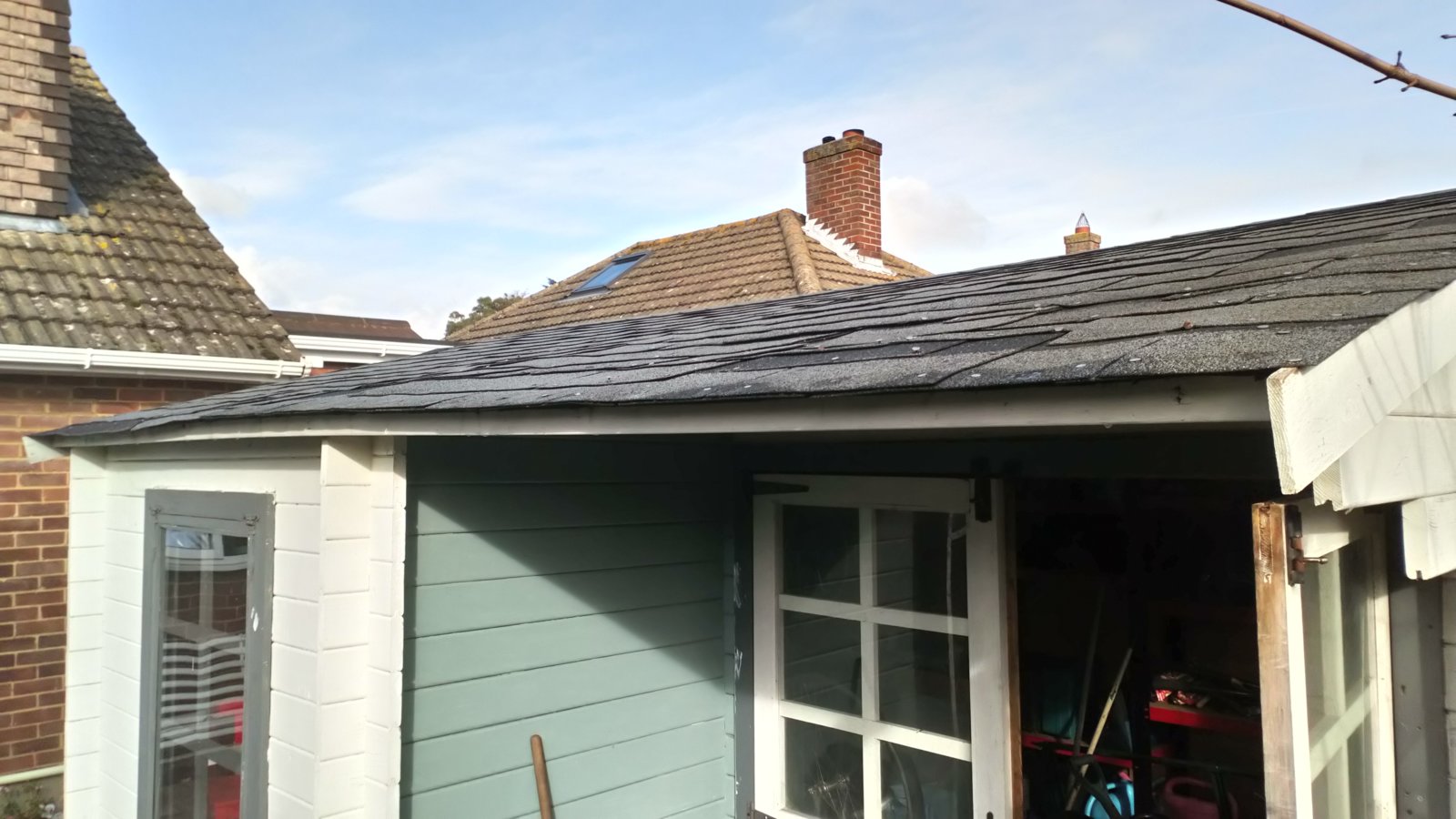

Wood guttering stop the wood just under the roof on this summerhouse from rotting. It's currently very wet. The wood the tiles are on.
I think it's coming under the tiles and back into wood and it's drenched.
Wrong type of covering for such a shallow pitch. Strip off and recover.
Yeah but the wood under the tiles is only wet at the bottom where the water is supposed to drip off. Guttering the answer?
No, cause the guttering won't touch anything so won't change anything.
