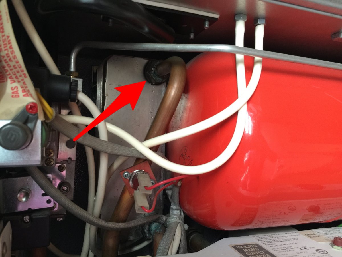

Hi, first post here, last time I went looking for DIY help with this boiler it was on newsgroups when they were once a thing!
Anyway,
I've discovered a leak coming from the area highlighted on the picture. Heating and hot water still working fine at the moment.
Looking for an opinion of what this part/repair involves, and a guesstimate of cost.
It's maybe time I get involved a boiler care/cover program. Cheers.
You could try to nip it up, if still leaky get a standard Avon fibre washer size 18.6x13.5x1.5. Manuf part number is 87161156800. Some come in a pack of 10.
