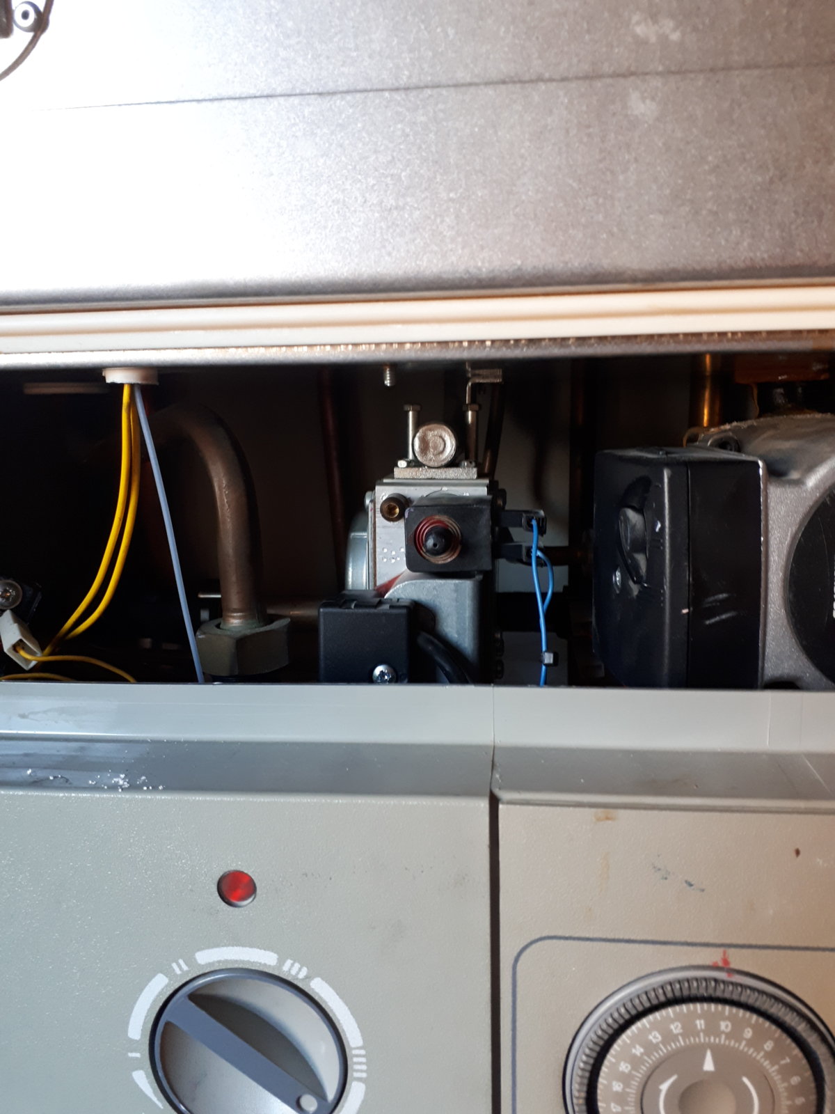

Hi folks, first time poster apologies if this has been asked before.
We have an old boiler (according to plumbers who've been round) which up until recently has been serving us well. Three years ago we went on holiday, turned boiler off. On return, it would tick but not ignite. We rang a friend of a friend who told me to whack a certain part a few times with a screwdriver, and turn it off and on. It worked!
Three years later, same thing has happened. But now, multiple times a day, there's no hot water and we have to turn the boiler off at the mains and back on. Most of the time it ignites. If it doesn't, we hit that part a few times and it comes back on. We're being told there might be a blockage somewhere.
The thing we have to hit, is the black bit in the centre of the picture.
Does anyone know what this part is , and whether it can be replaced? Rather than save for a new boiler, I'd obviously try this cheaper method of replacing parts :)
Thanks in advance!

Hi, it’s not a junior. It’s looks like a 28i rsf.
Pcb common to fault and have got many going with a wee tap to housing.

@AGAS In the picture I uploaded, there is a black circular thing with two blue wires attached. If when we restart the boiler, it doesn't ignite, we can hit that black part a few times on the side with a screwdriver, which seems to do the trick
Looks like the old WB 28i RSF combi as @McCombi mentioned, it doesn't have a pilot light. The part you are tapping is probably the solenoid on the gas valve and it's sticking, a few taps gets it moving.
It's needs to be replaced by a Gas Safe registered engineer, the part is around £100, plus the fit of course.
yes I agree with the others, replacement gas valve required and agree you do not have a pilot , what you are seeing is the main burner igniting, a pilot light is something different.

you can't get parts for these Worcester boilers any more,
Just about all the bits for this boiler are still available so they're fishing for a boiler swap. The question is whether it is economically viable to get the gas valve replaced and they should have been selling it to you on that point.
The black bit you are taping is not on the PCB, if it's on the gas valve with the 2 wires attached then it's the solenoid you are tapping.
You really need a good GSR engineer in though to check and confirm the solenoid is faulty and quote for the repair.
