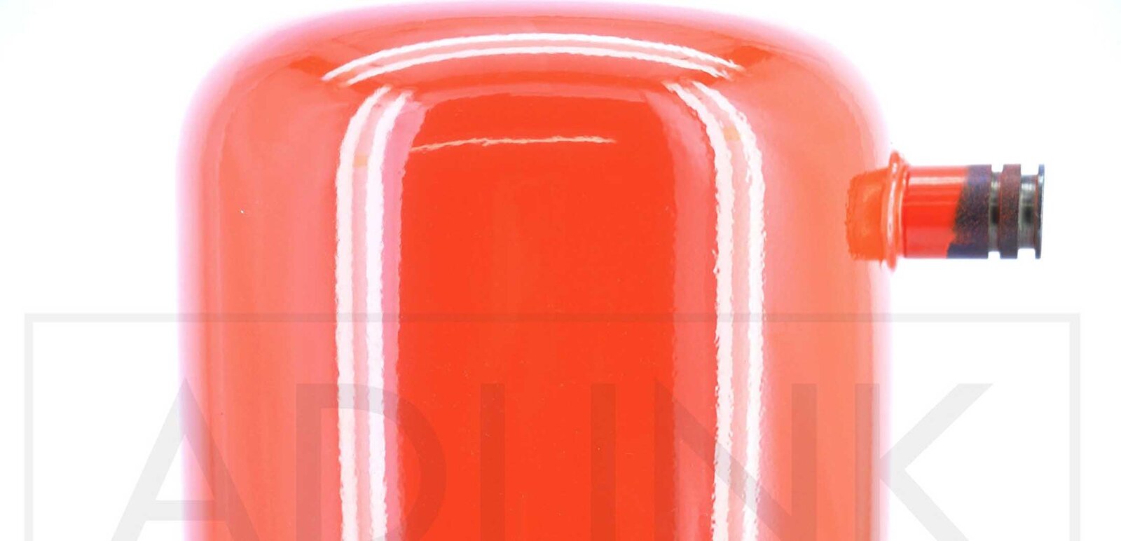

Hi there,
I have a worcester 350. The expansion vessel, part number 87161425060, is obsolete and I can't find anyone with stock.
So I need to fit an external vessel fitted instead. The size is 10 litres and there are plenty to choose from. Easy enough.
However, the original expansion fitting into the 350 boiler is a push fit tube with an O-ring.
Can anyone tell me how the entry to the boiler can be blanked off so the tank can be removed?
Or tell me if there is another expansion vessel for a worcester that fits this way, that can be used as an alternative to an external vessel?
Thanks in advance.

I did think of that, but the vessel is leaking a bit through the schrader valve. Not much, but it can only get worse. All that holds back the leak is the plastic cap on the schrader. I could seal it with something, but when the diaphragm eventually lets the full system pressure into the air space, I'm worried the cap would just pop off.

If it's only a temporary fix until Spring, take yourself down to the local Halfords and buy a new Schraeder valve core and a removal tool. Replace the valve core and that should cure the leak, then stick an external vessel on it somewhere. The diaphragm will be split, might only be a small split, but I very much doubt that it's just porous.

Yep cap is the same thread. And by coincidence I happen to have metal caps on a classic car I have. I'd forgotten. Put one on the x vessel today with a bjt of ptfe for extra sealing. Bit of soapy water now not showing any bubbles. Next job is to put an external vessel in the system.

Re-pressurised the x vessel, metal cap on, and pressure holding. Shrader valve is leaking a bit, but the metal cap with a bit of ptfe (belt and braces) has done the job.
Interestingly, although initially there was a little water ejected from the shrader, now only air is expelled. So even though the diaphragm must be leaking for water to come out, it must be a very small leak.
