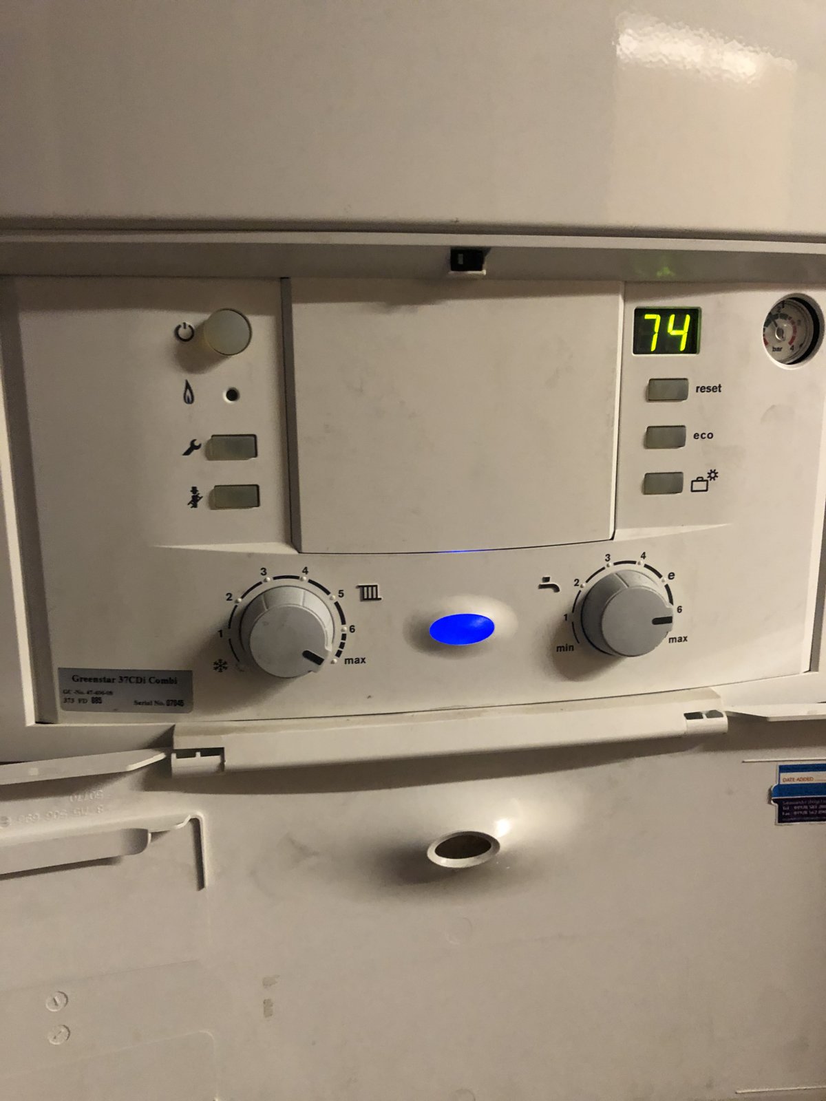

The boiler is in the garage and the RC plus is currently in the living room on a table not near any heat.

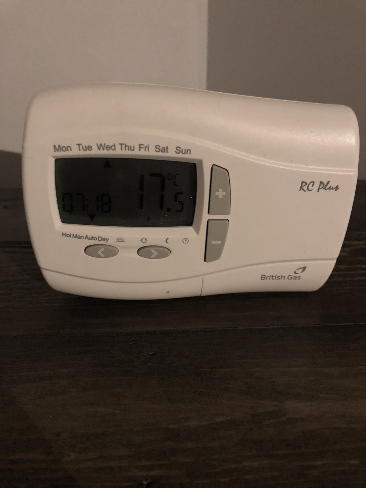

This is the control it was set for 23.5 it’s only got to 17.5 this morning

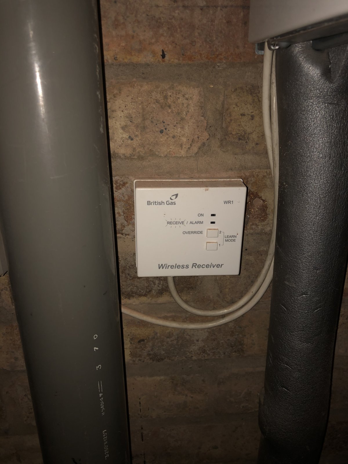

Receiver

The next step is to start looking at radiator sizes and heat loss calcs for the property to make sure you have enough horses under the hood!

The heating last night was on from 3.30 till 10 and reached 22

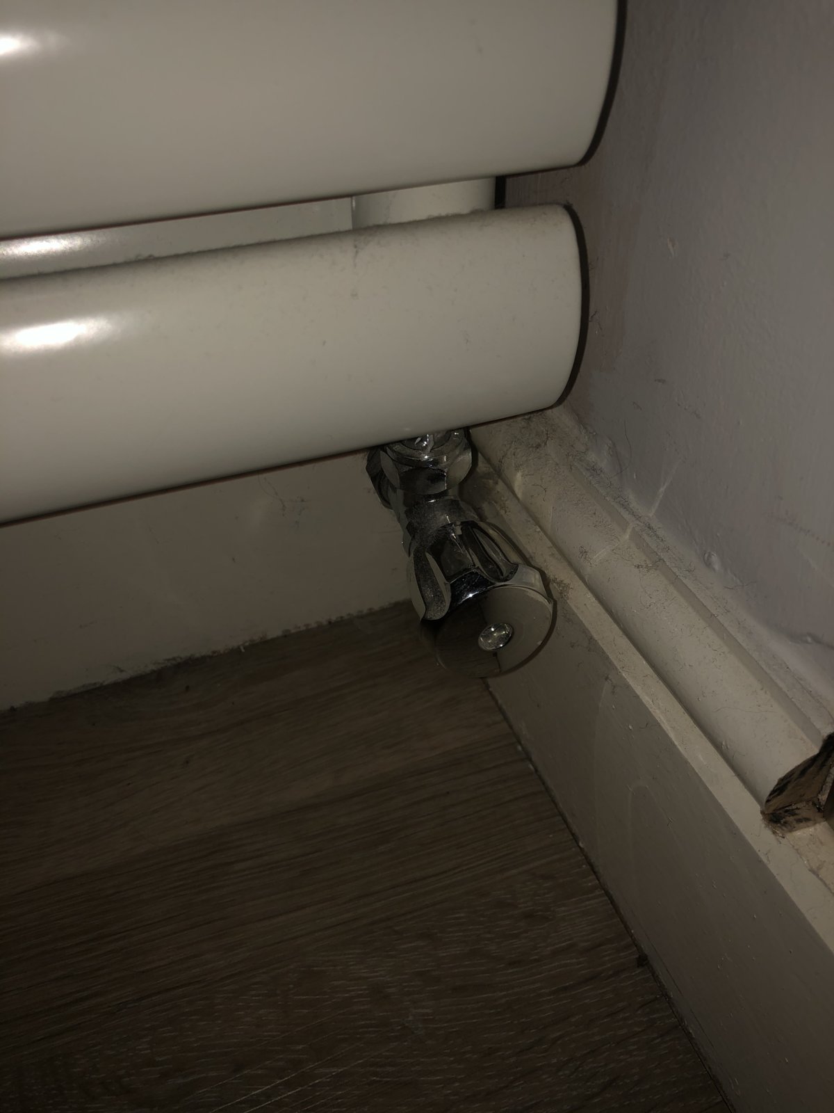

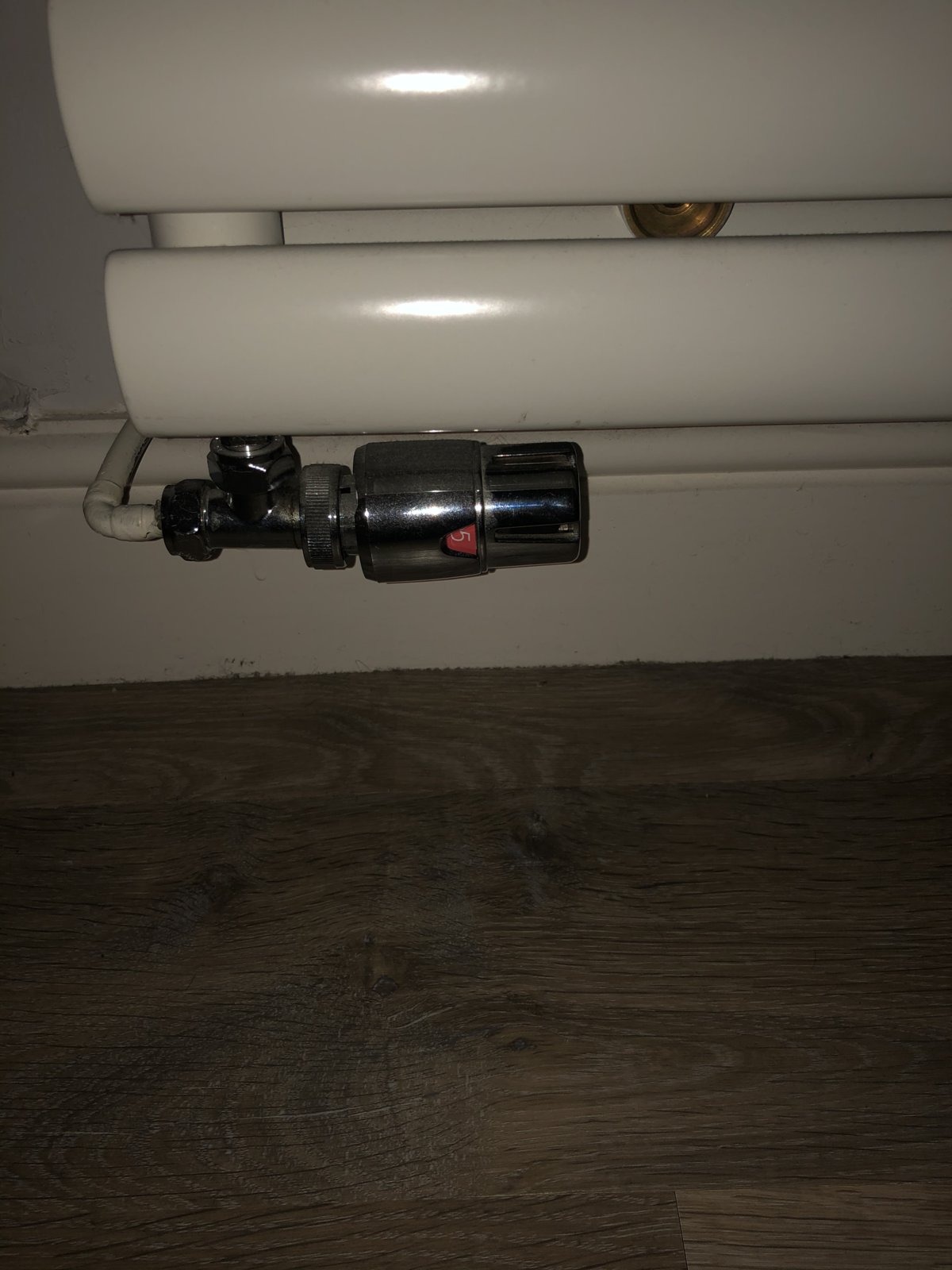

This is control in the lounge
First picture above. That's a TRV, unscrew the top part (head) and take it off the rad.
It may be closing the rad down before the room gets to the temp you are looking for.
There should be no TRVs on rads in the room where the roomstat is located/kept.
