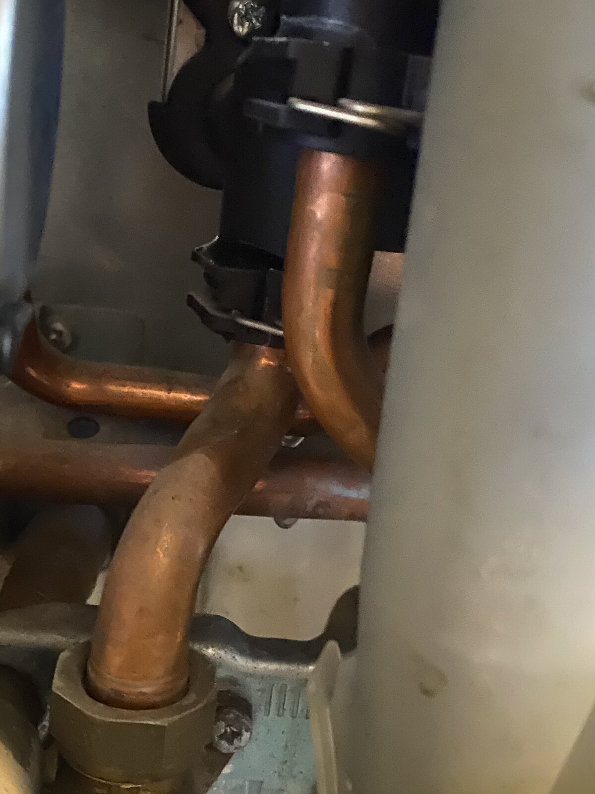

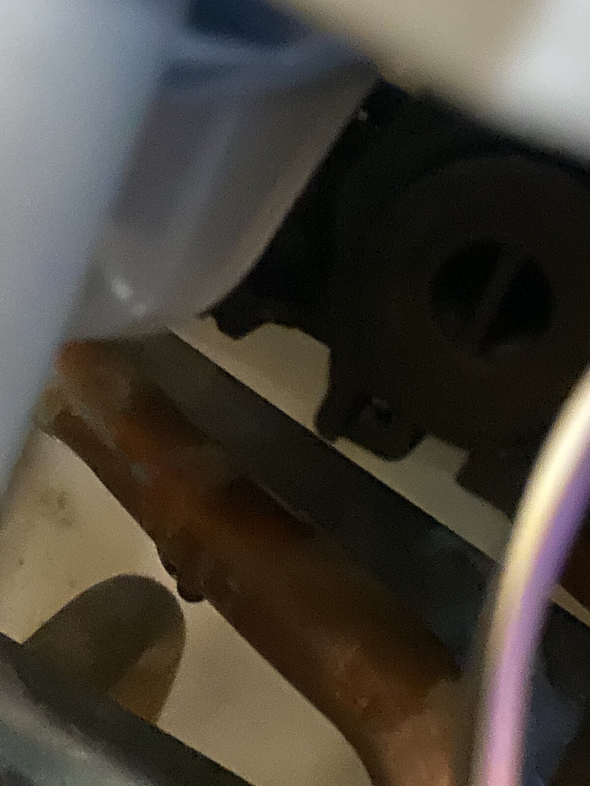

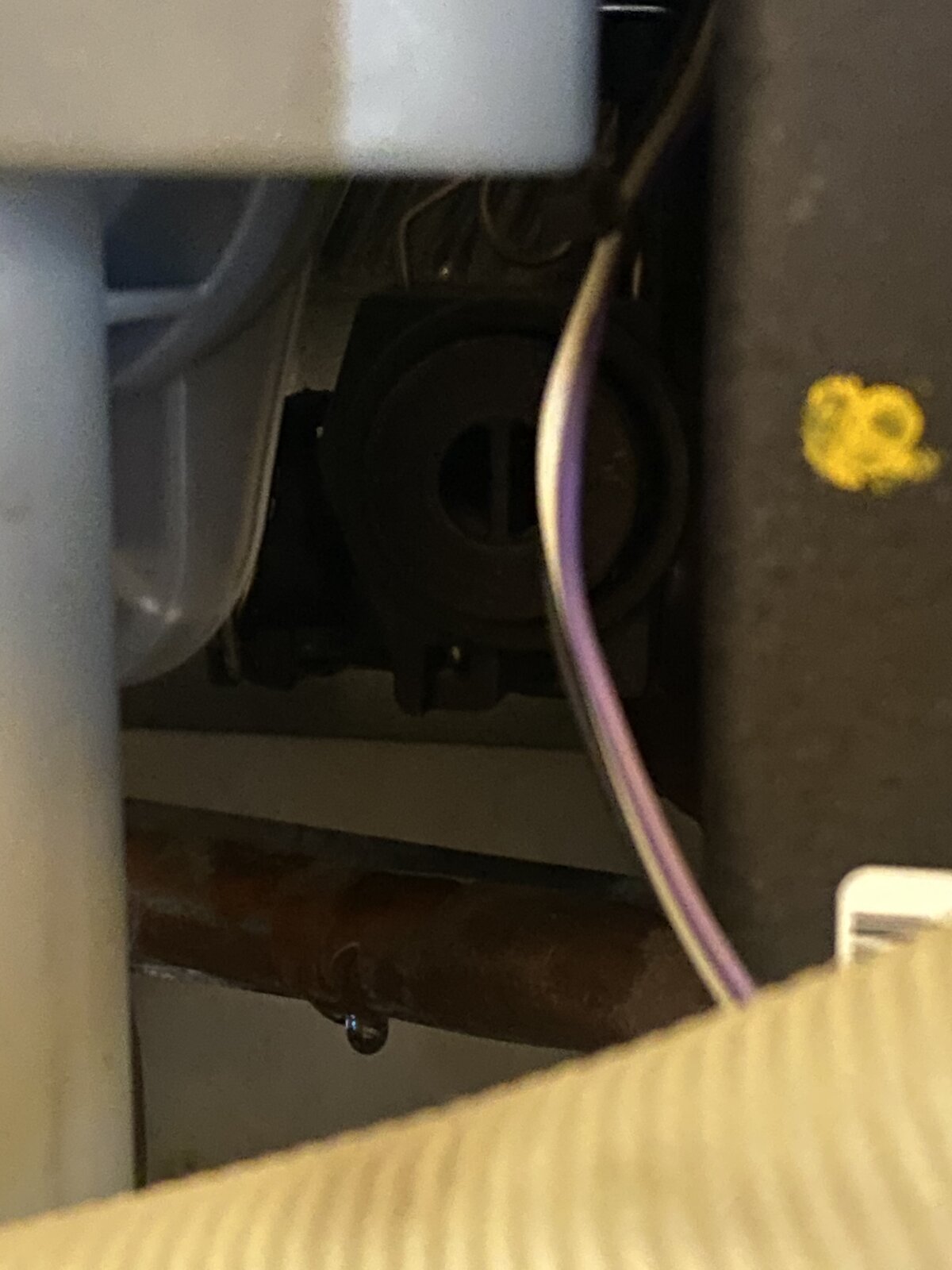

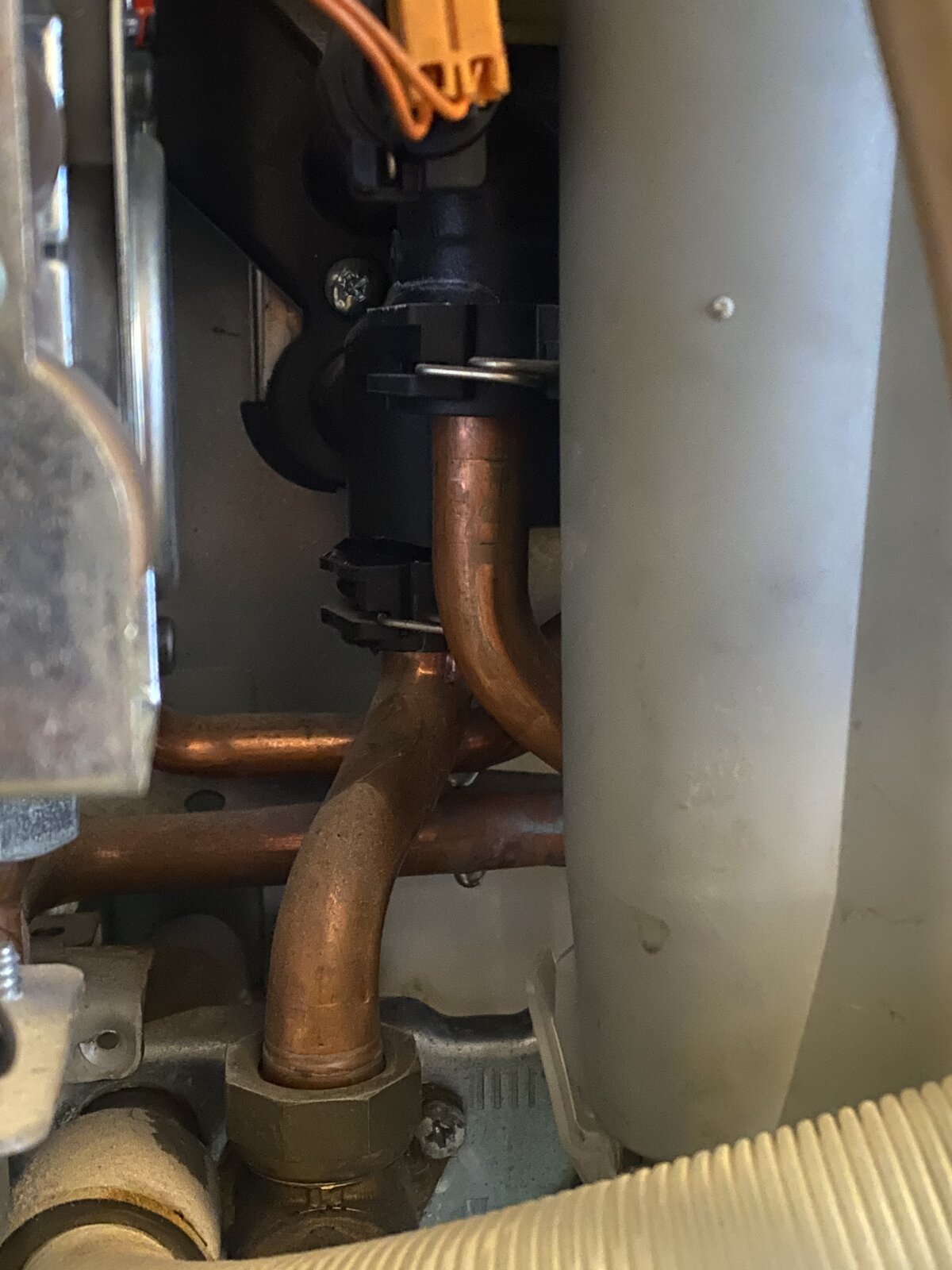

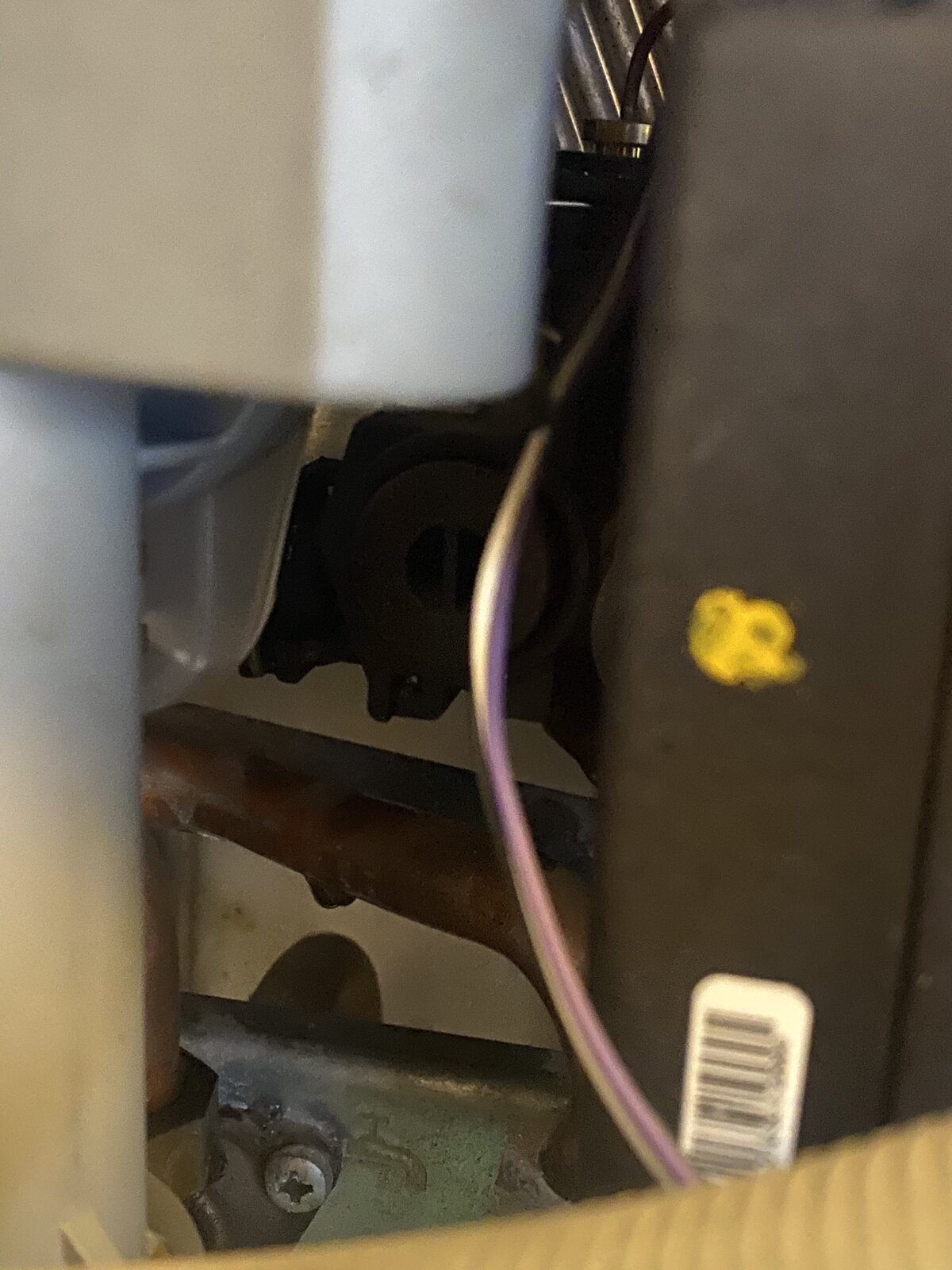

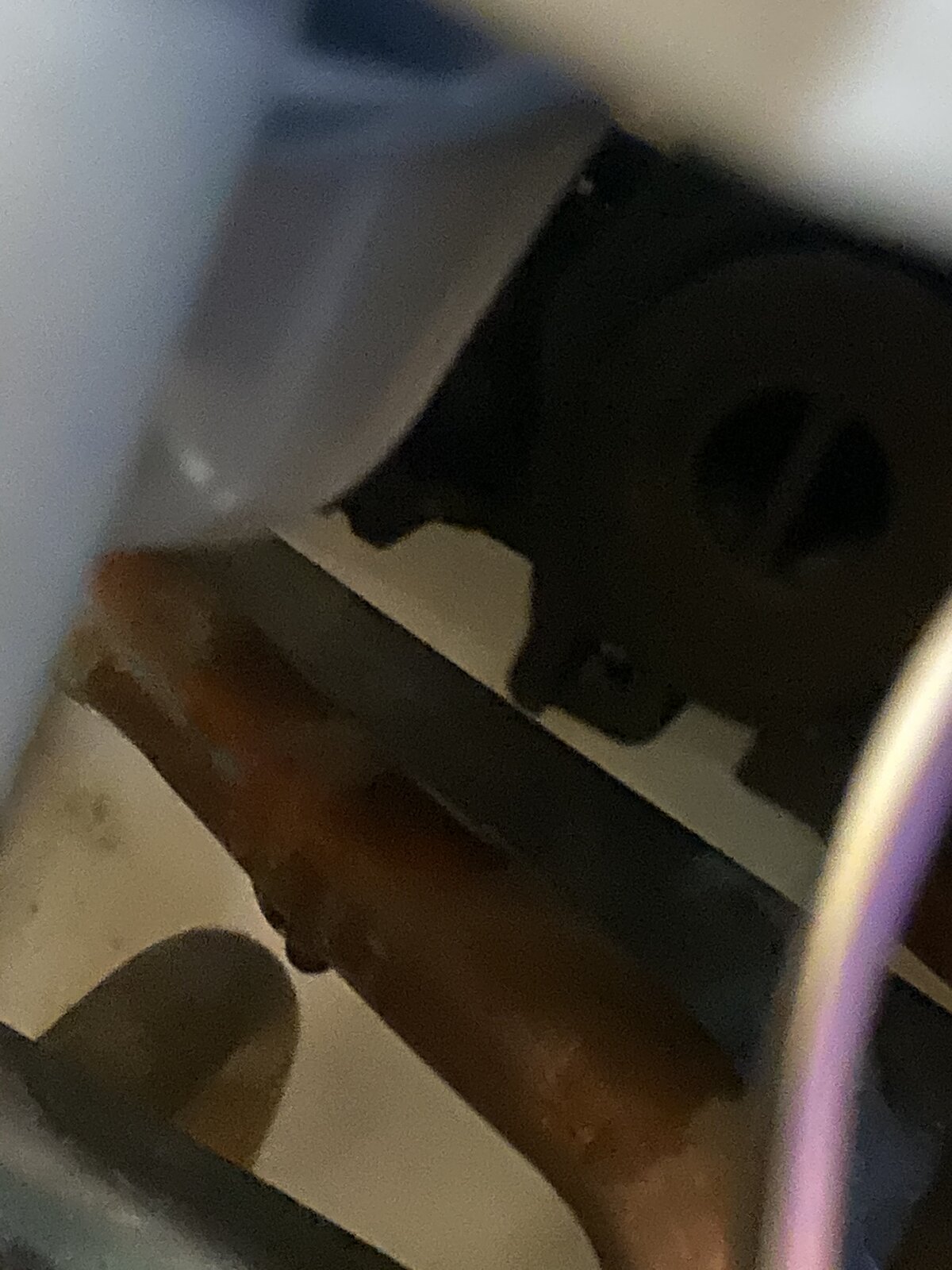

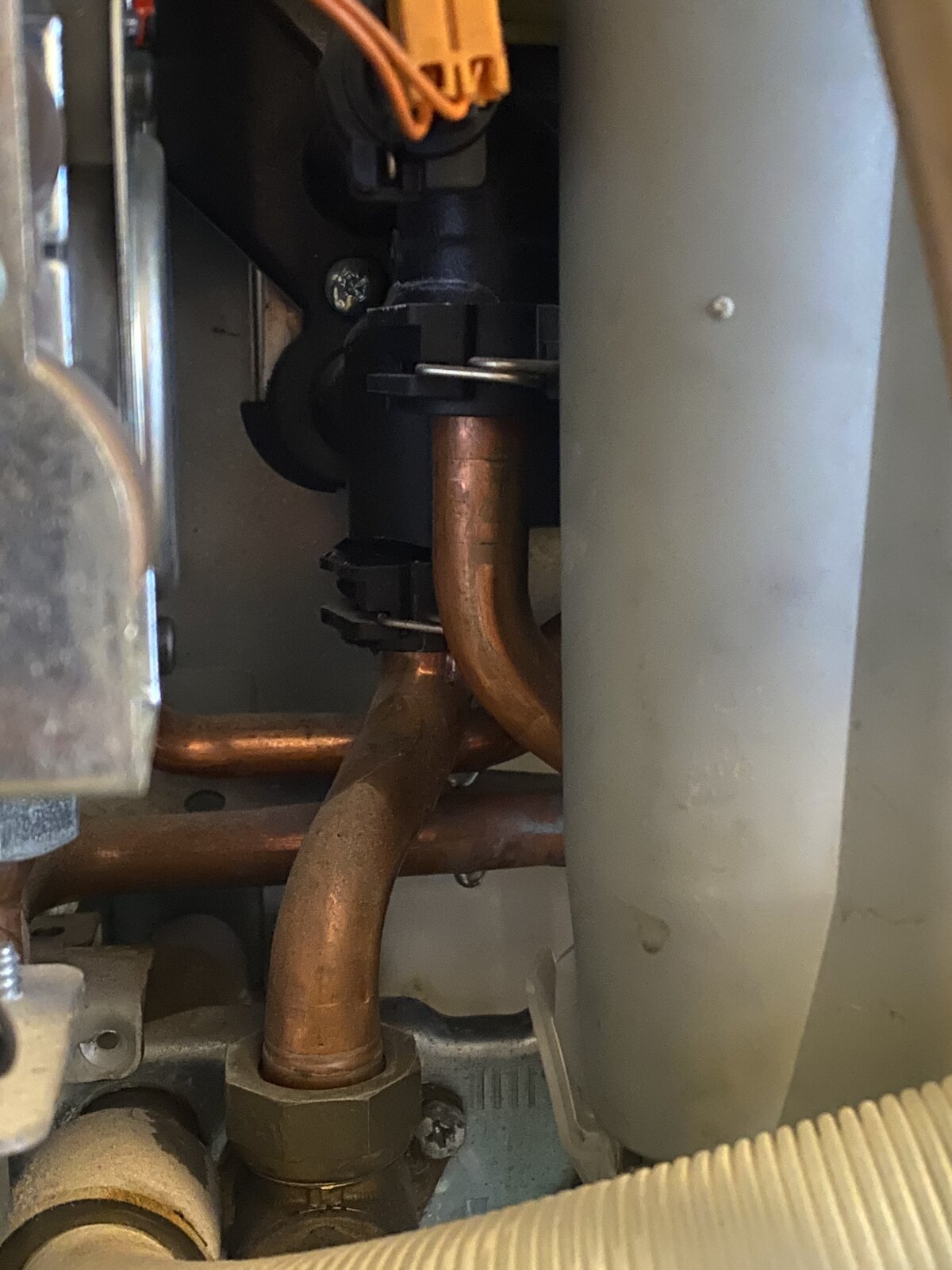

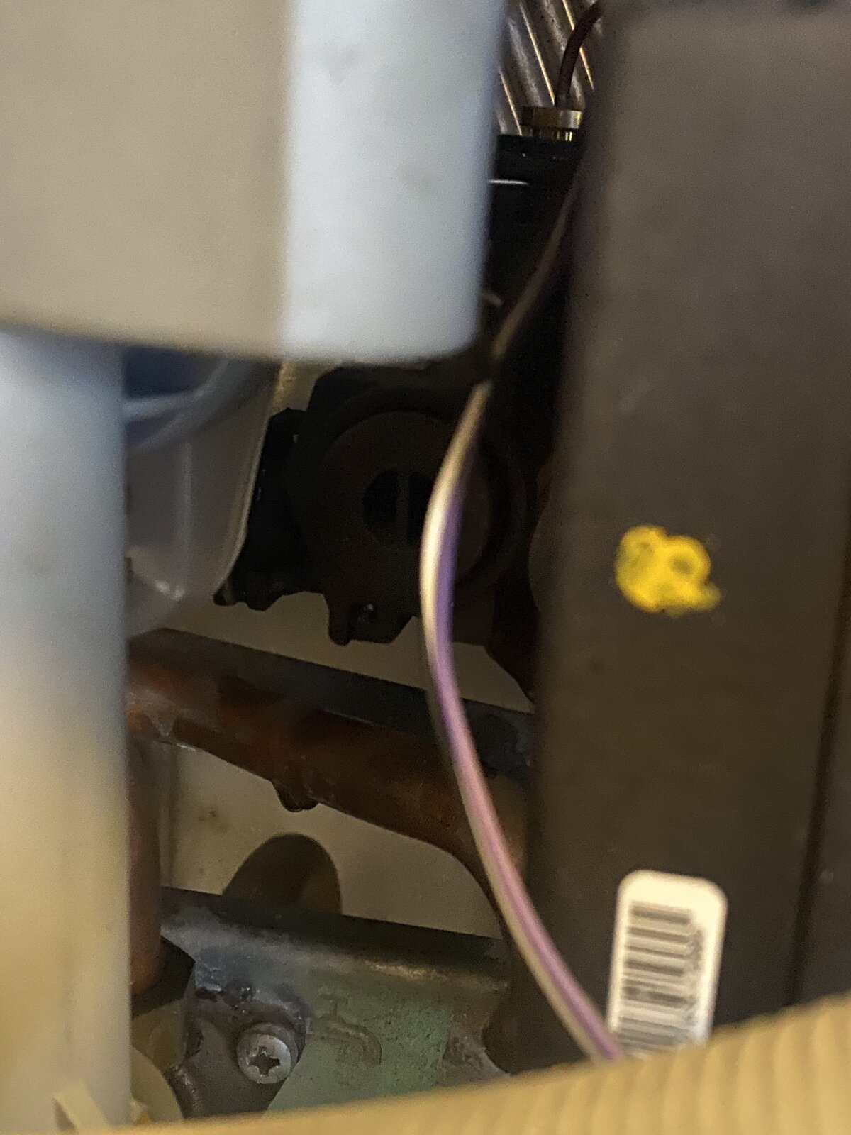

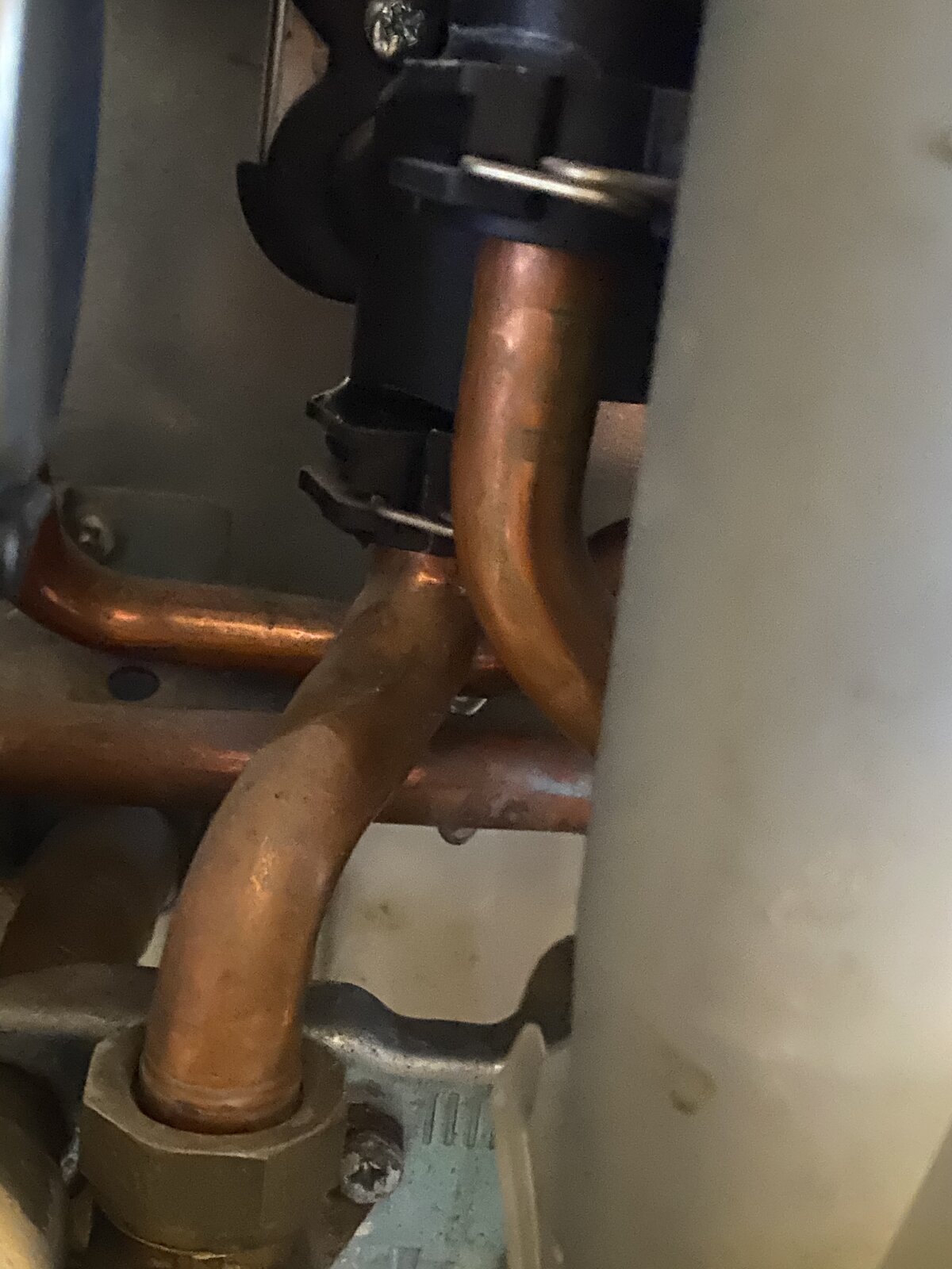

Hi all
Started to get a leak from underneath this boiler last few days. The pressure isn’t dropping on the system so assume it’s the inlet that’s leaking. Water is clear-ish as well.
I’ve opened it up and taken some pics of the leak below to see where the leak is coming from. Any advice appreciated thanks.

Looks like a leak on a hydroblock, and will need a 26.9 safety check (performed by a competent person, usually a gas safe registered engineer) after removing the cover on that boiler.
Thanks Chris. A few months before this issue, I noticed that the boiler would like vibrate for a bit when running hot water. Then after a few seconds it would stop when the tap was opened a lot more. Not sure if the two are linked. Will contact an engineer.
Got the part changed but the vibrating random noise is still there when using hot water / and nkw when heating is on. Does anyone know what’s causing this? The water pressure is good in my area and the boiler pressure is at 1bar...
