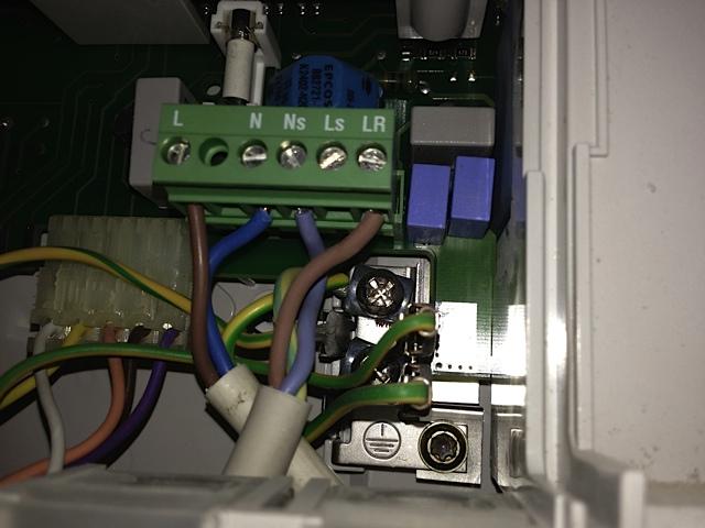

Hi - my 40Cdi has a wireless optimiser thermostat. I want to replace this with a fixed hard wired thermostat. I presume that this only needs 3 wires - one of those being an earth - so essentially 2 wires. Which terminals should these two wires go to inside the boiler?
Seems like I have a choice of Ns, Ls and LR
The wire you see is for my underfloor heating. That comes in from a separate wiring centre. I'm not sure it's actually wired correctly, as at the moment, I have to have the wireless thermostat on and the u/f on for both to work. They won't work independent of each other (as they should ideally). If anyone can tell me how that should be wired, that would be helpful.

You would need to trace the wiring from the wiring centre to connect a stat to the ufh, the wiring you have posted a picture of is the switched live probably from a couple of 2 port valves.

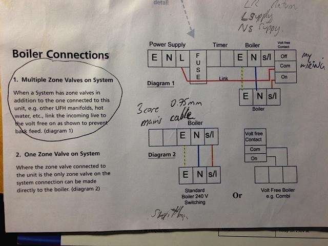

No problem Matt - here is a picture of the u/f heating wiring centre side.
The following images show the wiring centre and its diagram. It's wired exactly as shown. The connection to the boiler is as in Diagram 1 at the bottom. So it says to wire to N and s/l - unfortunately my boiler doesn't have s/l, it has Ns, Ls and LR. Hence my confusion ever since I installed it years ago. Worcester didn't want to help me, nor did Polyplumb.
So the underfloor is only in one room and has its own thermostat, pump, two way valve, wiring centre etc. Then is has one wire going from the wiring centre to the boiler. This is currently connected to Ns and LR. Which kind of works - but not properly - as I cannot run the heating and u/f separately.

It does, your ufh is wired ok (well you dont actually need the N back to the boiler)
S/L = LR btw
I should have added. The rads are supplied direct from the boiler. So it has its own internal pump etc. there are no other external valves on the circuit.
and there is where your problem lies, you will need to add one to the rad circuit if you want to run the systems independently
for now though it may be better to connect the new stat to control the boiler and disconnect the call for heat from the ufh controller
that way the new stat would control the rads and the underfloor would still be controlled via its own stat (but still only when the rads are on)
as said you will need to instal a valve if you want to do it right

a separate zone valve, of course this may not be easy as it depends on your rad pipe layout with respect to your under floor manifold
When you say disconnect the call for heat on the ugh, what does that mean exactly
I mean disconnect the wiring to the boiler from the underfloor heating controller
- sorry, I'm not great with the correct terminology (half my problem of being an amateur who likes to tinker with his electrics). If you are saying that I need to add a valve to the rad circuit - I don't see exactly how that would help. Surely I just need the ufh to tell the boiler to fire up. Which, in my head is the same as adding a new thermostat, which also will tell the boiler to fire up (hopefully)i.e. they do the same thing, but when the ufh does it, then its valve also opens, flowing water round its circuit.
yes they will do the same thing but in your above reasoning you are forgetting that if the underfloor controller does it then the rads will also get hot and your new stat will be rendered inoperable as it will be overridden by the underfloor stat
Is that the way you want it to work? then wire the new stat to Lr, Ls (and Ns if the neutral is req) and leave the connection from the underfloor heating in

I just found the installation instructions for the boiler. This is where the confusion has always been. The 40Cdi want you to have 3 wires from your thermostat/programmer.
My underfloor heating exports two wires. Not three.
I would have thought a thermostat normally only has two wires - it's a simple switch, either open or closed. But maybe I'm wrong.
My thinking as a simple layman, is if I connect A+B then the boiler should fire up. I shouldn't need to connect A+B+C to do that. Therefore, I should be able to connect my N and s/l wires from my UFH to my existing boiler and when the UFH demands heating, the boiler should fire up. How I have it wired at the moment doesn't allow that.
sure, this will mean that my ufh thermostat is controlling the whole house - I understand that. But I can solve that problem later on. At this moment in time, I simply want to get one wired stat to fire the boiler on demand.

the boilers two wire stat connection terminals are Ls and Lr
do not connect a 2 wire stat to Ns & Ls under any circumstances
