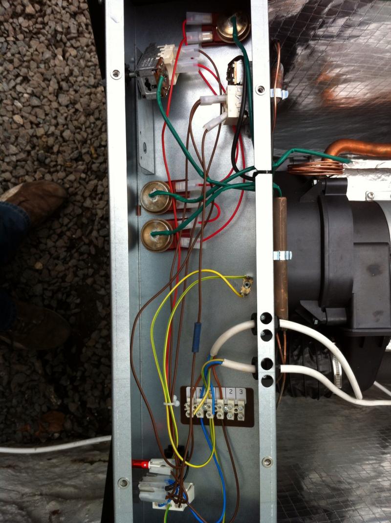

Just had a new boiler installed. If its all wired correctly, should the neon light under the cover outside be permanently on regardless of whether heat is being called for?

Sorry, still not following.
I had a new boiler installed and I wasn't happy because the boiler had no permanent live for frost protection. I've had him back today and he has now added a live. But suspect he's wired the live and switched live the wrong way round.
The neon light is always on and the boiler is constantly firing up even though its 12 degrees outside. The pumps not running so I think it's just heating the boiler up to temperature and the turning off?
The permanent live goes to S as opposed to L?
I'll add some photos of before and after.

well thats how its supposed to work if it's wired correctly anyway
No.
Permanent live should go to L (ive)
Switched Live should go to S (witched)
Pretty obvious really
I'll have a look at photos later as getting ready to go out but it does sound as though its been ballsed up
