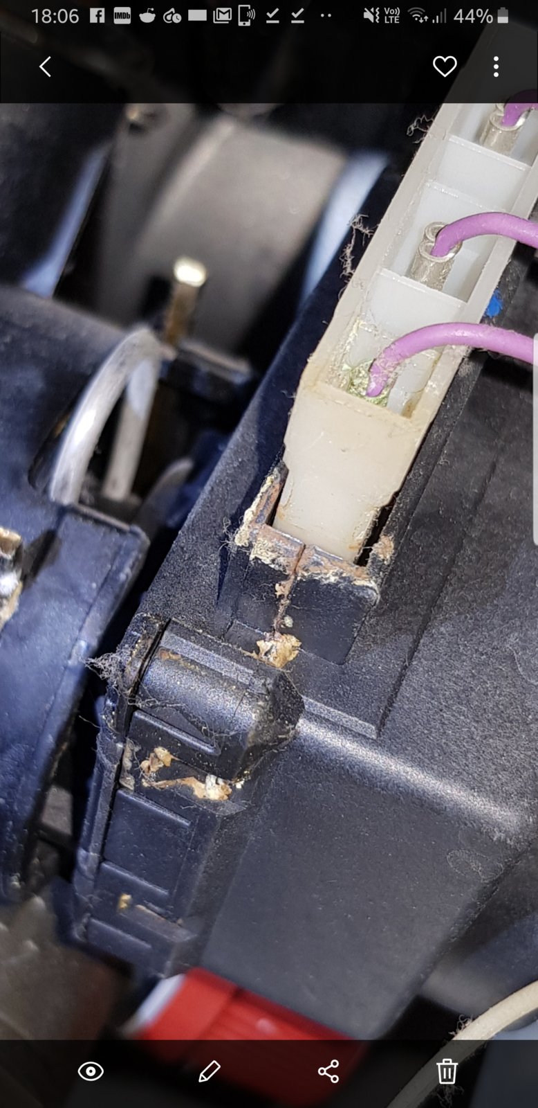

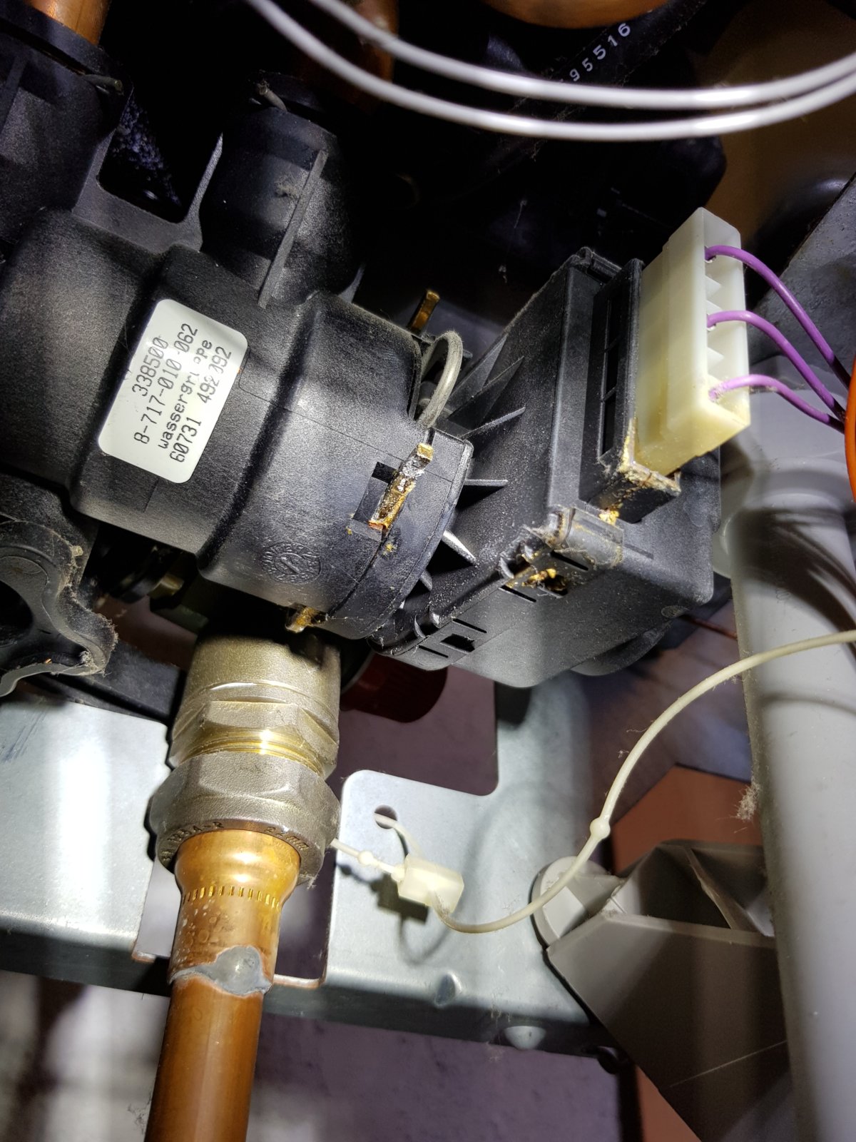

On what I think is diverter or three way valve :
Evidence of Liquid exiting an electrical actuator seems like we might have a leak in that valve body somewhere?
Yes it looks like the valve has leaked evident by the scale but it looks like that's a 24v AC motor head which is very unusual so I wouldn't think it would cause the fuse spur/plugtop 3 amp fuse to blow. A waterlogged 240v AC motor head will always cause problems if waterlogged.
Pop the retaining clip out and have a look.
