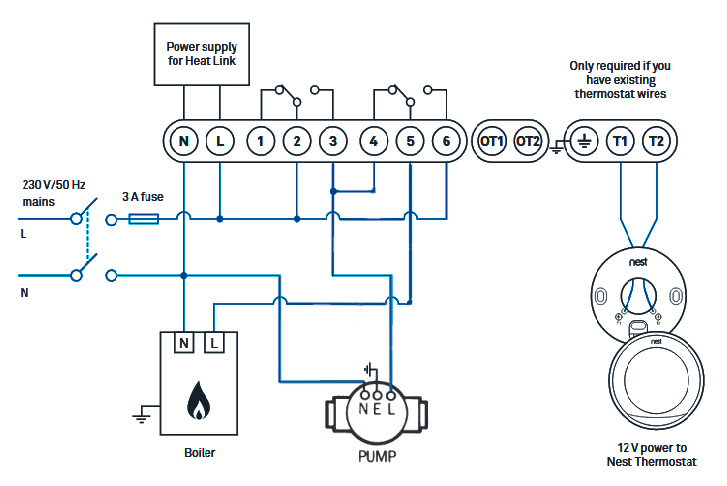

The manual says that on a gravity hot water system the programmer must be set to "G" because the system will only function correctly on heating if the hot water programme is also on at the same time. It says fully independent CH and HW programming is only for fully pumped systems.
This made me wonder whether the Nest installation may be treating the system as if it were a modern fully pumped setup.

- Nest fitted soon after I moved in, replacing/bypassing the original Worcester programmer.
- Hot water and heating are both controlled by Nest.

Important detail I recently found in the Worcester manual:
Questions:
- Could a Nest installation on a gravity hot water Danesmoor cause this type of burner lockout behaviour?
- Has anyone seen problems caused by replacing the original gravity-system programmer logic with Nest?
- Does the fact that the burner only resets reliably after cooling point more towards a burner fault (control box, ignition transformer, electrodes, etc.) rather than a controls issue?
- Would it be worth testing with hot water permanently enabled for a few days to see if the problem disappears?
