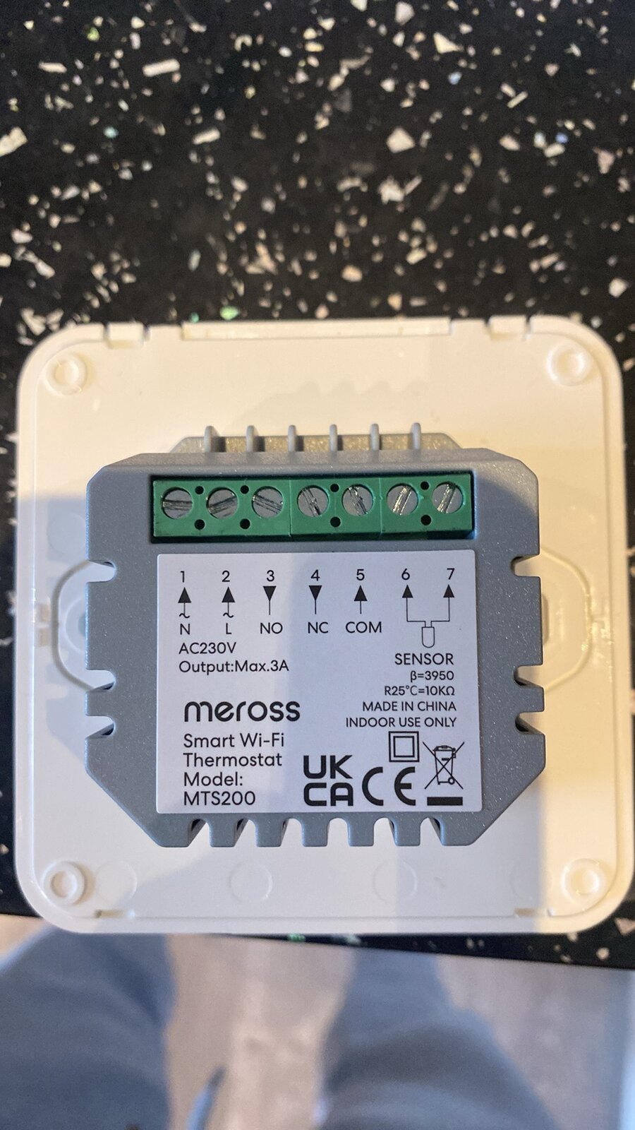

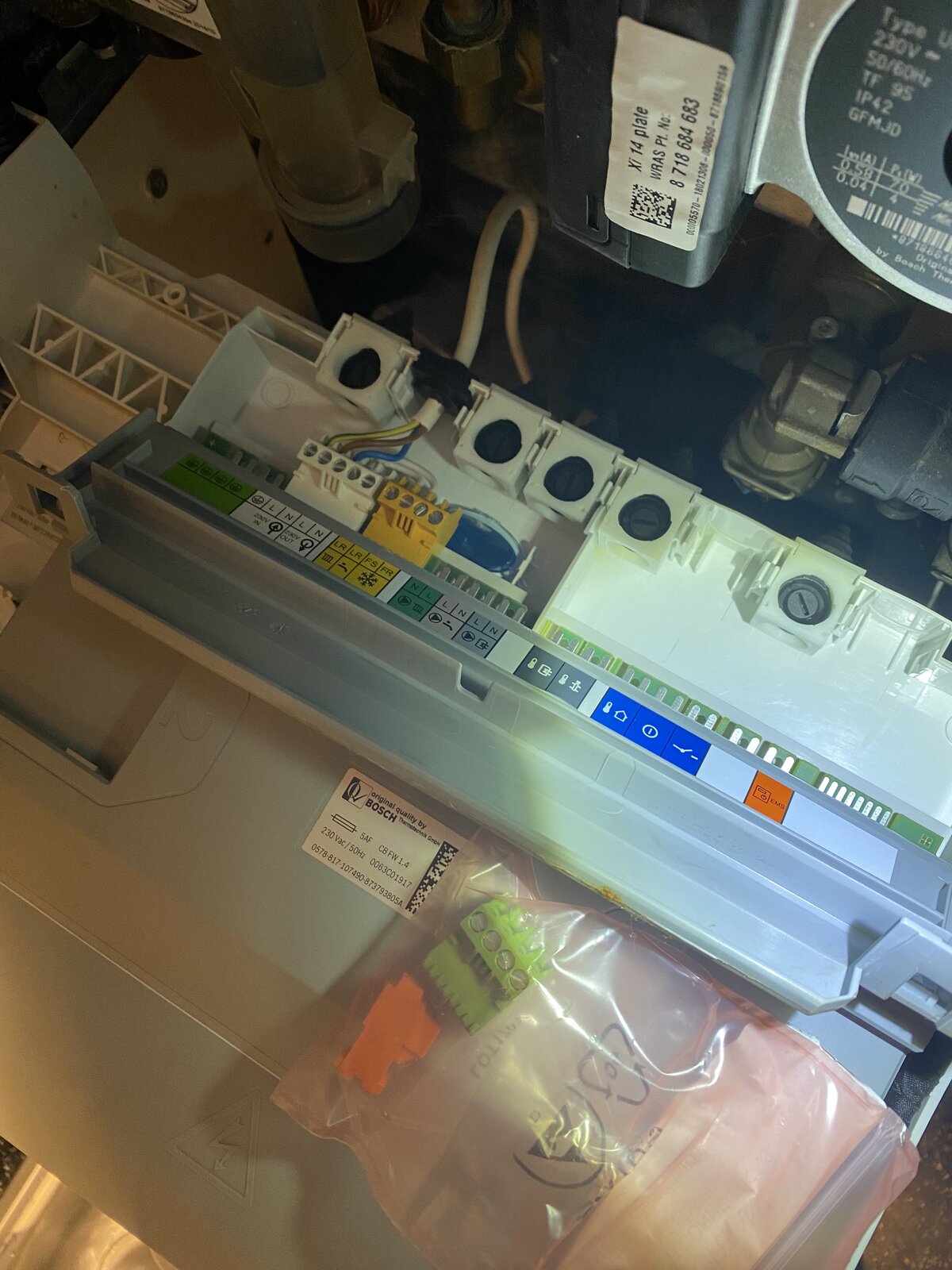

Hi all, as per title I have a Worcester Greenstar 30i boiler that doesn’t have a thermostat installed, just the MT10 timer.
I’ve bought a Meross MTS200 Smart Thermostat.
I am not 100% on the wiring so would this be correct: (Remove link from LR)
L from the thermostat to L on the boiler.
N from the thermostat to N on the boiler.
NO from the thermostat to LR on the boiler.
The sensor in 6+7 (then where does the end of the sensor go?)
And there is a little link cable supplied with the thermostat, I’ve seen people on other posts putting that between COM and L on the thermostat, is that required/correct?
What cable should be used?
Please see pics attached.
Thanks in advance!!
Link L to Com at thermostat and these three wires used
plus the earth. The sensor is not required in the boiler version, there are three versions of that thermostat.
