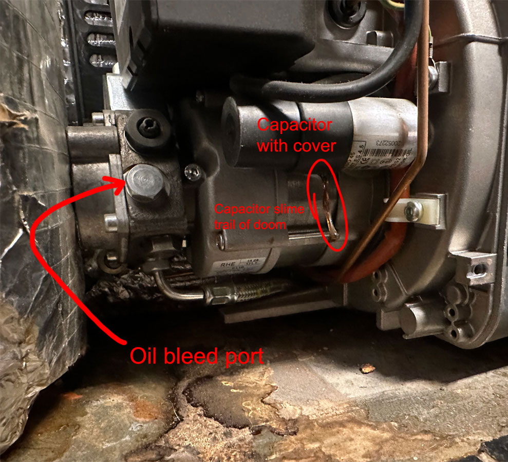

Worcester Heatslave oil boiler - lockout after draining and refilling system. Can't figure out why.

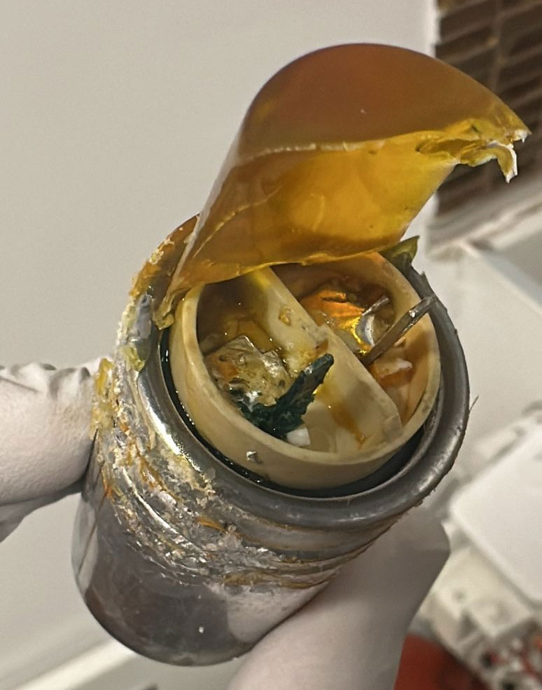

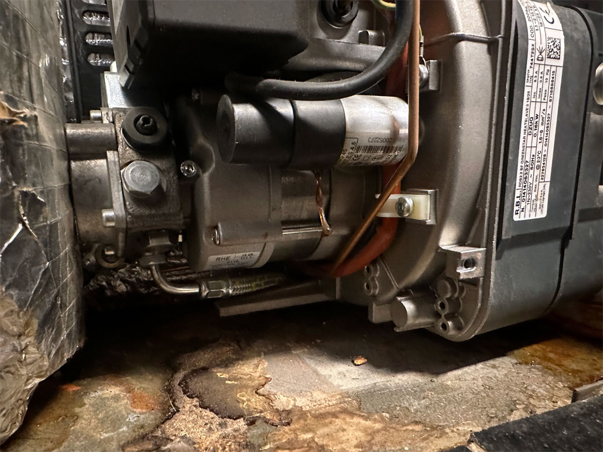

Update: bought a replacement control box and fitted it. Boiler fired up first time. Seems to be running OK now.
The old control box presumably failed in some way, although visually it looks pristine. I assume something on the PCB got fried when the capacitor leaked. I probably didn't need to replace the fan motor, but will keep the old one as a spare.

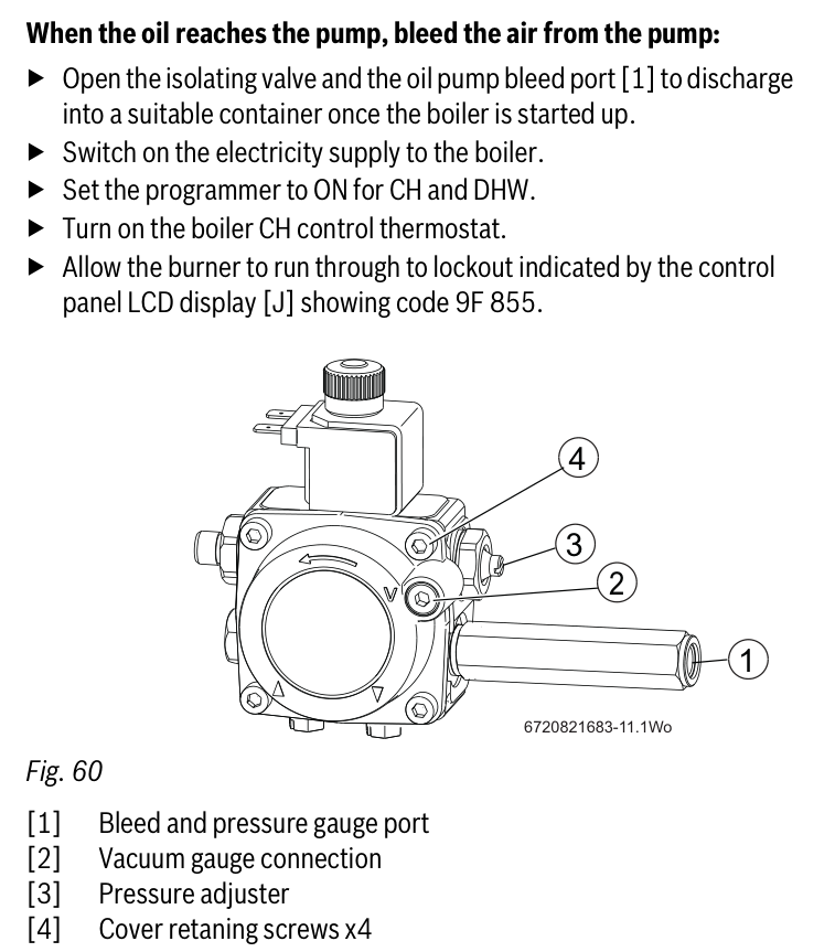

1. Fault Diagnosis
So your boiler has a burner lockout fault. In my case it was 9F 855. Others have 8F 855 or similar. Most tutorials indicate that this is a fault with the oil feed and advise bleeding air out the oil line or replacing the pump. However you might have a different burner-related fault.
Take a look at the front of the Riello RDB burner. The central reset button doubles as an LED which can flash fault codes. These flashes can tell you what type of error the burner is experiencing. In my case, it was flashing red and orange which indicated a fan motor error.
You can look up the fault code patterns in:
- Your boiler's installation manual [1]
- The Riello manual for your specific burner [2]
- A Riello fault finding diagram for your burner [3]
The manuals also suggest tests you can perform with a multimeter, e.g. ensuring the correct resistance across the motor wires or the capacitor etc. (however in my case these were all correct despite the control box being faulty).

Next, remove the motor capacitor. (Not pictured.)
Pull off the black plastic cap, and carefully remove the two spade terminals. If you can, discharge the capacitor by bridging the two terminals with the metal tip of an insulated screwdriver. Then unscrew the capacitor from its mounting point.
Note: the capacitor is non-polarised i.e. it doesn't matter which side of the capacitor each wire goes in.
