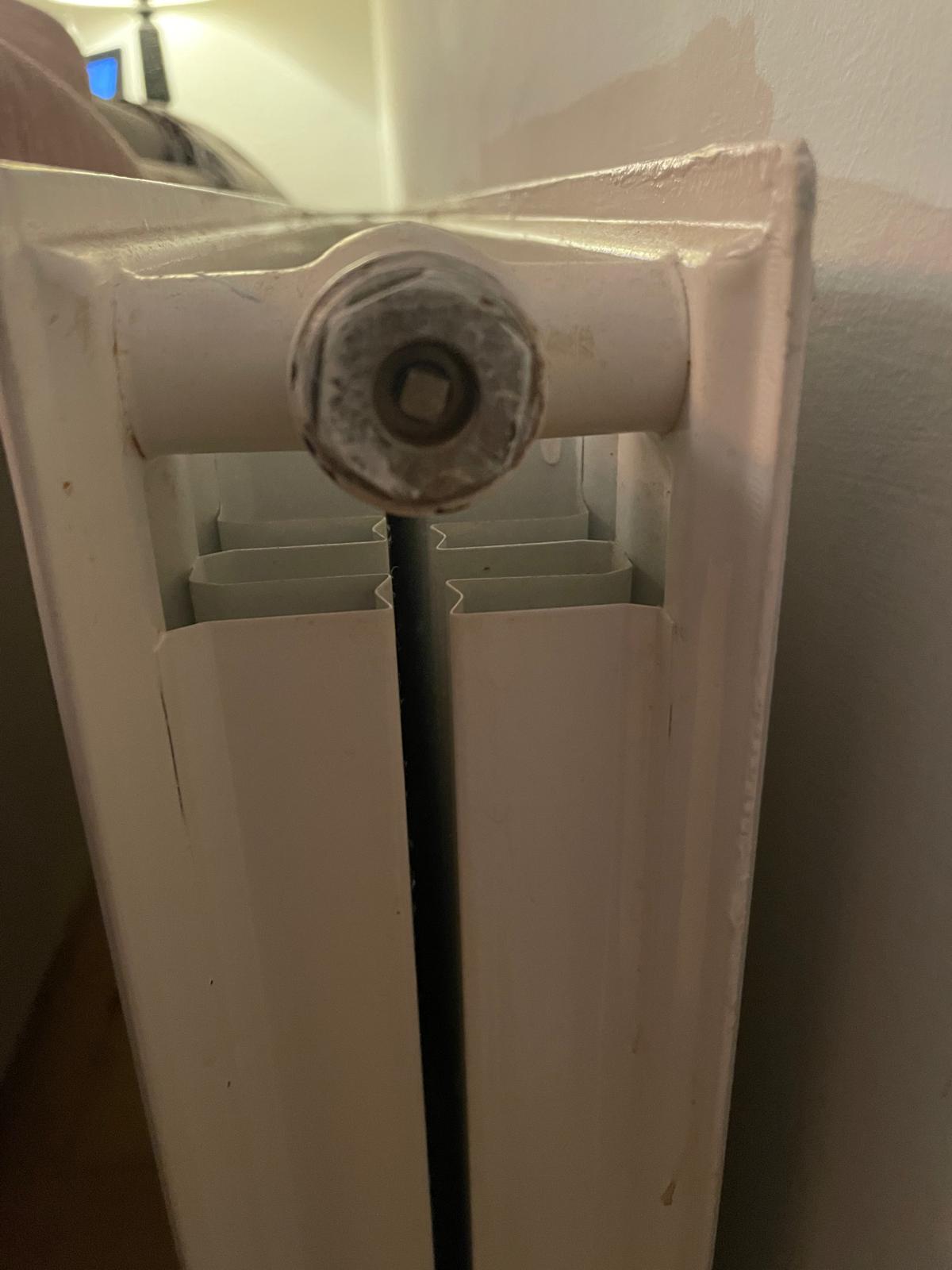

Our radiators are really old. How do you bleed air out? Any video link you can share?

Also, how do I bleed air from this radiator.

Video link isn’t working. You use a radiator bleed key, insert into that and turn anti-clockwise until water is present, and do this to all first floor radiators, but I must agree with @Jurassicspark - get BG to fix the issue rather than charge you to tell you what’s the fault is for you to fix. Unless you don’t have that level of cover? Are you sure it’s the boiler making noise? Could it be a faulty tap or toilet float valve?
