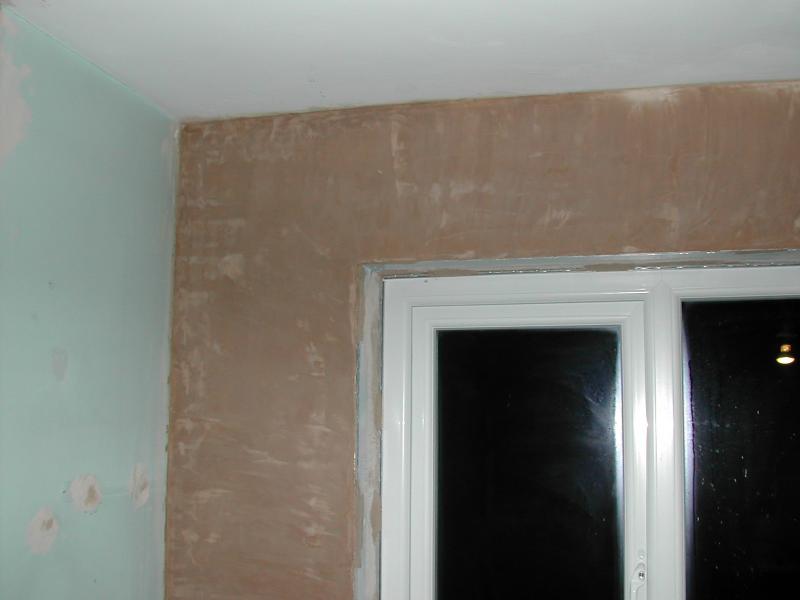

I was doing a spot of plastering last night after work, and Micilin's comment
made me think.
From looking at the pic from last night's wall, is this a high level of fat?
It is reasonably flat, tho I wouldn't say perfect, but there are no obvious trowel marks.
Always keen to improve! :D

As long as it's flat, no problem. You'll find that the fat might shrink a bit, or if it is used to fill a biggish hole, you can pick at it with a finger . Don't worry about it too much, your wall looks fine and you'll get a few different shades as it dries anyway.

Get over it earlier and keep your trowel flatter so you fill them.
