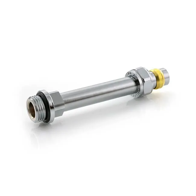

Would you like to fit a radiator without using PTFE tape
Good to know, could still be achievable with a fixed tail , one top and one bottom
Bl00dy hell you're planning TBOE as well!? That's got us up to 9 variations of each radiator size for the radiator manufacturer to make & keep in stock, and the merchants / installers to need to order correctly.
Really flogging that dead horse at this point.
If it was available in the same range of sizes as standard radiators, at the same price point, then maybe sometimes. But an increasing amount of my work now is in the retrofit air source heat pump market, where we need higher flow rates due to the reduced temperature difference between flow & return. 15mm compression valves are often unsuitable as you just can't push water through them fast enough without them getting unacceptably noisy, so we end up using ¾" union valves instead. Radiators with fixed 15mm compression tails couldn't be used in that scenario.
Unions are also my go to when pipes come out of the walls and there's no movement on them to facilitate rad removal.
