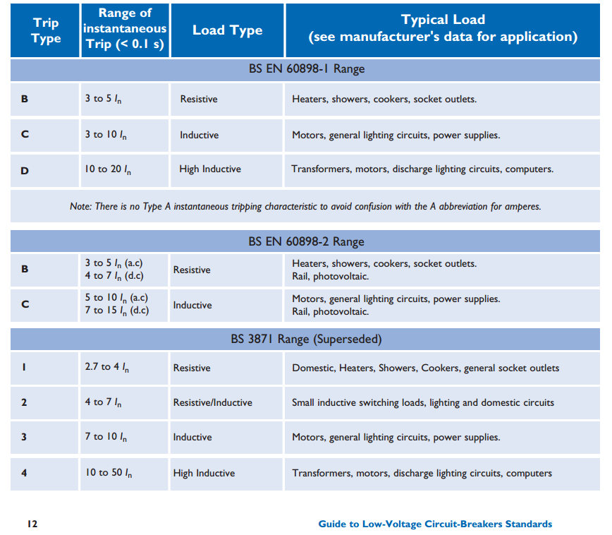

Wylex NB type 2 40 amp breaker

These are hard to find, does the proteus 640/2 40 amp fit as a replacement ?
Or any other suitable ?
There was an old style proteus that was physically sized same as old wylex, but been so long i dont recall numbers
I have sourced a Whlex NB 40 Type 1 mine is a Type 2. Will this be suitable . Need urgent answer as these go faster than hot cakes.
'In' is the rating of the breaker, 40A in this case.
No.
As you will see from the table, type 1 (type B nowadays) is normally used for showers.
Is it just a normal electric shower with no pump in it?
