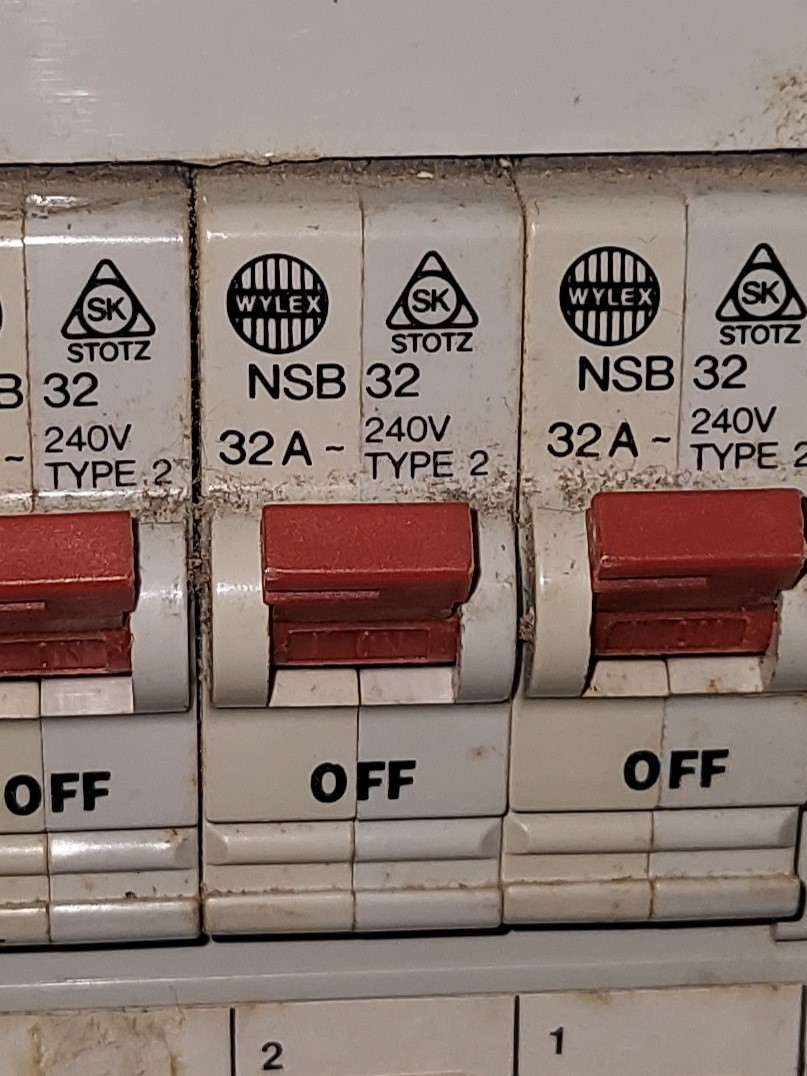

Change Circut breaker
27 Feb 2021
7
The circuit breaker from tool station is for a completely different type of fuse box to yours and is completely unsuitable.
You need to search for Wylex NSB 32A
Wylex is the manufacturer. NSB is the range. 32A is the rating.
Apparently it fails the EICR , shower was 9.5 kw my wire not big enougth need to downgrage to 7.5kw - 8.5kw and lower the fuse to 32 amp
It is likely any new shower will stipulate RCD protection, so changing the shower will likely not help, it will still fail the EICR. By changing the shower and MCB your changing the design, plus work in a bathroom, so new installation certificate, maybe minor works, but since design is altered I would say installation certificate and also either a completion certificate or a compliance certificate, which in real terms means too expensive to DIY you need a scheme member to do the work, who will likely want to change the consumer unit as well.
