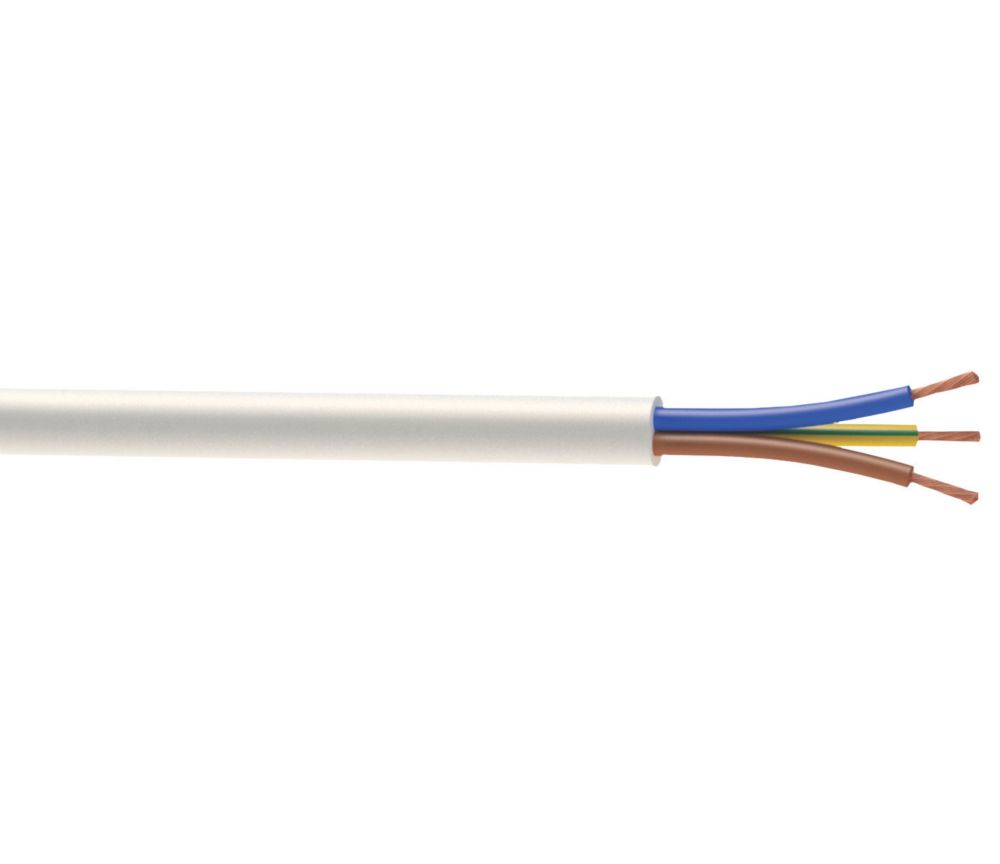

Hi all. A BBQ site states they have a 32 amp socket available. There are CCE to standard domestic 3 pin plug outlet adapters available for 16 amp to 13 amp conversions - will these work for 32 amps as I can’t find any that specify 32 amp. Looking to use a domestic kettle to boil some water for a cuppa.

32A plugs and sockets are physically bigger than 16A ones. It can be hard to tell the difference from pictures or even looking from a distance but the difference is pretty obvious when you are up close and personal with them.
Easy enough to make one, grab a 32A plug, some 2.5mm²flex and a 13A trailing socket and wire them together. Screwfix sell everything you need.
To provide overload protection, the trailing socket should be either a single socket, or should be one with an integrated fuse.
