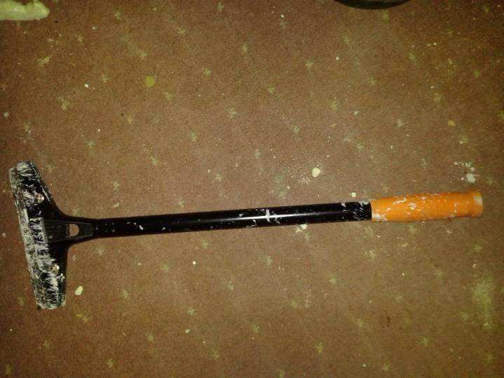

I bought the X TEX from Toolstation - about £23. You will also need a sharp scraper - I bought the one from Tool station but it was rubbish so I bought the one from Screwfix which was really good (see photo).
You will also need protective glasses, a proper dust mask, a large paint brush, rubbish bags and lots of sheeting.

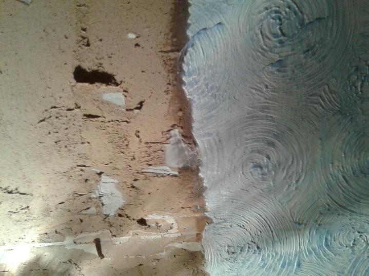

The photos show one half already done and one half with X TEX on it read to be done - you can see how I have damaged the old plasterboard by scraping in to it.
Overall my view is that it says what it does on the tin - it is expensive - it is messy - it can be hard work physically (esp if doing multiple rooms or scraping it all off) - it has saved me time in getting professional abestos removers in.
Even if you scrape it off methodically you might find it difficult to get clean edges.
