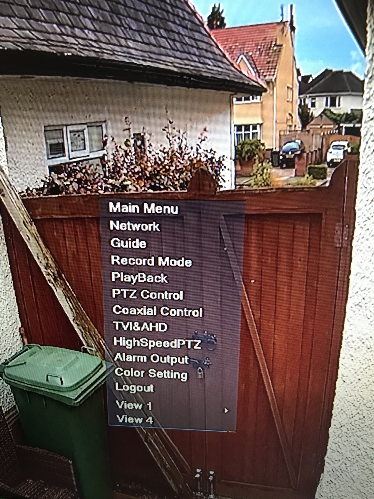

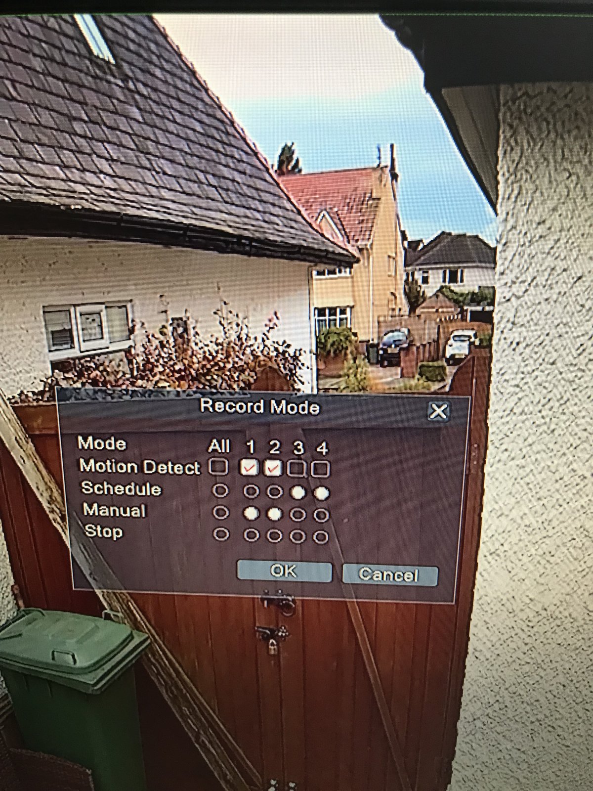

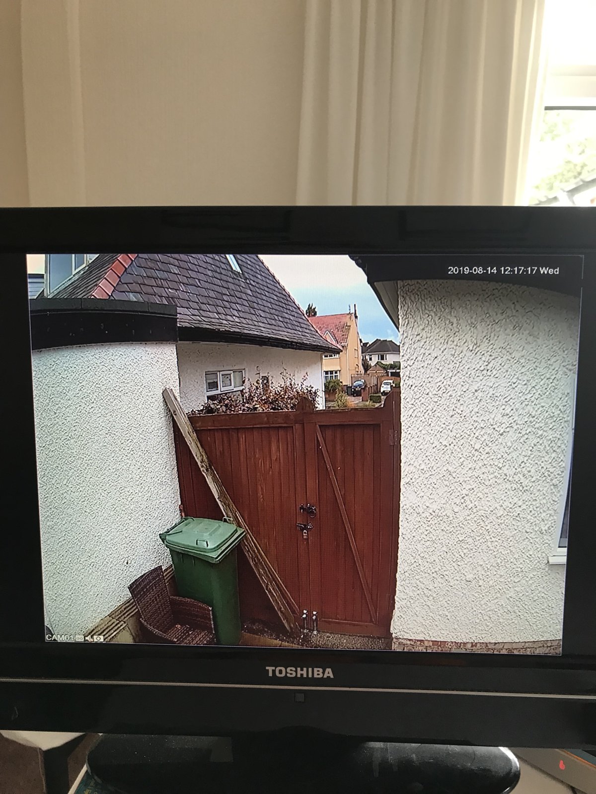

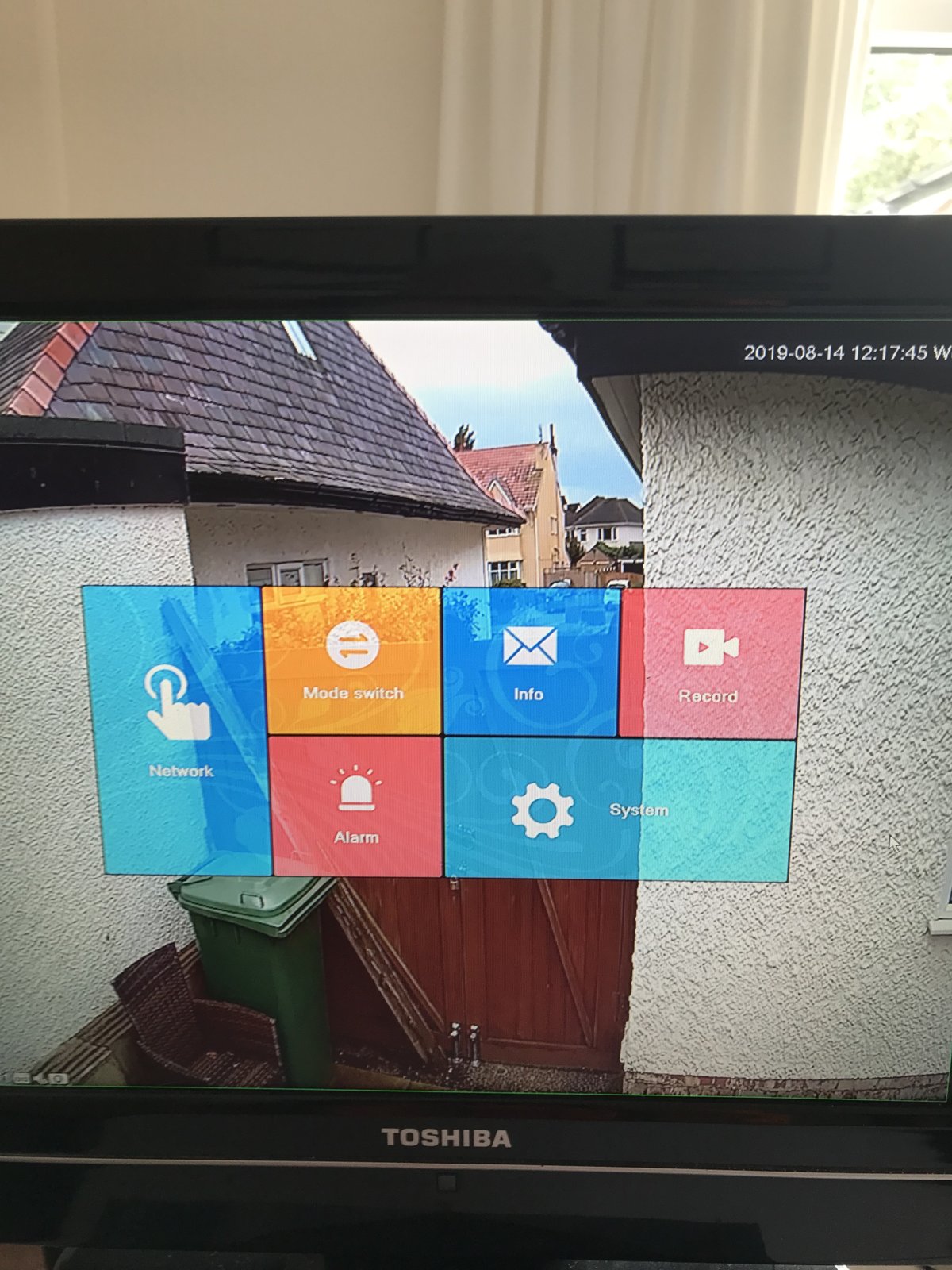

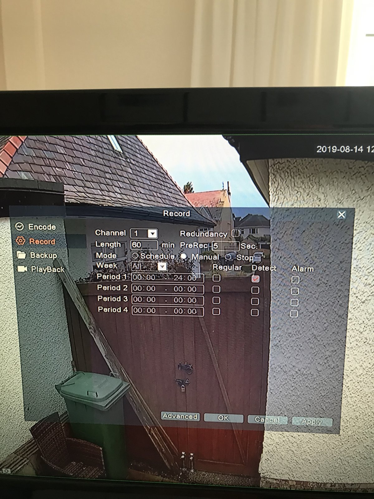

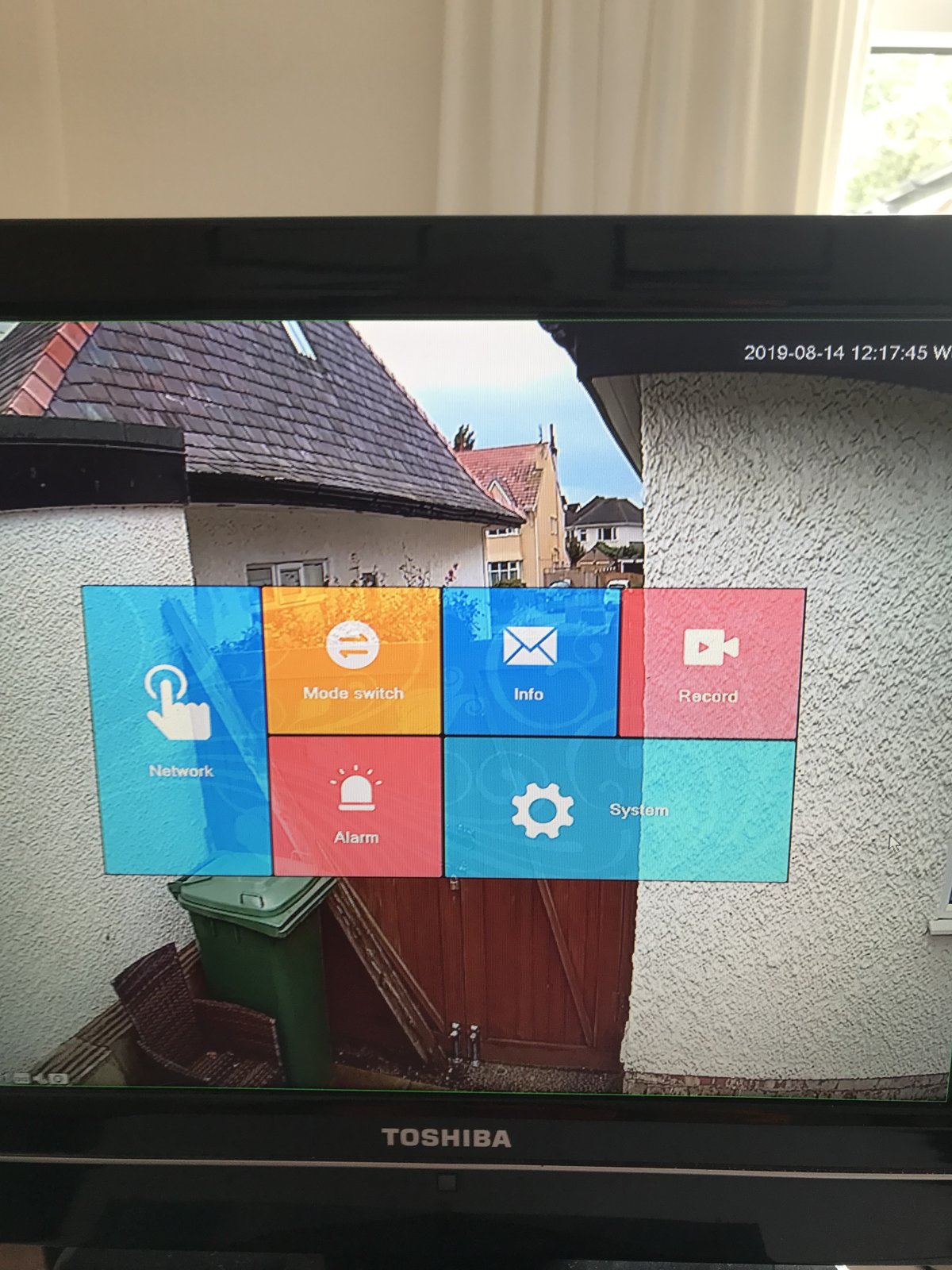

Hi, Thicky here again, thanks for assistance so far, but I am still struggling to get this thing to do what I want, which is to record based on motion detected. I am getting constant recording.
I have taken the liberty of uploading some pix to try and indicate what I have done (wrong?).
Explanatory of pix as follows:
1. The view from Cam 1
2. Right click brings up this menu.
3. On selecting 'Record Mode'
4. On selecting 'Main Menu'
5. 'Record' from Main Menu'

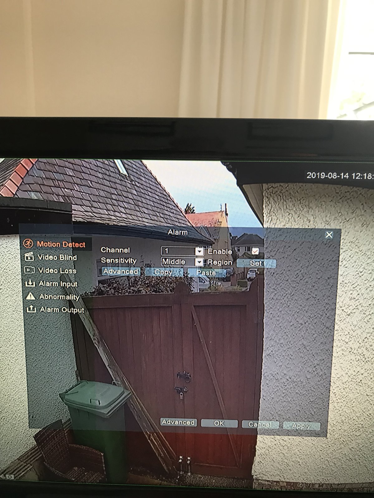

6. 'Alarm' from Main Menu

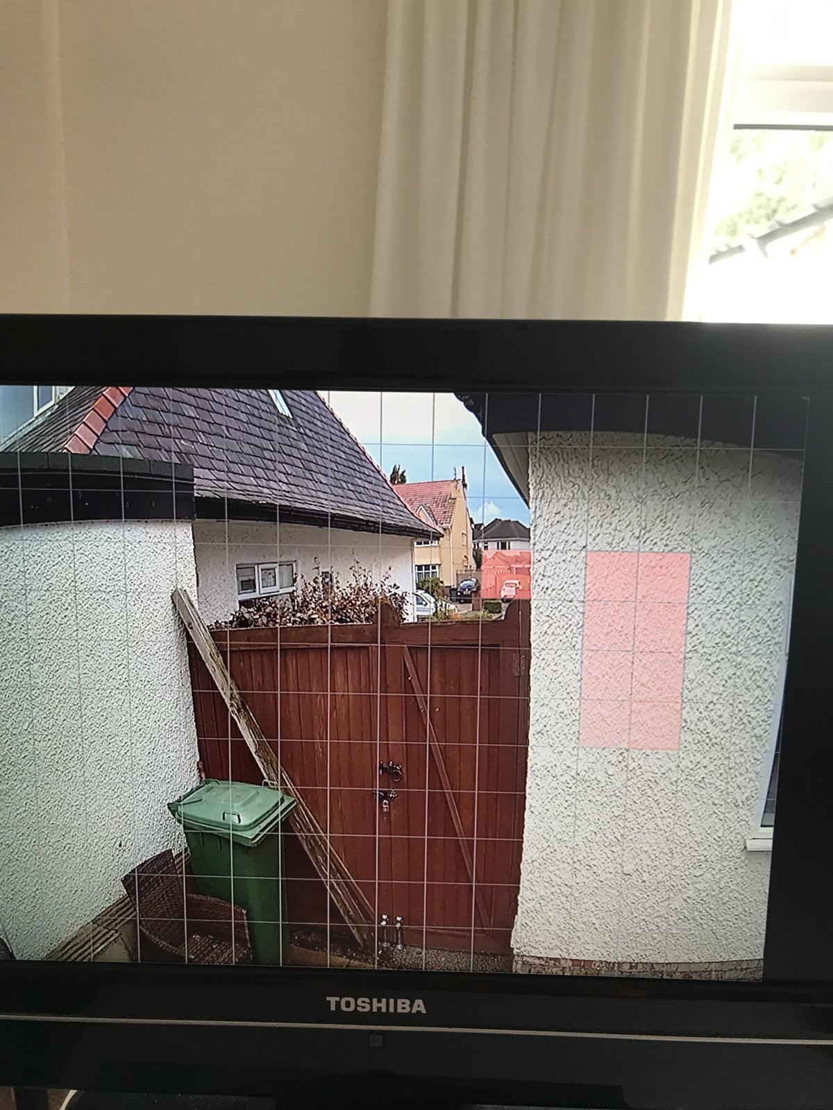

7. Within the 'Alarm' section there is a 'Region' selection which brings up the view in a matrix fashion allowing squares to be selected or deselected (clear or 'pinked'). But I am not sure if the 'motion selected' squares are the pinks or the clear. Or is it to stop squares from 'motion detecting' because of constant movement from trees etc.
Sorry for length and complexity of this post but I suspect an expert would look at the pix and see instantly what I am doing wrong.
At the moment I am recording permanently so the disk overwrites but I have just a solid line for my replay progress with no indication of where actual activity existed.
Again, thanks for reading and assistance.
SjH
Anyone help with the setting up of Motion Detect based on my attached menu pix? A while ago I manged to see my recorded time progress line with different colours to denote detected motion and no detected motion but I don't seem to be able to get back to that configuration.

I have now managed to get the motion detect recording! My timeline is grey with motion detect events in orange. BUT....it only seems to detect and record motion at night. At night I have many triggers, largely from moths, but as soon as daylight hits I get no recorded motion events at all.
I will have a play with 'sensitivity' but any guidance on setting correct sensitivity would be a help? I assume this will be a trial and error activity?
Thanks for reading.
Is there an option to set the motion area maybe you have not done that which is why nothing picks up during the day?
Hi lamchamps.
Thanks for that - I have realised that there is a lot of trial and error on setting this up and I think I have found a happy medium based on detection area and sensitivity. I am now recording motion both day and night. I just have to get the sensitivity right because rain and moths appear to be creating a regular frequent trigger at night.
