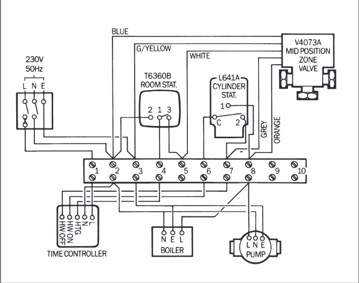

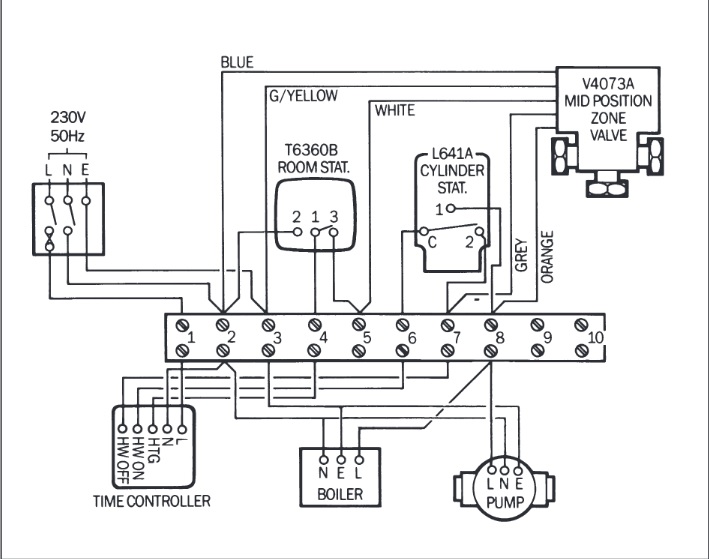

Y-plan with Potterton Suprima boiler problem.
30 Mar 2012
34
Wiltshire
The boiler was taking some time to come on after a call for heat and then a few weeks ago I came home to a really hot house as the heating had been running all day! Boiling radiators and hot water in the tank.
The room stat was satisfied so it should not have been running at all (the water is only on 2 hours a day, one in the morning and one in the evening). Tuening off call for heat from CH and HW at the controller did not stop it running. I had to power off everything.
A heating engineer came out and said it was a control board problem. Then board has since been replaced and whilst the boiler now starts quickly when a call for heat comes in, it went into full on mode again yesterday. The DV was in mid position.
Could this be a problem with the diverter valve microswitches?
Maybe the latching relay in the room stat sometimes sticking?
What else can it be? The overheat and thermister in the boiler all tested OK when the engineer was here.
Thanks for any hints or help on getting to the cause of this!

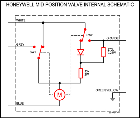

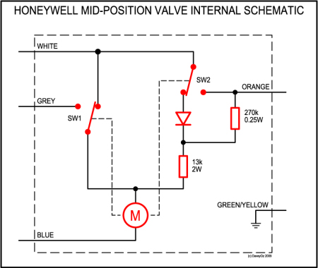

The valve is complex John Ward does a really good video.
mid-position-valve.jpg Mid position means the white is energised and grey is not, so if grey not energised then the tank thermostat must be calling for heat, so it is possible a back feed from the orange is holding valve open, so I would be looking at the tank thermostat if it was mine.
However only ever worked on one Y Plan so could be wrong.
PS have you checked to see if the bleeding lever on motorised valve has not been left latched on?
