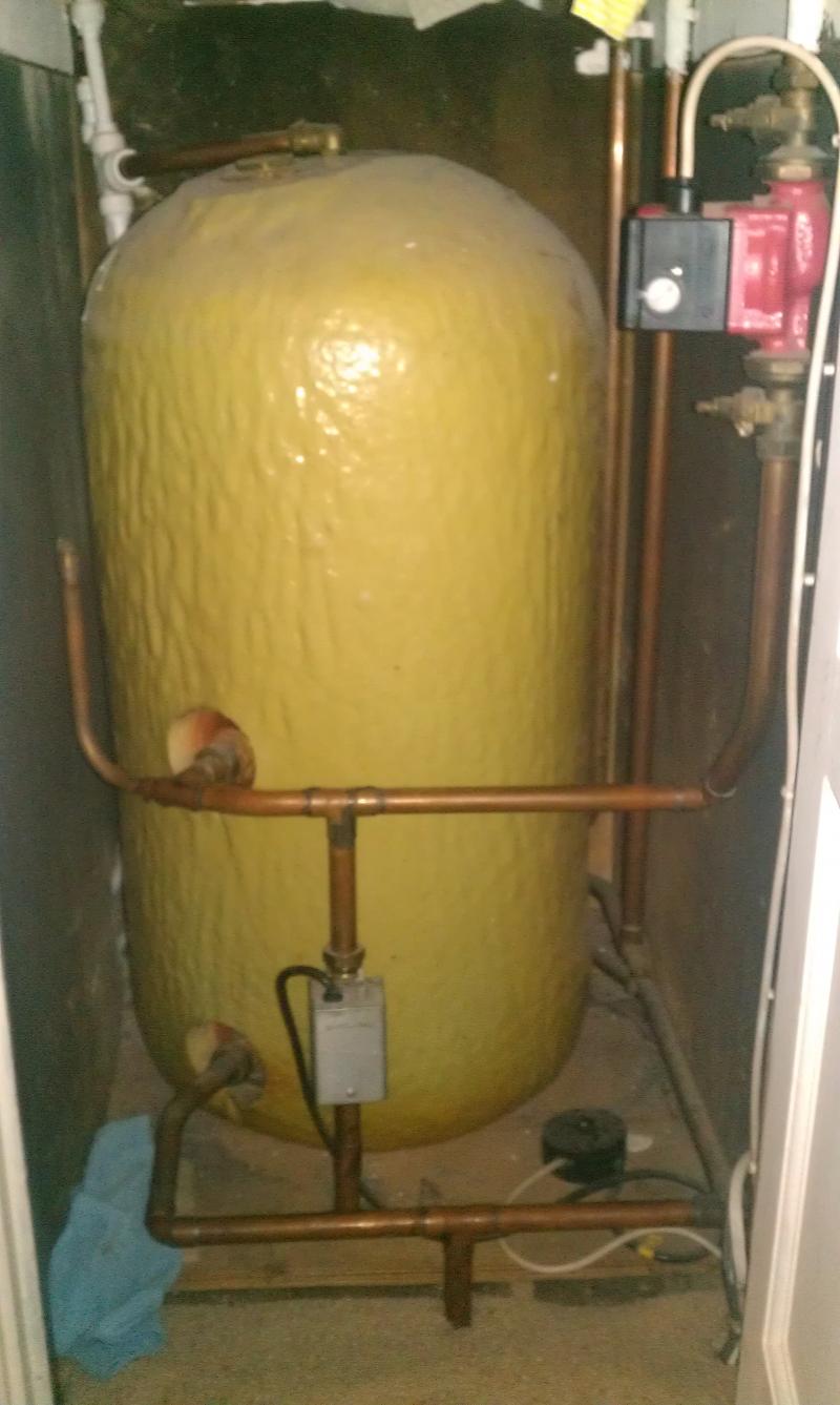

If there is no cylinder stat, your system is probably very old and rather inefficient. There might be a Cyltrol or a Tapstat attached to the return pipe from the cylinder to the boiler, post photos please. If so it is probably very old and may have seized.
Hi, sorry for the late reply.
Definitely no cylinder stat and no Cyltrol or a Tapstat
What is the best way to test for loop leak? block off F&E tank and drain off some from CH system and see if cold water storage tank fills?
drain or bale out whichever is lower, ties up the ball float, observe if it refills..
With no cylinder stat you are tipping money down the drain. Photograph the pipes around the cylinder, and pump, and boiler and any motorised valve you can find.
Nothing to show around the boiler only a drain off valve,
but here is my airing cupboard.
If a cylinder stat is fitted and say the tank water is at 60' but the central heating need more heat, how does the boiler know to kick in?
in fact, how does the boiler decided to kick in at all?
the grey metal box is a motorised 2-port valve it (should) turn off heat from the boiler to the cylinder when there is no HW demand. In your case, with no apparent Cylinder stat, I don't know how it works (if at all). It may be that your system has poor controls, which will waste energy (money)

A three-port valve is rather more common, it sends heat to the cylinder, or the radiators, or both, depending on demand from the cylinder stat and the room stat.
http://www.screwfix.com/search?search=3+port+valve
Those hot pipes should be insulated.
the hot water is stupidly hot
due to lack of a cylinder stat, I expect.
