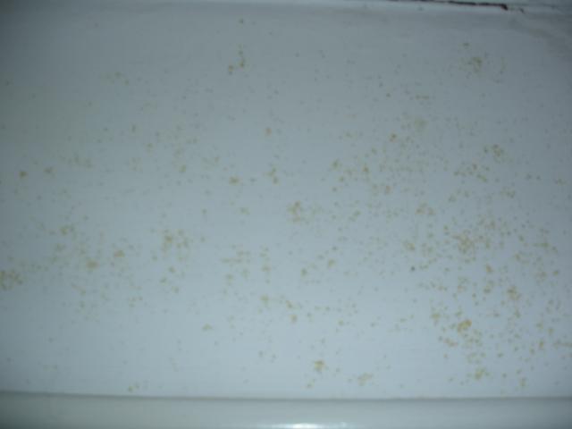

Hi, I have noticed some yellowy spots at the top of a spare bedroom wall. They have spread to about 2 feet wide but don't seem to be spreading anymore. I am assuming they are mould or damp (gulp!) but really don't know. I also tried to cover up some with paint but no success. Can anyone tell me what they probably are and how I can get rid of them? Sorry - I always seem to have a problem! Thanks.

Yellow mould really isn't that common, whereas black spots are......see if using a bleach solution removes the marks (or vinegar is supposed to work too - presumably the colourless type!) Is the wall painted or papered?
Although there might not be any dampness in this wall, if the room is poorly ventilated or particularly cold at that spot then condensation will surely occur.
So, see if you can shift these marks and then see if they return.....you can get barrier paints that will cover stubborn marks such as nicotine if the patches won't cover.

Hi John, What would I do without you! I will give the bleach solution or vinegar a go. You don't sound too worried so that is very reassuring. It is lining paper that is painted and as you know it is an old house. Thanks for your help.
Hmmm there's every chance that this stuff has been around longer than you think....!
See if the stuff comes off yellow onto a cloth and keep an eye out for it to return seems like a good move just now.
Is the affected wall (or patch) an outside wall, and does there seem to be any reason for external dampness? I don't know if your house has a cavity wall or not...
If you think that the wall could be damp, you can get really cheap dampness detectors - two probes stick gently into the wall, and if there is dampness around the detector starts to make noise. Gentle clicks for next to nothing, through to a squeal if its wringing wet!

yellow spots can be damp, especially noticable if the wall was painted white. I have this at the top of my kitchen wall where a bathroom sink above overflowed and soluble dirt washed out of the wall or the ceiling. The stain stays after it has dried out. There is no mould because the wall was dry again in less than a day, and is dry now. Is there a bathroom above? Or leaky radiator pipes or roof?
However, if this is a room that suffers from condensation, it could be a fungal attack and you need to trace and rectify the cause. Do you get visible condensation on the wall or window? At this time of year you shouldn't. Bleach solution kills mould but does not cure damp.
Photos would help a lot.
Thanks for all the advice. It is an outside wall and I suppose there might be guttering problems but it is so difficult to see as you can't really get round that side to see. Here is a photo ( really embarrassing!)

If you think your wall is damp, Drapers 52058 for around a tenner will tell you for sure, but personally I think its just more ventilation thats needed.

Good morning! I have tried the easiest suggested remedy first and sprayed a white vinegar solution over the yellow spots. Immediately the spots faded dramatically when I wiped it off. Magic! :D
You can still see them a little but you have to look hard and I think when it has dried I may be able to paint over them. So it was as easy as that! Hopefully it won't come back but if it does I will have to get to the source of the problem with the damp measure.
