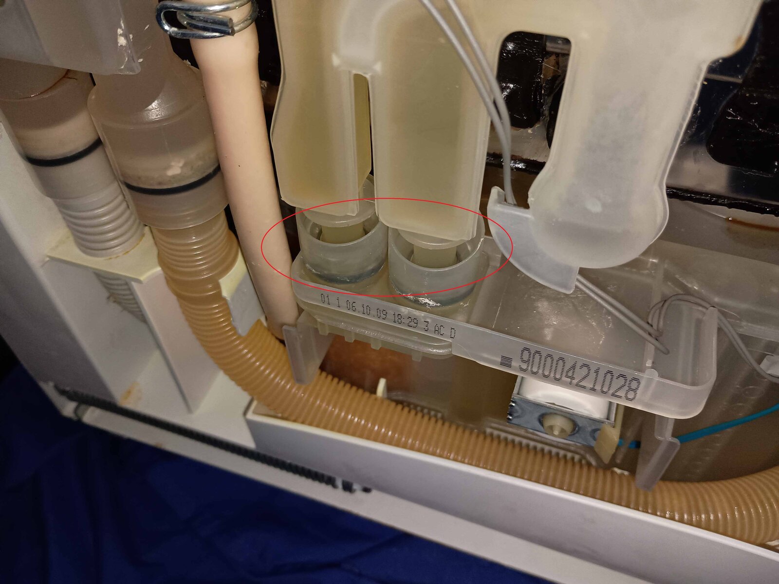

Yet another E15 error on our Siemens Dishwasher SN65M030GB/16
29 Jan 2011
360
53
Yorkshire
Well, our Siemens dishwater has just sprung another leak to add to all the previous ones we've had.
I was tempted to finally scrap it. However, this latest one doesn't look as expensive as the previous ones, as it is leaking water out of the seals between the water inlet/matrix/manifold thingy, and the water softener. I've done the O ring seals on the two hoses to the left in the past as they were the source of an earlier leak.

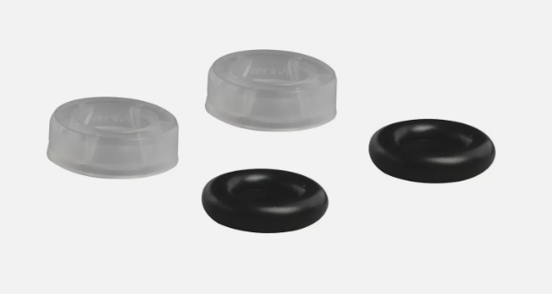

It's possible to get a seal kit part 00611913 (photo also below) for the water softener, so I'm going to order one.
Just posting up in case it helps anyone else with these older Siemens/Bosch dishwashers.
It’s worth trying it for that relatively low cost
