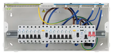

Your opinion on the safety and legality of this board please.
and if the prong had missed the clamp, where else could it be going?
With some designs of "cage clap" terminal, it is possible for the wire/pin to end up under the cage rather than inside it. Some designs of cage clamp have a guard to stop this from happening, but not all.
With a wire you will notice this immediately, the wire will simply fall out or at least pull out under even a gentle pull test, but with a busbar pin it can easily go unnoticed.
That's what I said, in prose, in post #18
Yes you did, but then wrote:
It's impossible to be certain of anything from that photo, but it looks as if the busbar prong is in light with the blue neutral cable
Which I took to mean you now thought the busbar was in the neutral terminal
- and if the prong had missed the clamp, where else could it be going?
In reply to Chivers post which I quoted, I aired my concerns the 2 MCBs on the right might not be clamped onto the busbar if it had gone in behind the clamp.
IE:
and pushed the MCBs forwards.
It's impossible to be certain of anything from that photo, but it looks as if the busbar prong is in line with the blue neutral cable - and if the prong had missed the clamp, where else could it be going?
No, I still believed that it was going into the '2' terminal (and the blue cable into the N one) but that the busbar lug going into the '2' terminal appeared to be (as best as one can tell from the photo) 'in line with' the blue going into the N terminal - suggesting that the lug of the busbar probably had not 'missed thee clamp'.
Kind Regards, John

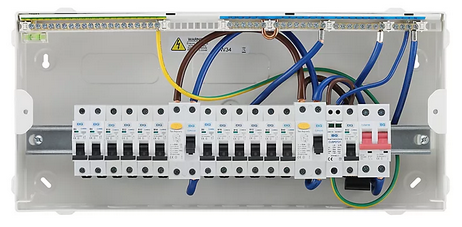

I did look for BG consumer unit as could not quite work out how wired and found this
it seems to show no brown tails below the MCB's I note @SUNRAY picture but can't see why there would be a brown cable near the RCD, and @Lol999 did say some one got a shock requiring a hospital visit, and although the CU is not wired well, with joined bus bars, and MCB's not level so points to what @SUNRAY shows in his picture, can't see how that would result in a shock, maybe a fire, but not a shock.

With some designs of "cage clap" terminal, it is possible for the wire/pin to end up under the cage rather than inside it. Some designs of cage clamp have a guard to stop this from happening, but not all. .... With a wire you will notice this immediately, the wire will simply fall out or at least pull out under even a gentle pull test, but with a busbar pin it can easily go unnoticed.
Yes, I realise all that but perhaps I was not clear enough, since my intended point really was that there was nothing in the (very photograph (which has very confusing perspective), per se, which would lead us to suspect that, in this case, the lug was not in the 'cage' (if it is a 'cage'-type terminal - and that, for what it'sworth, it at least seemed to be in-line with the adjacent cable termination.
I did look for BG consumer unit as could not quite work out how wired and found this View attachment 333613it seems to show no brown tails below the MCB's I note @SUNRAY picture but can't see why there would be a brown cable near the RCD, and @Lol999 did say some one got a shock requiring a hospital visit, and although the CU is not wired well, with joined bus bars, and MCB's not level so points to what @SUNRAY shows in his picture, can't see how that would result in a shock, maybe a fire, but not a shock.
My shetch shows a clamp holding a copper busbar (brown) against a brass tab (orange) on the right but missing the clamp on left.

What you need is a decent EICR , done properly and thoroughly.
Then you’ll have a far better idea than random guesses off the internet
It's all going to the HSE, let them deal with it.
Let’s hope the HSE act quickly or the employer could fix any issues, assuming there are any
As for the bus bar cover - that’s not an issue as you should always turn off the board before removing the cover
I would guess it's a dual-rcd board with no surge protection or non-rcd ways such that the main switch is immediately to the right of the right hand RCD.
I feel that's exactly what is there, the brown load side wire and the live/line grey tail are both visible.
