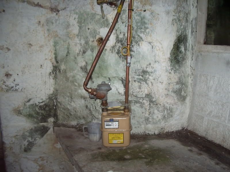

Hi guys I wondered if any of you have a picture of a gas main without a earth bond and a picture of a gas main with an earth bond you care to share ?

Bonded
Not Bonded
The second one definatly isn't at my house

you sure that second meter is not bonded?
it may be bonded inside the house.. if it's directly on the other side of that wall then it's within 600mm of the meter..
would this not also be defined as where it enters the equipotential zone???
