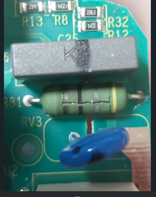

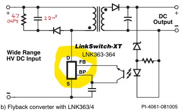

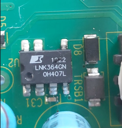

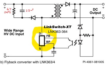

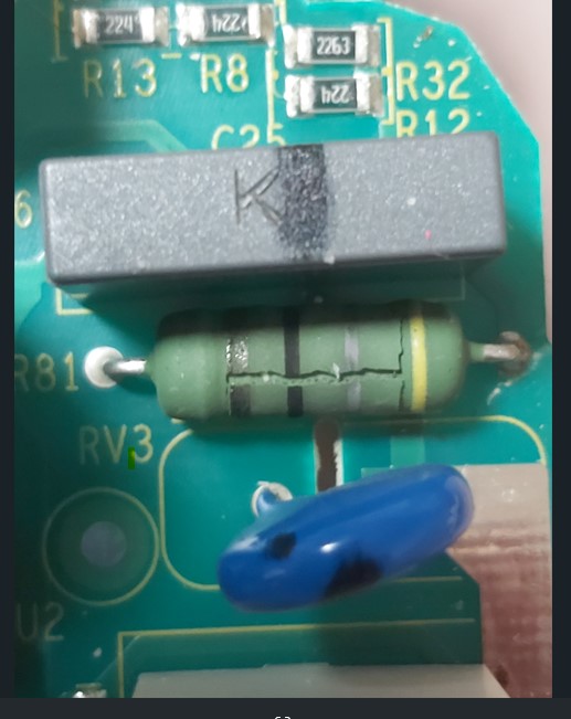

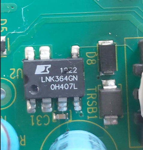

Hi, I know it's been 5 years since you had the problem. Mine did exactly the same with no lights. There is a PCB in the main control panel with switch mode PSU. In my case it was a IC that failed and took a resistor with it. The IC is commonly used in washing machines, dish washers and so on. It's LNK364GN and when it fails, it shorts drain and source causing the direct short pos to neg on the 48Ohms (10%) resistor. I have replaced the IC, resistor fitted was 47Ohm 5W 1% and the 22nF capacitor that was affected too. Hope this will help others with similar failures as I have just saved £450 on a new dishwasher. Parts cost was around £10 and my time to fault-find and repair... Best regards all (except sircerebus666)
