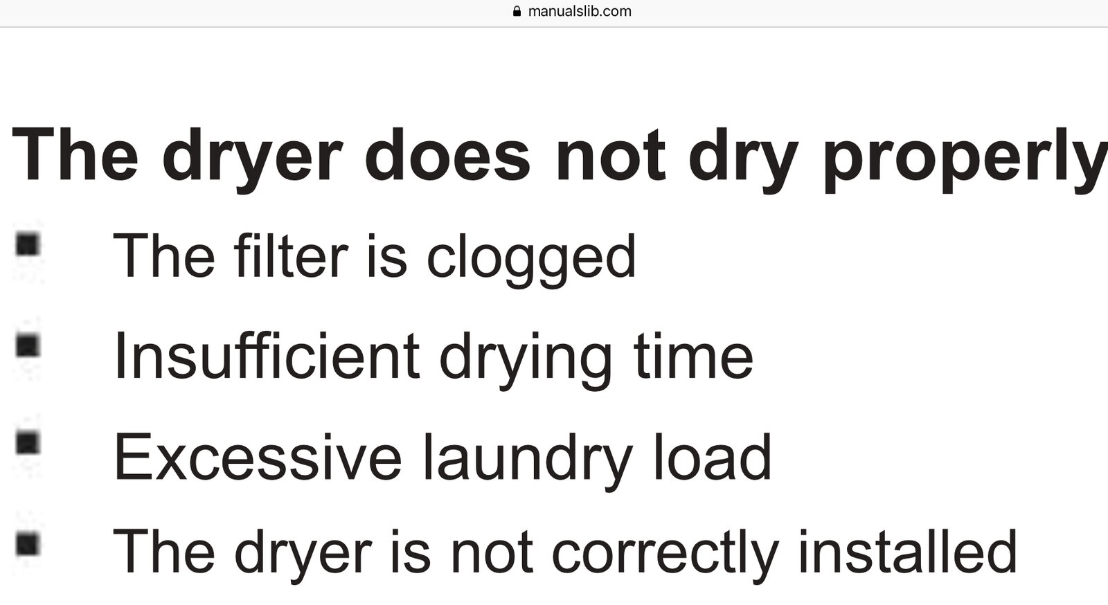

Taken from the manual, Have you checked the filter?

Will check the Filter but where is the thermostat located??
Item 3A is the stat, looks like it is at the back near the pulley you were greasing
